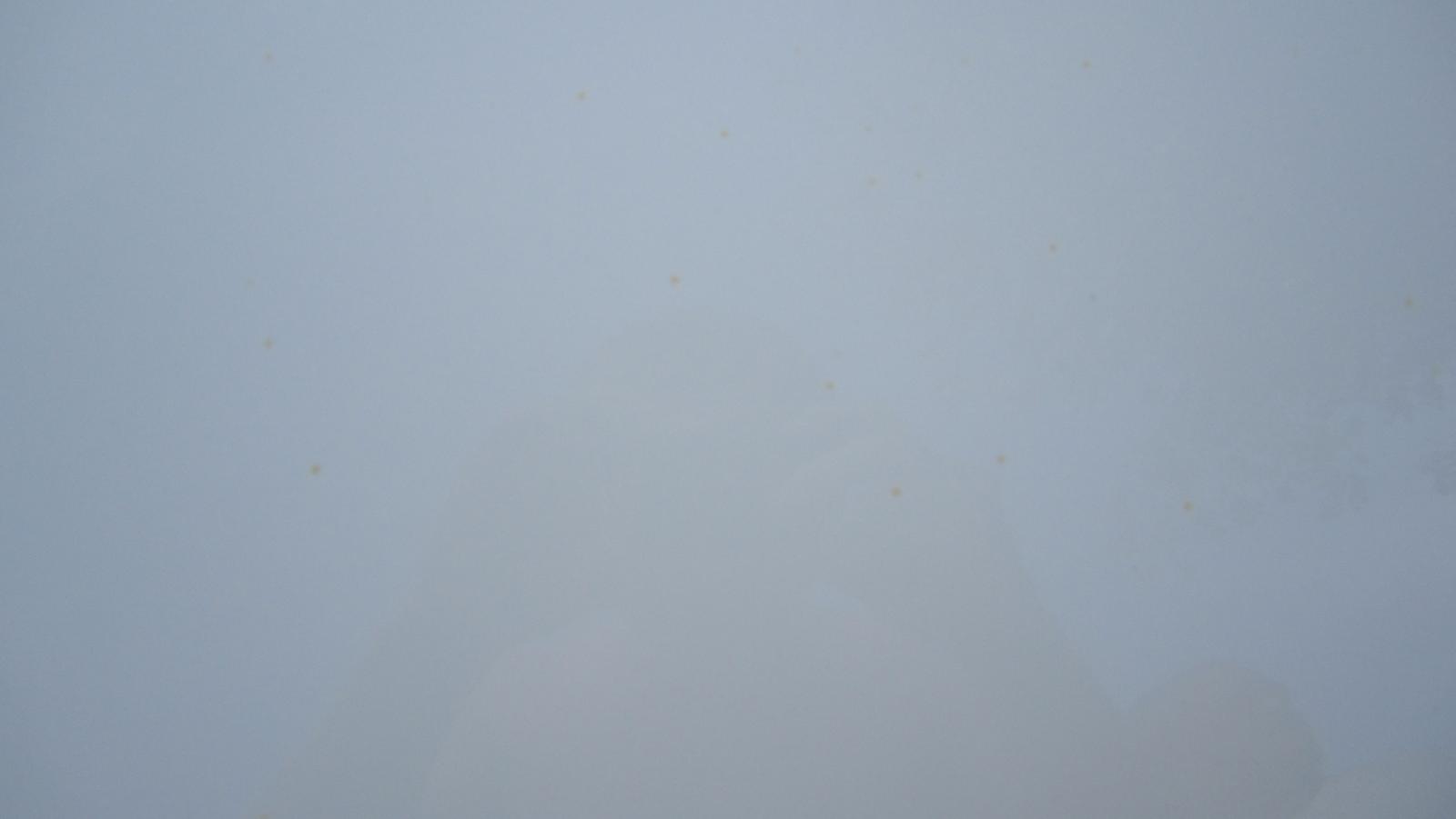

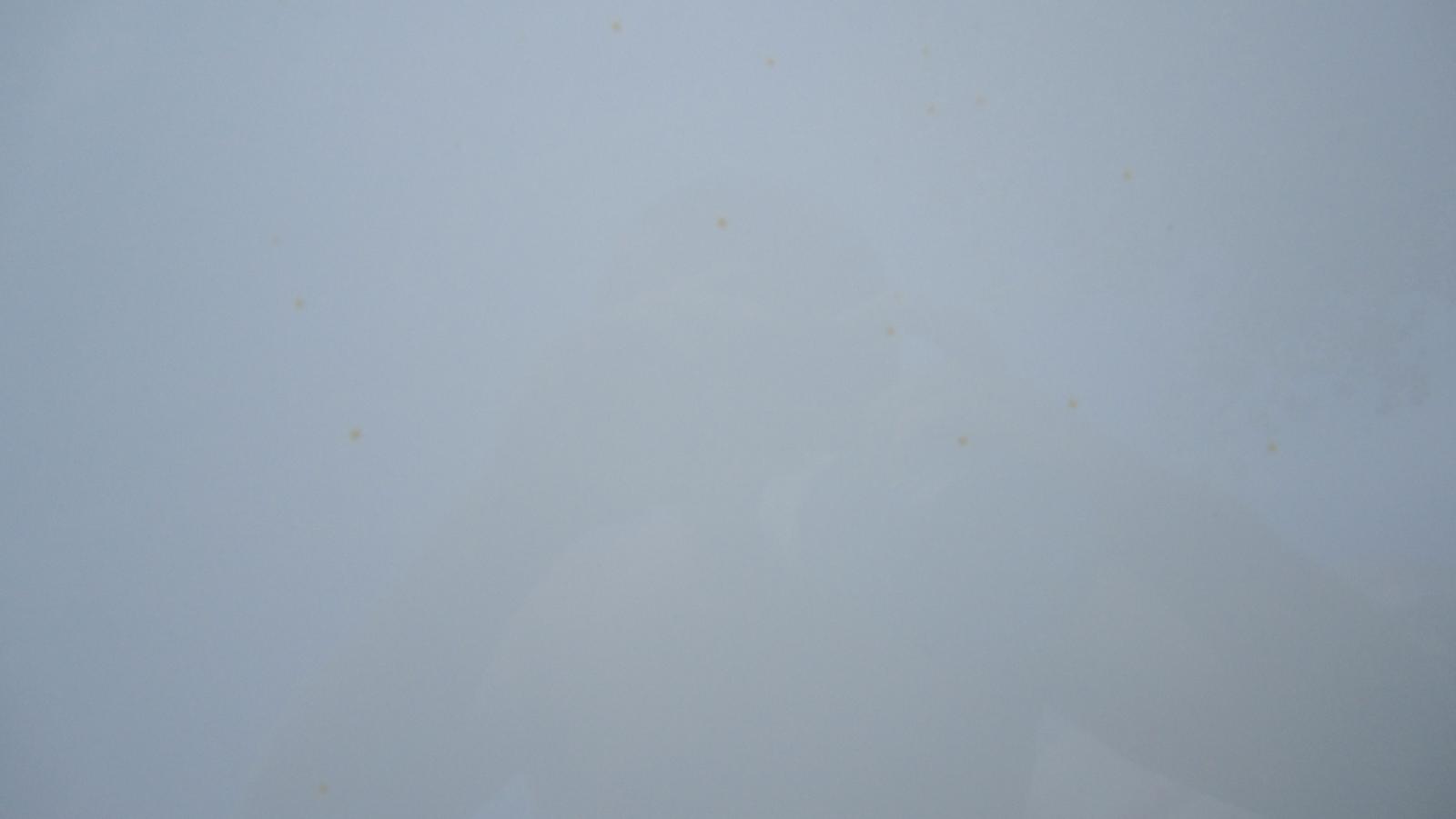

Jprice90 Posted August 30, 2011 Report Posted August 30, 2011 i have no idea what the hell they are, kinda hard to see from these pics, but it's the best i could get from my camera, i just washed my car today and noticed them, they wont come offf..i can feel them a little bit when i run my finger over them, anybody know what i could try to use to get them off? Quote
Jprice90 Posted August 30, 2011 Author Report Posted August 30, 2011 you must have the same problem lol.forgot you have the same color heres what i JUST found: "I do believe what you are talking about is called fallout. Its like acid rain and shows nicely on white cars. I just use a clay bar and it comes out with some rubbing. It gets worse in the winter from all the snow ." so i'll try that out, thank you Quote

ThirdgenTa Posted August 30, 2011 Report Posted August 30, 2011 Yeah it's either that or rail dust/dust from people's brakes. We were just talking about this the other day. A clay bar will take it off, takes a little elbow grease from what I've seen. There is supposed to be this spray that'll take it off much easier than clay...but can't find the thread on the other forum. I'll have to ask around! Yes, it's called Iron X. Here are some pics of some cars I have detailed using this product. You spray it on, let it dwell for about 5 minutes and wipe it off. You can go the clay bar route, but it may take a while. This product turns purple when it reacts with the iron http://img.photobucket.com/albums/v110/ThirdenTa/Detailing/177.jpg Quote

Jprice90 Posted August 31, 2011 Author Report Posted August 31, 2011 the clay didnt work, neither did the goo gone i sprayed on a tiny spot at work, i might have to go with IronX, where could i pick it up, Autozone? etc. Quote
urbex Posted September 1, 2011 Report Posted September 1, 2011 Hmmm...it's probably on there pretty good. Did you try a buffer? Quote

ThirdgenTa Posted September 1, 2011 Report Posted September 1, 2011 the clay didnt work, neither did the goo gone i sprayed on a tiny spot at work, i might have to go with IronX, where could i pick it up, Autozone? etc. I buy mine from www.autogeek.net or you can pick it up on ebay or amazon. It's for professional detailers so it's not available in stores. It's perfectly safe for clearcoats and clearcoated wheels. Just don't get it on chrome. Oh yeah, I will warn you it stinks to high hell. They recommend gloves and a mask I would not use a buffer. Why remove a layer of clearcoat when you don't have to? Quote
