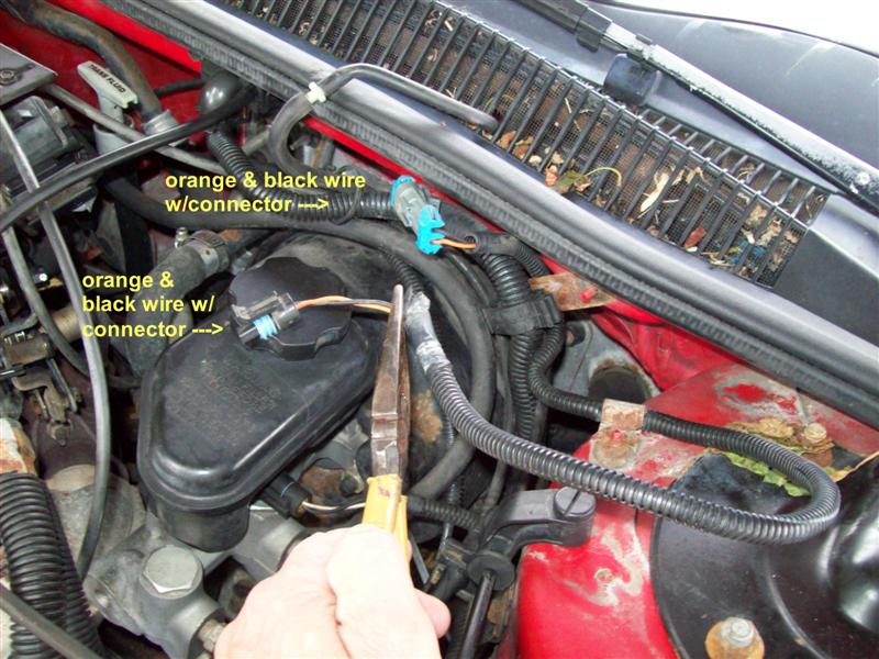

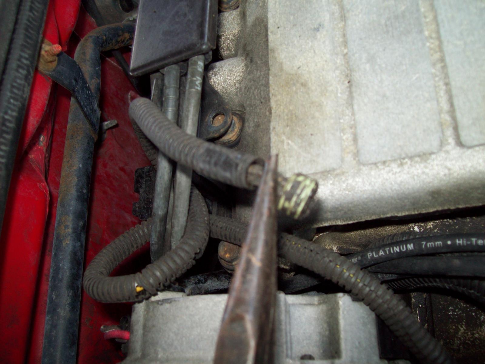

90V6RedHotLuminaEuro Posted August 27, 2011 Report Posted August 27, 2011 1990 Chevrolet Lumina Euro Coupe V6 3.1 I have 3 Connectors under my hood, not connected to anything, that I would like to identify. There are no devices nearby to connect them to or associate them with... or maybe I'm not seeing something. 2 connectors on the passenger side have Yellow and Brown wires attached. 1 pair I found up by the alternator with a broken connector. 1 pair was found down near, and laying on top of the AC compressor. The next pair of wires, Orange & Black with connector, I found on the drivers side near the master cylinder. Professional assistance will be greatly appreciated. Thanks, John B. Quote
tornado_735 Posted August 27, 2011 Report Posted August 27, 2011 One looks like hood light, one maybe looks a magnasteer connector, and the other I'm not sure about. Quote
90V6RedHotLuminaEuro Posted August 28, 2011 Author Report Posted August 28, 2011 One looks like hood light, one maybe looks a magnasteer connector, and the other I'm not sure about. Right! ...the hood light... it's right there above it... sheesh! ...I'm pretty sure this car never had a Magnasteer... It had at least 3 previous owners. The guy I got it from said the engine was swapped out long ago. Maybe the engine and harness on my engine came from a car that had Magnasteer. I have the Haynes manual and schematics but they haven't been much help with this one. I'll browse through it again now that you gave me a lead. It may not be a necessary wire... but I just want to make sure things are going where they need to be going, and if the wires are unnecessary... then I'd like to just clip them short and cap them off. Quote
tornado_735 Posted August 28, 2011 Report Posted August 28, 2011 Right! ...the hood light... it's right there above it... sheesh! ...I'm pretty sure this car never had a Magnasteer... It had at least 3 previous owners. The guy I got it from said the engine was swapped out long ago. Maybe the engine and harness on my engine came from a car that had Magnasteer. I have the Haynes manual and schematics but they haven't been much help with this one. I'll browse through it again now that you gave me a lead. It may not be a necessary wire... but I just want to make sure things are going where they need to be going, and if the wires are unnecessary... then I'd like to just clip them short and cap them off. No, your car was likely just prewired for magnasteer, even if it didn't have it. My base-ass 1996 Grand Prix Sedan had the wire for magnasteer as well. As for the hood light, you're not the first person to wonder where that plug went Quote

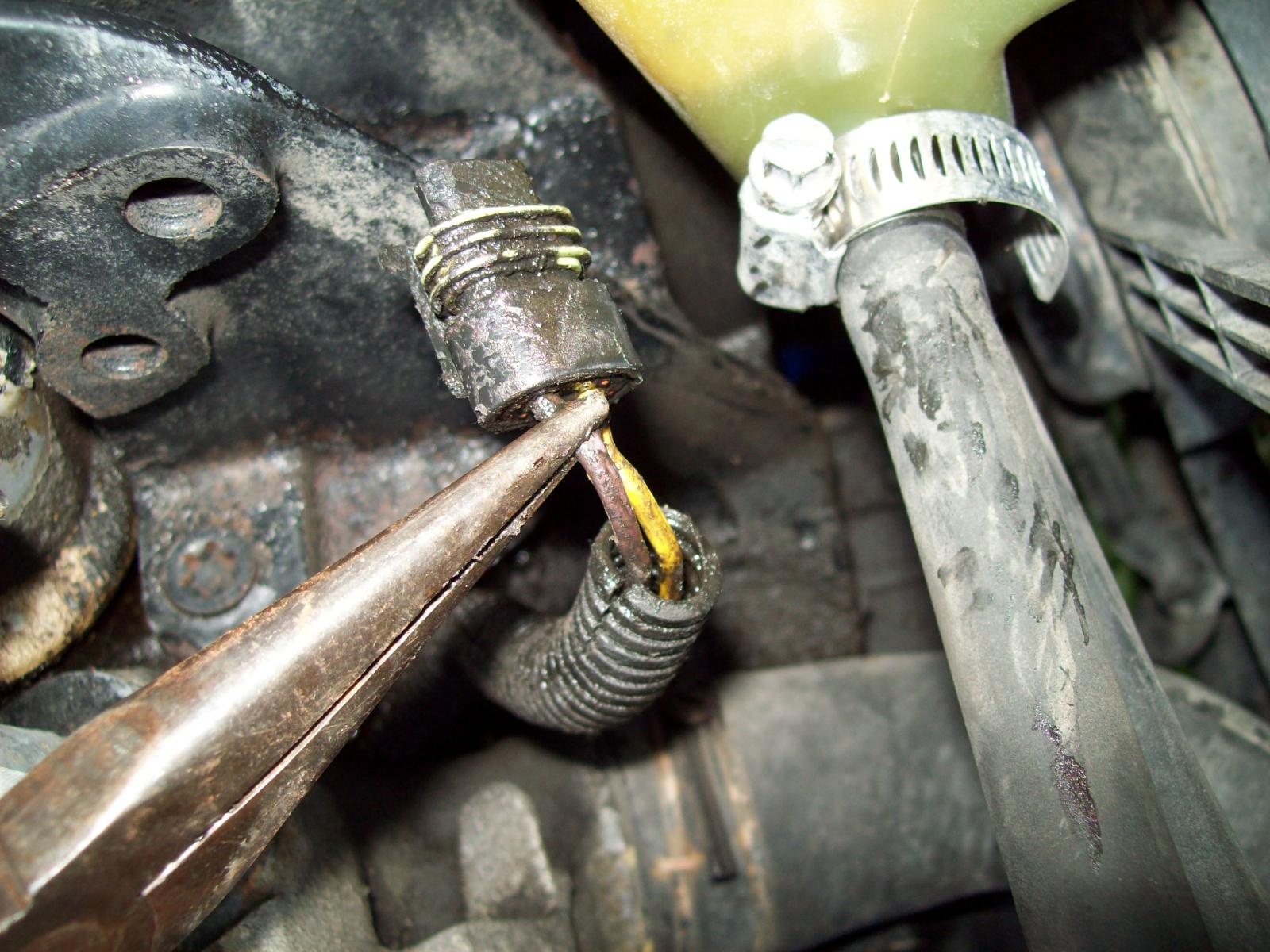

90V6RedHotLuminaEuro Posted September 2, 2011 Author Report Posted September 2, 2011 Follow Up & Correction: I was working on the car yesterday, replacing the power steering pump and water pump... and straightening out the wiring which had been crushed under the power steering pump reservoir... I peeled back the harness on that Yellow and Brown wire... low and behold... it's really a Yellow and PURPLE wire... I still don't know what it is/was for. Ps. things are looking better under the hood... and sounding/running better... I did a Lucas Fuel Treatment, Valvoline Hi-Mi Oil Change, Slick 50 Advanced, Fram TG (anti-drainback) Filter, new dog bones... have a question about the motor mount I think I'll post separately... solid or hydraulic which is preferred and why... new rear struts... front struts enroute from ebay... rear struts were I think the original 21 year olds... full of water... more... Quote
Artemis Posted September 2, 2011 Report Posted September 2, 2011 The second wire which is purple and yellow looks like it belongs to the oil level sensor. Quote
