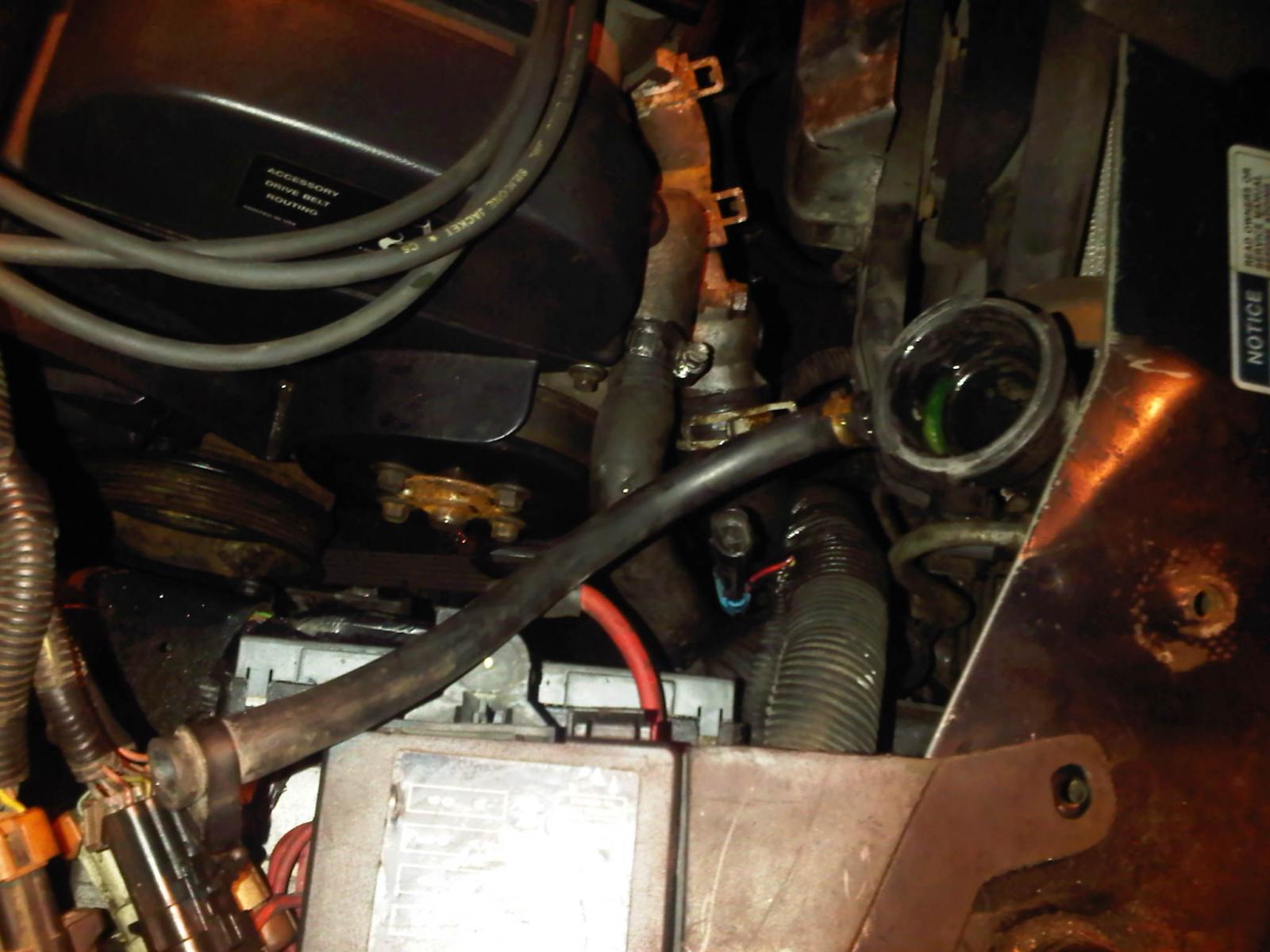

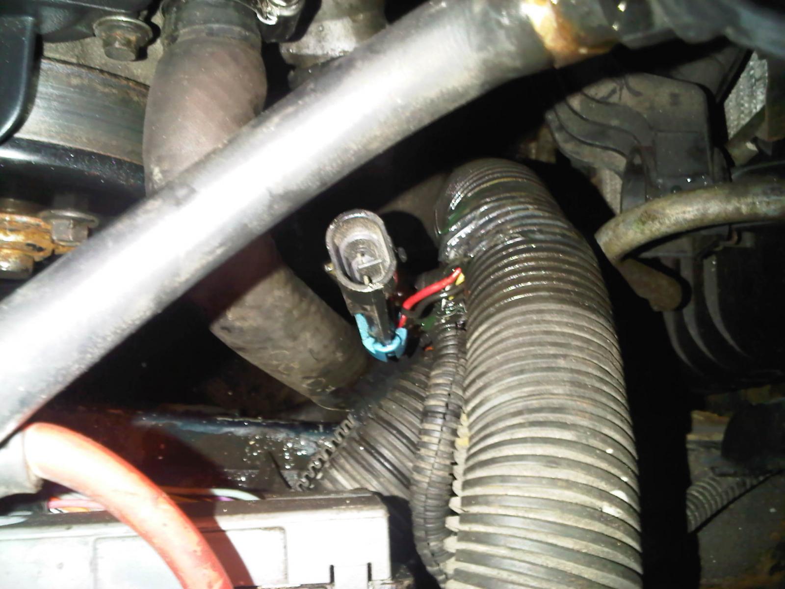

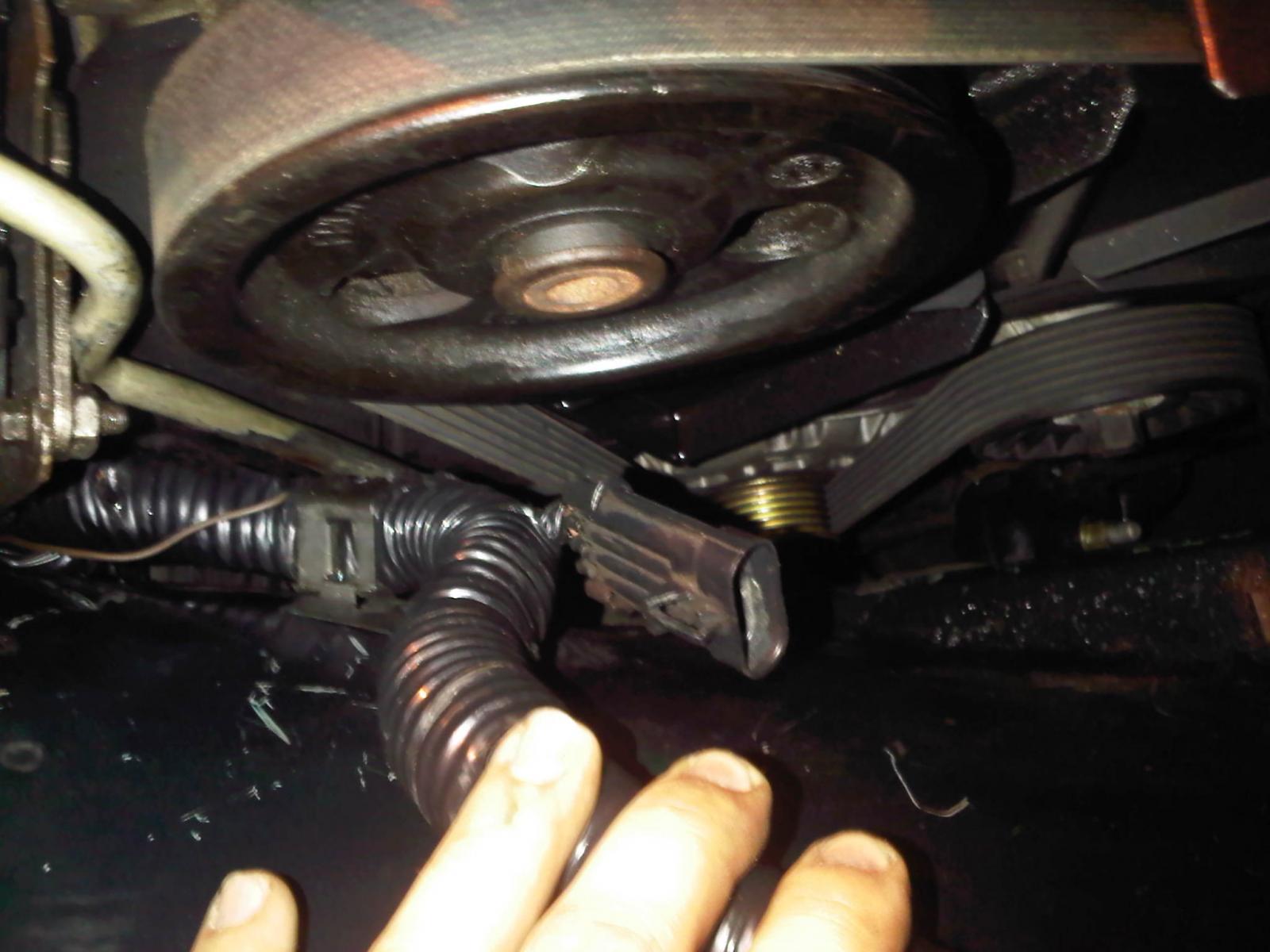

Artemis Posted August 26, 2011 Author Report Posted August 26, 2011 On another note, I have unplugged harnesses that I have no idea what to do with. This one, below the rad cap. Second view of one under rad cap. Just below power steering, coming off the main line going to C100. Quote
AL Posted August 27, 2011 Report Posted August 27, 2011 The one below the radiator is the low coolant sensor, it plugs in right on the radiator under the cap, youll see it if you look closer... And the one next to the power steering Im not sure about Quote

Artemis Posted August 29, 2011 Author Report Posted August 29, 2011 96 LQ1 Has a MAP and MAF. I'll take a pic when I get a chance. We replaced the ECT, even though it was brand new. Now we're getting 24F as ECT from the scanner. Its at least not completely toast, but not sure why the reading is off. The harness under the rad is not the coolant level, thats a male plug and its already plugged in. Not sure what to make of it really. After we were getting the 24F engine was still flooding. Quote
