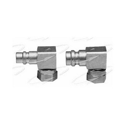

I also found this:
http://www.autozone.com/autozone/accessories/Santech-90-degree-R12-port-retrofit-hose-relocates-1-4-in-7-16-in?itemIdentifier=82522
The photo looks like it's a simple extension which would be female one end and male on the other, but specs say something different. It's rather pricey and would only be worthwhile if the accumulator is a bigger headache to replace than it looks.

that hose adapter thing looks like a slick idea, but considering that its proper protocol to replace it all I'd just relocate it to the accumulator, and its less crap getting in the way of the hot turbo housing.
