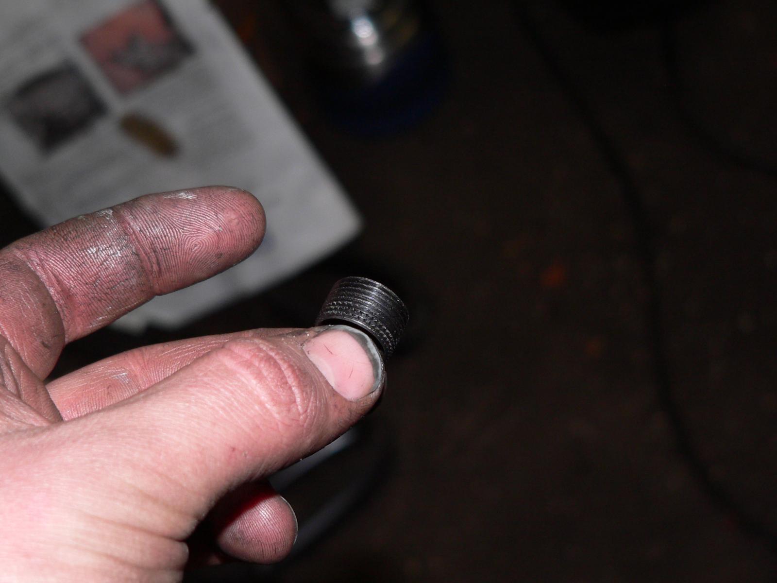

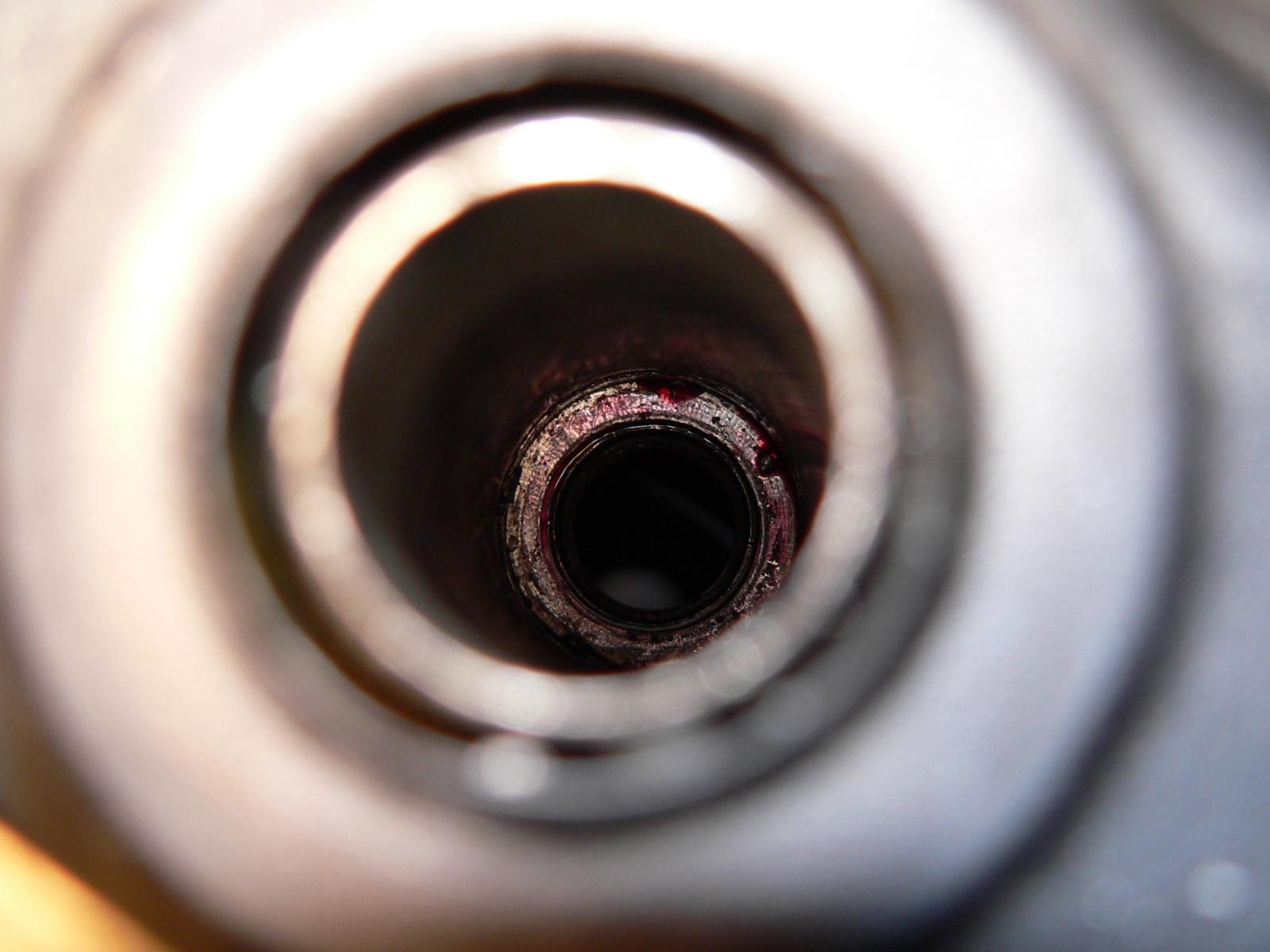

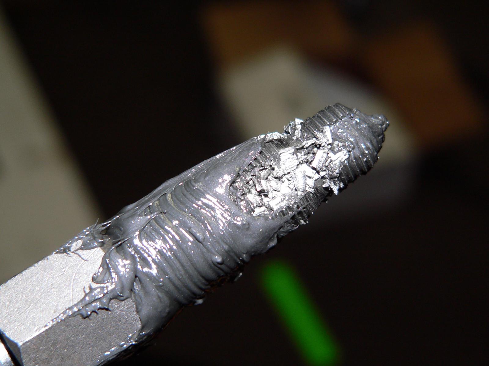

Myotis1134 Posted August 12, 2011 Report Posted August 12, 2011 (edited) Bloody aluminum heads. Unless you are super OCD about torquing your spark plugs just so, it's almost certain to happen eventually. I have heli-coiled the entire back side of my engine now, and the latest was with an oversized thread repair kit since the last blow-out was the heli-coil itself. It is possible to do yourself, just use lots of grease on the tap so shit doesn't fall into the cylinder, and don't rush for the same reason. You're lucky, if I'm reading my manual right, the # 1 plug is on the front of the engine? if so, unless you really trust a mechanic to be as fastidious about fixing your machine as you would be, doing it yourself, then a heli-coil kit doesn't cost too much, and you could have it fixed in a couple of hours. On the flipside, since I believe the heli-coil inserts are made out of steel, and you will be sticking it into an aluminum head, it will probably plague you again in the future. Differences in metal heat expansion and the like. p.s. Don't freak too bad about the noise it made. It's true that there could be more damage than just the threads, but most likely the threads just gave, and the engine sounds awful when it's missing a plug. Edited August 12, 2011 by Myotis1134 Quote
