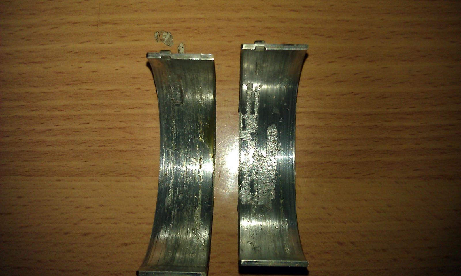

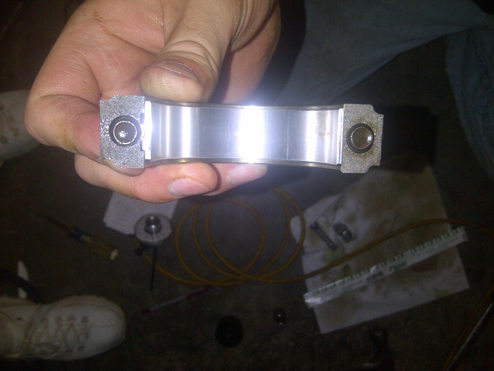

Chazzman17 Posted September 3, 2011 Author Report Posted September 3, 2011 Update, finally was able to get back to work on the car. Pulled #6 rod bearing cap. Wouldn't you know it, the last one was in fact the culprit! Spun rod bearing #6. The bearing itself is pretty scarred up, but thankfully the crank had no scoring that you could feel. You could tell that on the crank the bearing had spun, but it did not dig into it. I plastigauged it with a standard size bearing, and was still within specs. One thing I noticed on #5 and #6 bearing cap was some really bad factory machining. Instead of being nice and flat and smooth on the tops where there attach to the rod, they were rough and jagged. The bottom of the rod was the same way. They fit back together perfectly, like that had been broken apart instead of cut. But definately a major flaw in the manufacturing. Gonna throw it all back together, hope the best. If it still knocks, just gonna swap the motor. I attached two images, one of the top of the bearing cap, the other the inside of the bearing. Thanks again for all the help, this is a great forum. Quote

55trucker Posted September 7, 2011 Report Posted September 7, 2011 Curious. What was the cause for the spinning of the bearing in the 1st place? They usually do so because of lack of oil pressure which causes heat between the bearing & the journal. Quote
Chazzman17 Posted September 7, 2011 Author Report Posted September 7, 2011 I am not completely sure of the cause. The only thing I can maybe relate to the cause is the engine getting hot. I bought this car with several issues, hoping to fix it up. The radiator had a crack in it, and who knows how long the idiots who owned it before me drove it with the engine getting super hot. Thinning the oil out so much the journal just wasn't lubed properly. That's really all I can possibly relate it to. The previous owners did not take care of this car, whatsoever. From mechanically, to cleanliness. Definitely was/is a project car. But I look forward to getting her back to her full potential. Quote
