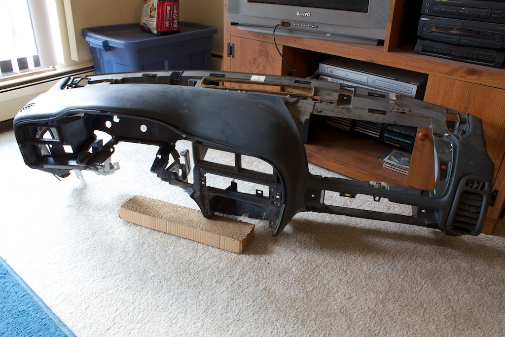

darkwolf45 Posted August 7, 2011 Author Report Posted August 7, 2011 Cool, I finally got a dash out of a junked car, and it wasn't particularly easy. In the end it was being held in by one tiny 9/32" bolt that I couldn't get loose. I got it home and have been rubbing armor all in it several times a day since yesterday afternoon. I'll probably try to get it in next weekend. That dash sure was dried out. I wiped it down twice with armor all and it still looked dry Quote

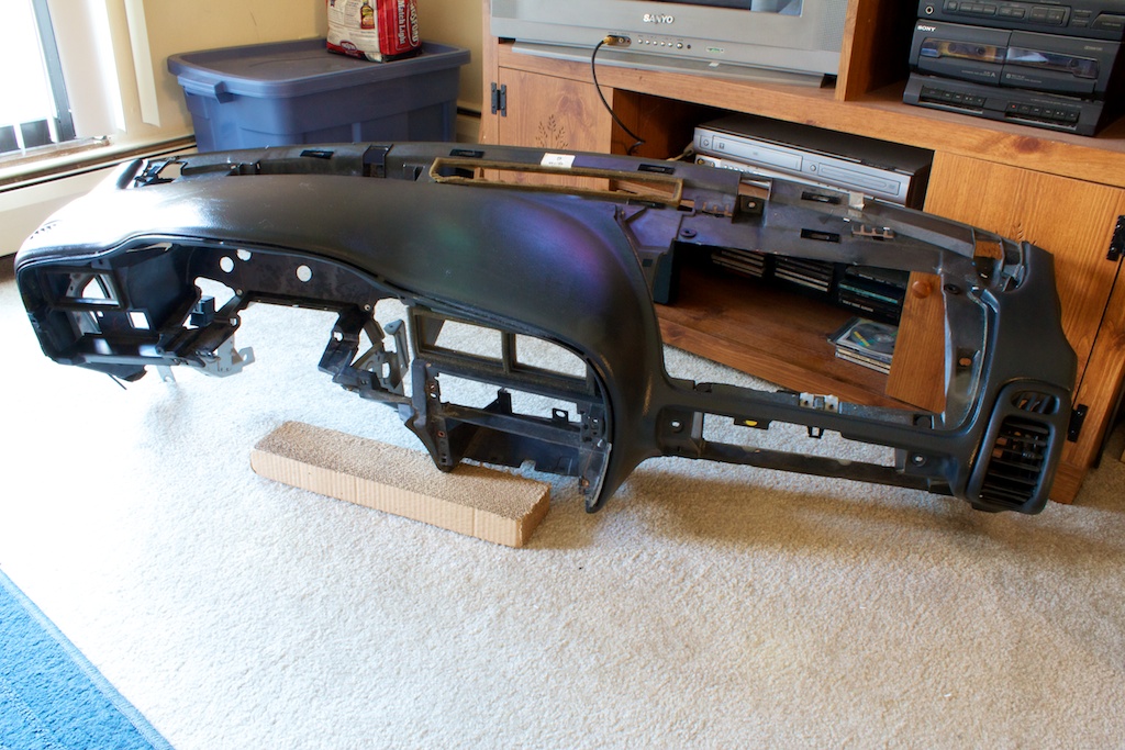

darkwolf45 Posted August 14, 2011 Author Report Posted August 14, 2011 Well, I will share what I learned: I had to go through a big job to figure out that it isn't that big of a job. There are four bolts on either side of the dash that connect ust inside the walls of the car. If you look at the picture, there are two bolts that go in on top, at the back, and a few small bolts on the bottom around the ash tray and the steering column. A 9/32" one to the right of the steering column gave me the most trouble. Once those were out, there were two plastic joints where the dash clipped in, and then the whole thing came right out, save for the wiring harnesses clipped onto it. The dash i got I soaked in as much armor all as I could for several days, but yesterday I decided to switch up to a Mcquire's conditioning/cleaning spray and the difference has been night and day. So now, I need to get the new one in, and after a week of cleaning and conditioning, I'm hoping it is ready. My real question is the airbag. Getting an airbag out of a junked cutlass with no power for weeks is one thing, but getting it out of my car... I'm a bit nervous. Quote

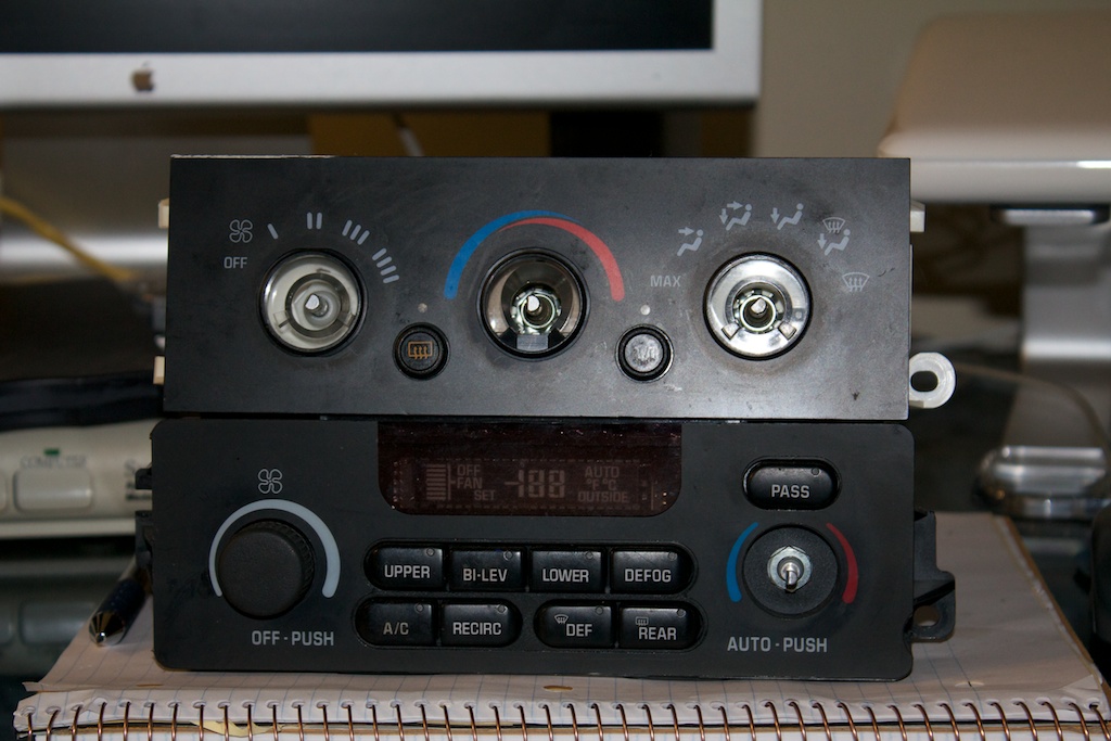

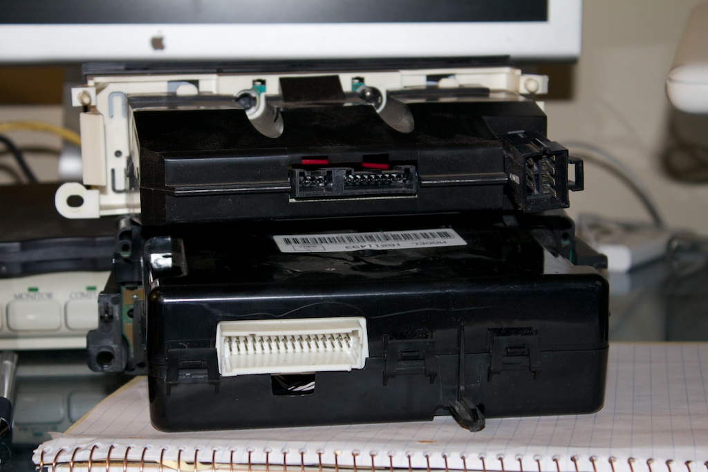

darkwolf45 Posted August 14, 2011 Author Report Posted August 14, 2011 Here they are. The top one is an example of what is currently installed, the bottom is the one I would like to install. Quote
darkwolf45 Posted August 14, 2011 Author Report Posted August 14, 2011 Hmmm... Interesting, since most of the '96 CSs I have seen have the same as the stock one in my '95. i would have thought the wiring would be there to change the units out. Quote
cutlassdude96 Posted August 14, 2011 Report Posted August 14, 2011 you would need the complete HVAC system to make the dual zone climate control to work Quote
darkwolf45 Posted August 14, 2011 Author Report Posted August 14, 2011 Oh well... it only cost me $12 anyways.. Quote
