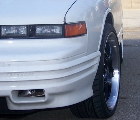

BXX Posted July 17, 2011 Report Posted July 17, 2011 19x8.5" 30mm offset IIRC.. Rim actually measures 9" wide. Quote
19Cutlass94 Posted July 17, 2011 Author Report Posted July 17, 2011 (edited) That looks good! See but what worries me is the extra 10mm difference. As the car sits right now, I only have 1/2" clearance between the BMR trailing arms, and my current 215/60's Well I think I got it figured out. Well just have to test fitment to see how everything works out! Edited July 17, 2011 by 19Cutlass94 Quote
BXX Posted July 18, 2011 Report Posted July 18, 2011 That looks good! See but what worries me is the extra 10mm difference. As the car sits right now, I only have 1/2" clearance between the BMR trailing arms, and my current 215/60's Well I think I got it figured out. Well just have to test fitment to see how everything works out! My rears are very close to the trailing arms indeed. However the rear needs spacers to longer lateral arms to widen the track width and even things up. The fronts stick out less that the xlaces, but not by much. My car needs an alignment, so with the wheels straight, the positive camber it has currently makes them appear to stick out, but it still looks great:thumbsup: Quote
