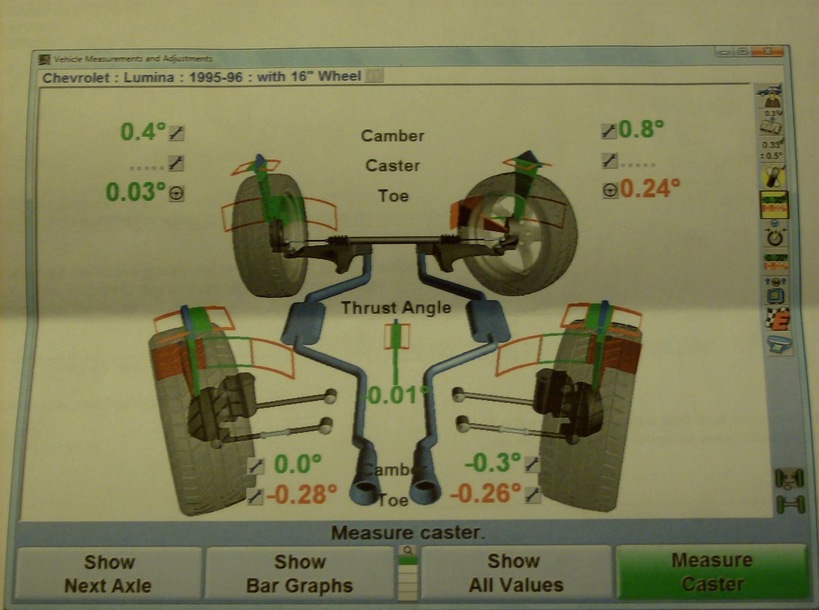

Jprice90 Posted July 31, 2011 Author Report Posted July 31, 2011 i wish i could show you the diagram of the alignment, actually im gonna try to get it on here to show everyone Quote
Jprice90 Posted July 31, 2011 Author Report Posted July 31, 2011 here ya go, hoepfully you guys can see the numbers Quote
AL Posted July 31, 2011 Report Posted July 31, 2011 God damn! .24! It was out! Is your steering wheel level now Quote
Jprice90 Posted July 31, 2011 Author Report Posted July 31, 2011 weird thing was, the wheel wasnt outta wack Quote
BXX Posted July 31, 2011 Report Posted July 31, 2011 weird thing was, the wheel wasnt outta wack If you paid enough attention, your wheel shoulda been off to the right while going down the road. But with the rear a mile out, the squirellyness prolly negated any effect that the front steer ahead had. So what was your caster angle? Or did you take that pic prior to them sweeping caster? Quote
Jprice90 Posted July 31, 2011 Author Report Posted July 31, 2011 i paid attention to the wheel lol, im pretty sure it was straight lol. and i just noticed the caster wasnt on there, says on the paper, Front Left Actual: 1.7 Before 1.7..Front Right Actual: 1.6 Before 1.6 Quote
