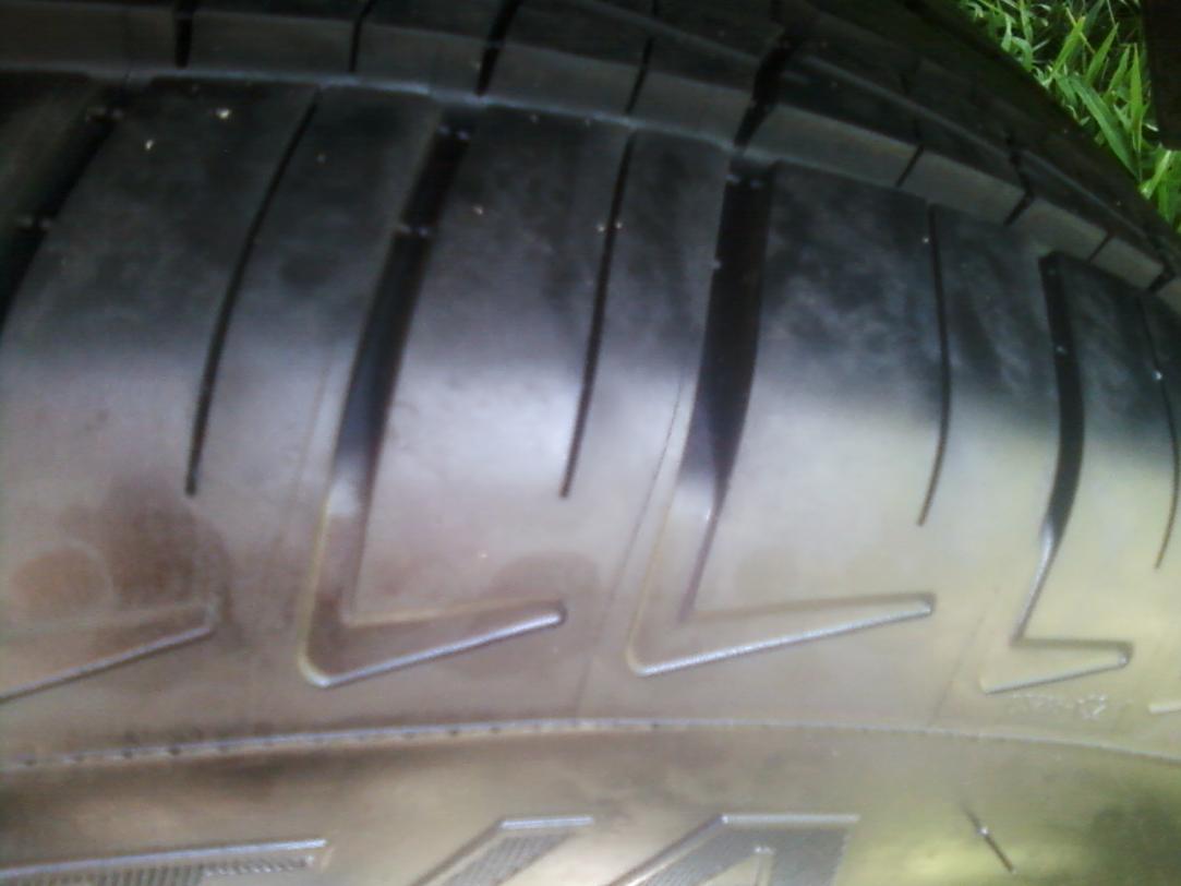

Jprice90 Posted July 23, 2011 Author Report Posted July 23, 2011 i just noticed on the left side, the "arrow" type things on the sidewalls are going towards the back of the car, and the right is going towards the front, should i get these fixed? or is it ok? Quote
jeremy Posted July 23, 2011 Report Posted July 23, 2011 does the sidewall of the tire have a specific rotation direction listed??? Quote
Jprice90 Posted July 23, 2011 Author Report Posted July 23, 2011 i dont believe so, i looked at em pretty good, didnt see anything..but to me it looks like the tires should be flipped around Quote
BXX Posted July 23, 2011 Report Posted July 23, 2011 Are those BFG Advantage T/A? If so, they are not directional. Quote

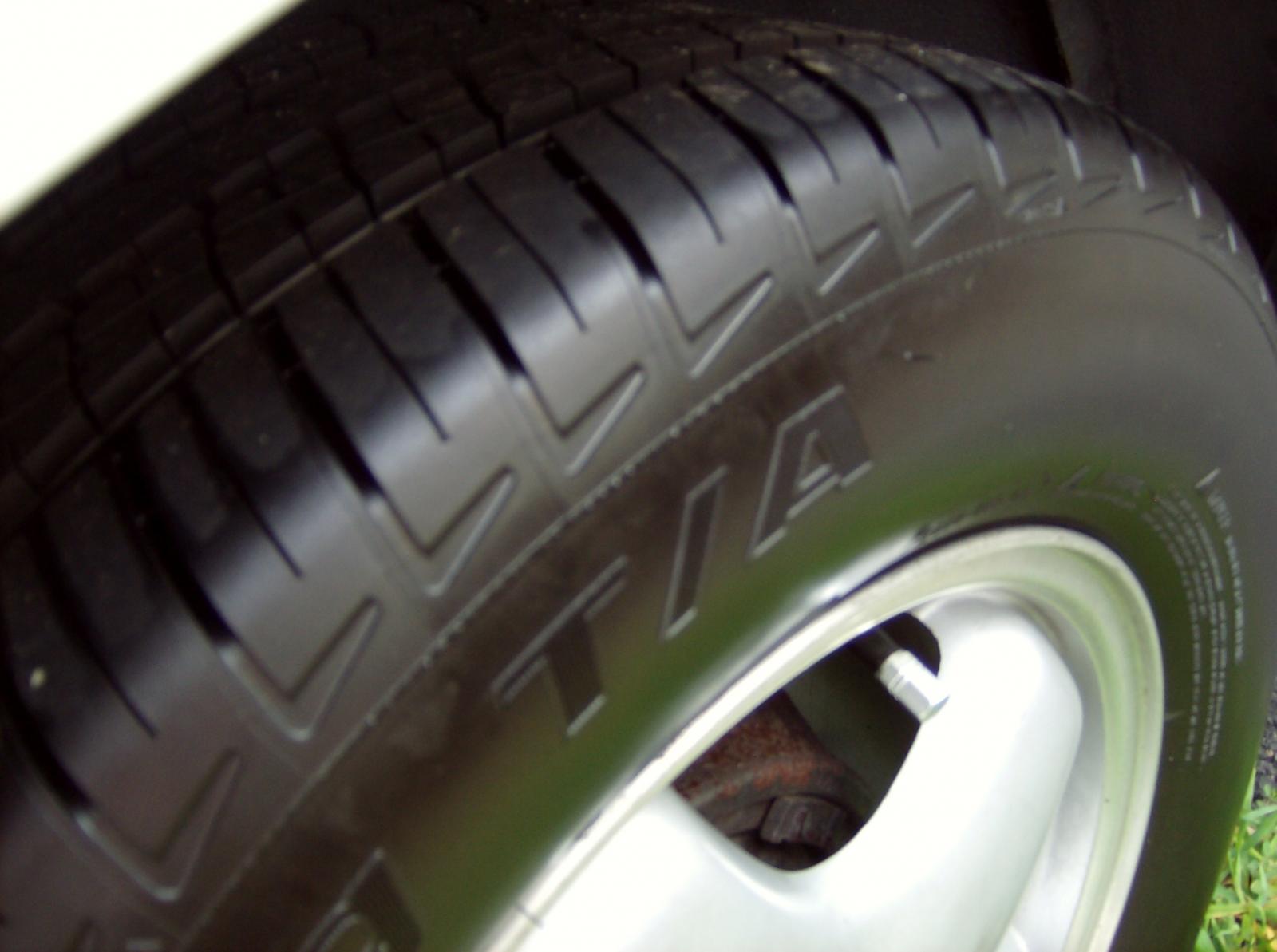

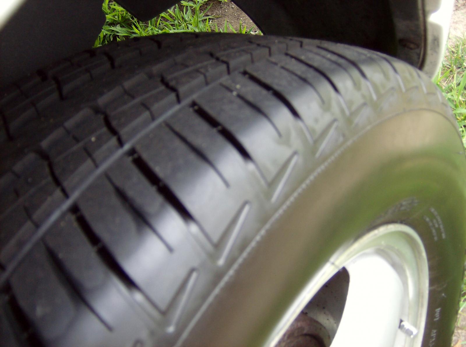

Cully77 Posted July 24, 2011 Report Posted July 24, 2011 show us an entire picture of the tire and state which wheel location it is; for example: right (passenger) rear. Quote
Addicted to eaton Posted July 24, 2011 Report Posted July 24, 2011 humm im gonna be weird. everone else says alignment. I say Rear sway bar? How are the end links on them? Quote
Jprice90 Posted July 24, 2011 Author Report Posted July 24, 2011 heres a pic of the left side rear, and the right side rear, it was just easier for me to get a picture the first picture is on the left, the second is on the right. Quote

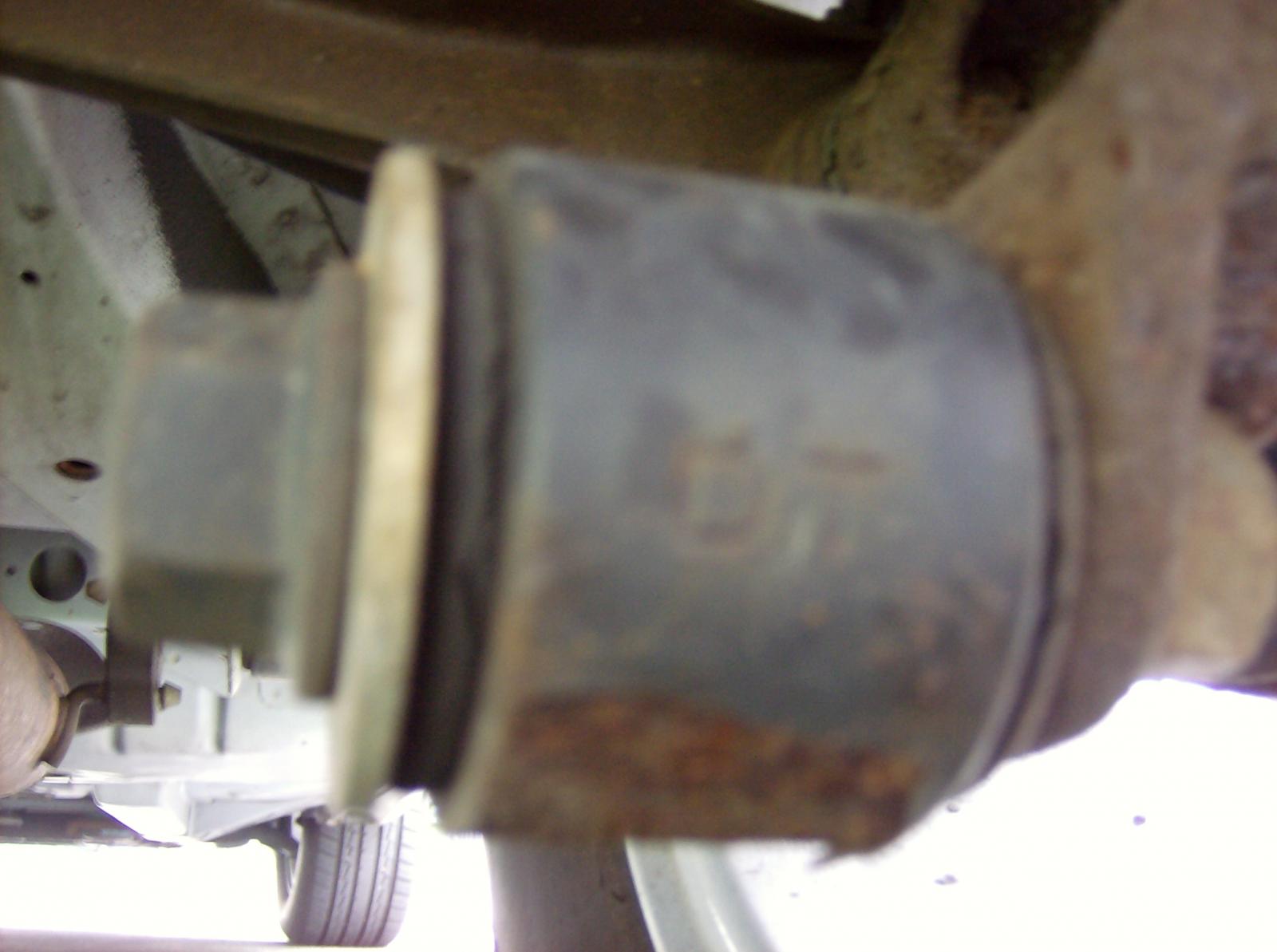

Jprice90 Posted July 24, 2011 Author Report Posted July 24, 2011 heres a pic of the bushings in the rear, this could be it..the right is a little worse then the left, this is the right side Quote

Addicted to eaton Posted July 25, 2011 Report Posted July 25, 2011 thats the trailing arm bushing. Quote
Jprice90 Posted July 30, 2011 Author Report Posted July 30, 2011 UPDATE: i got the tires re-aligned, they were WAY off, the back tires were bowed outward, and pretty much going to wear the inside of the tire, the front right was inward, and the left front was ALMOST in spec, so yeah i guess they were all effed . no more swinging and it handles alot better..THANK YOU ..i am going to replace those bushings sometime Quote
