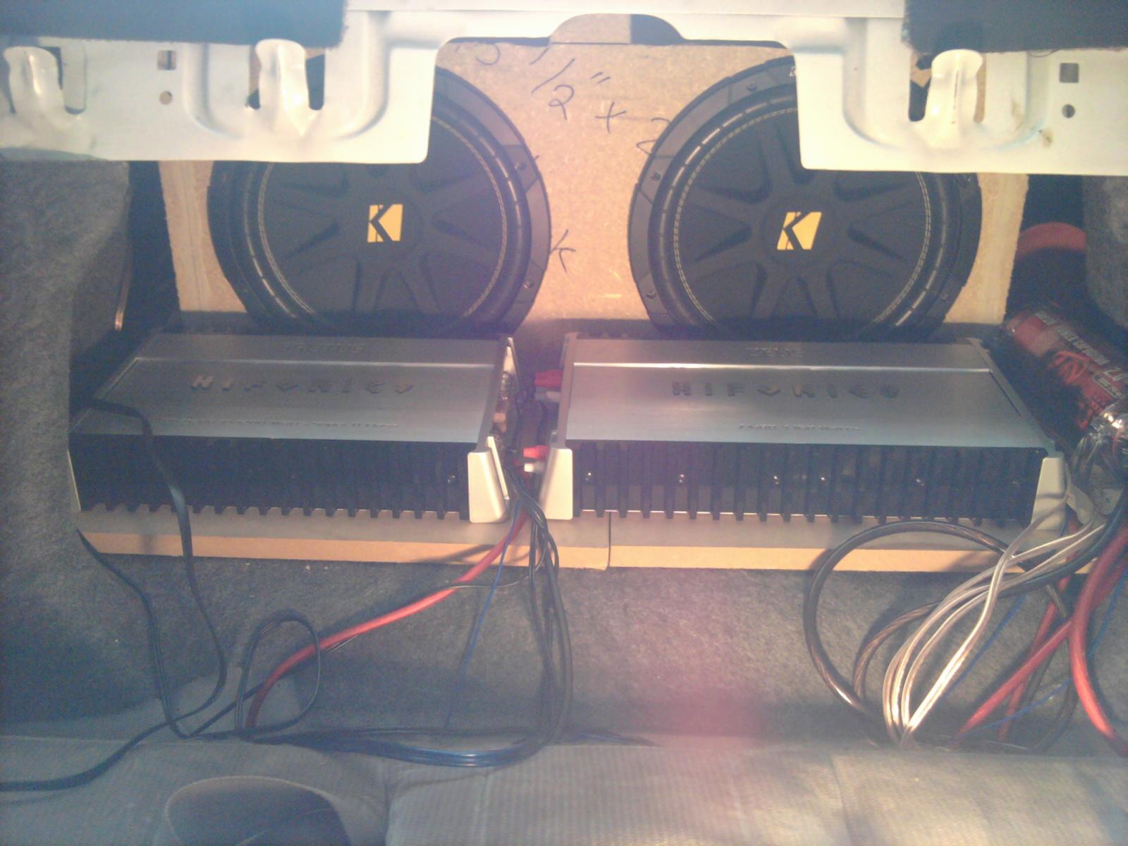

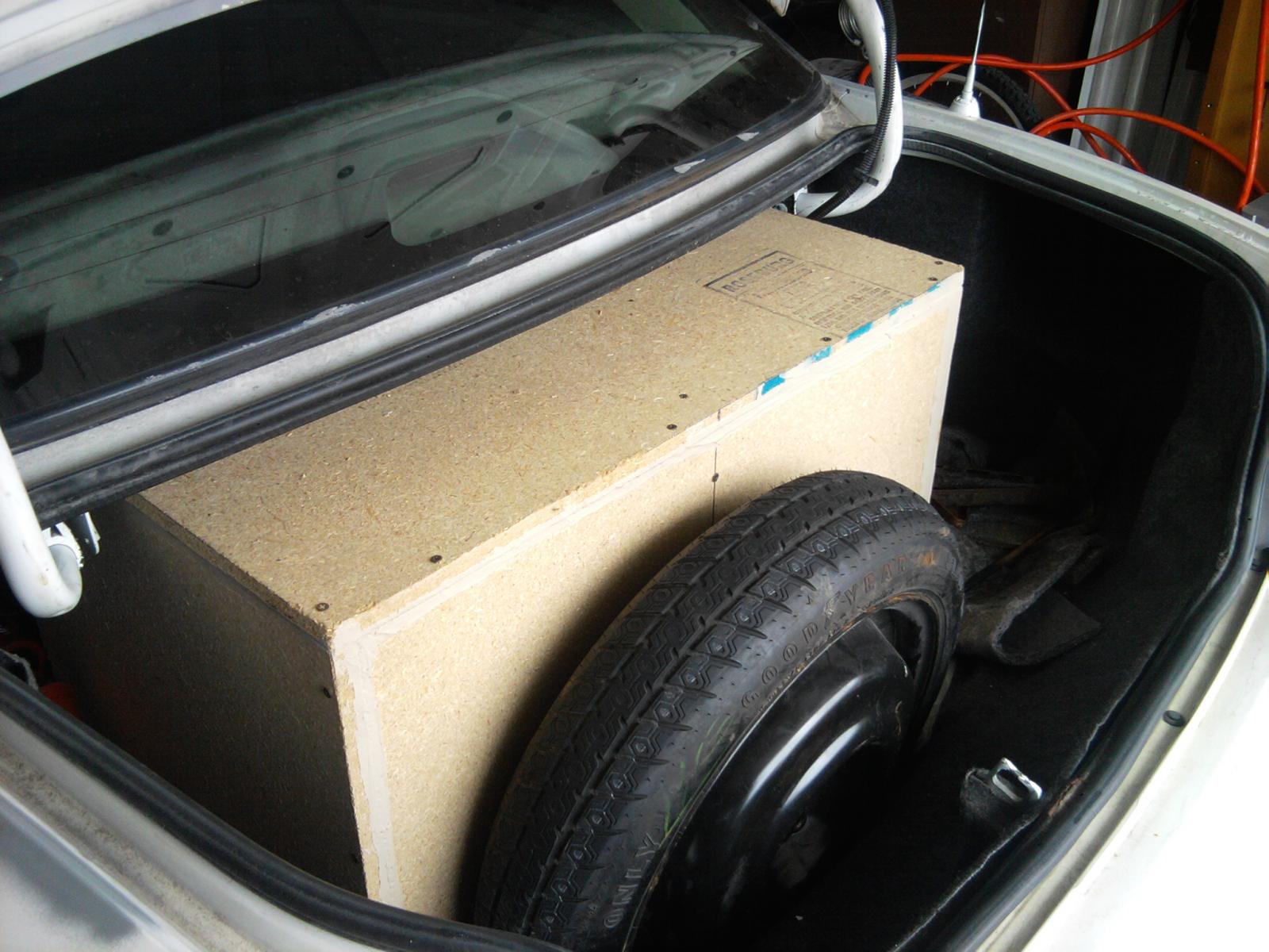

MotorCityFats Posted July 24, 2011 Report Posted July 24, 2011 Most audio installers will agree that a rear stage is the least of your concerns... I have a 1997 Lumina and I fit 6.5 "2 way components" in the front doors with no modification but could only use 3 of the 4 screws but no rattles and the door panels fit... I put the tweeter in the door sail.. its not the best spot but was sufficient and quick.. the rears I went with very cheap 6X9 3ways and tied them together with a Hifonics ZXi80.4 then ditched any chance of a trunk with a home built custom ported box with (2) 12" kicker comps 4 ohm running 2 ohm with a Hifonics BRZ1200.1D... I am still working on cleaning up the install but including all wiring, supply's and equipment I am still under $500 total and it sounds great.... but then my engine started to knock.. Quote
