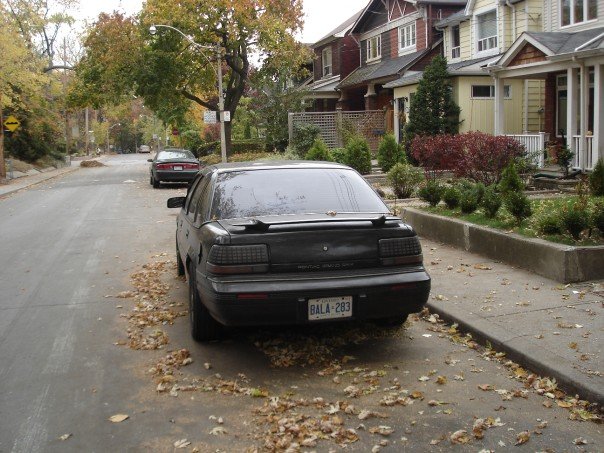

Artemis Posted June 23, 2011 Report Posted June 23, 2011 I've done it, did it on my 92 GP. It was very easy to do. This was years ago, don't judge the car please! She was my first. There's a red plastic piece that can simply be removed after you carefully separate the front clear lens from the housing. Then just RTV it back together and buy some red and yellow bulbs. Quote

Artemis Posted June 23, 2011 Report Posted June 23, 2011 did you have to heat it up or anything of that nature? No sir. Might have used an exacto knife to seperate the lens from housing. This was probably 5-6 years ago. I really loved how they look. I'll see if I have any night shots. Quote
