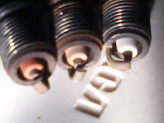

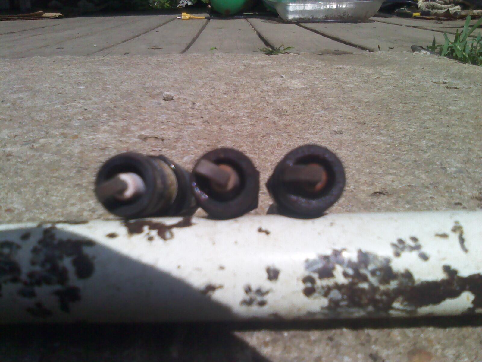

redynscire Posted June 22, 2011 Report Posted June 22, 2011 Pulled my spark plugs after about 500 miles since installing them... All the front plugs are nice and pretty.. Start on the rear, #2 the insulator is all brown and it was wet looking..#4 insulator is brown but does not look wet..#6 was as pretty as the front. Now there has been a bunch brown greasy crap i have been flushing from my radiator.. thought it might have been some stop leak from the previous owner....this brown crap is about the color of #2 and #4 plugs. but with #2 looking wet, it was kinda oily looking. would burning oil make the insulator brown? or could it just be the brown crap that is in the radiator and the wet look is from antifreeze? Guess i'm asking,...Blown head gasket or jacked up bottomend? Quote

redynscire Posted June 23, 2011 Author Report Posted June 23, 2011 here is a pic of the plugs.. no smoke. Quote
