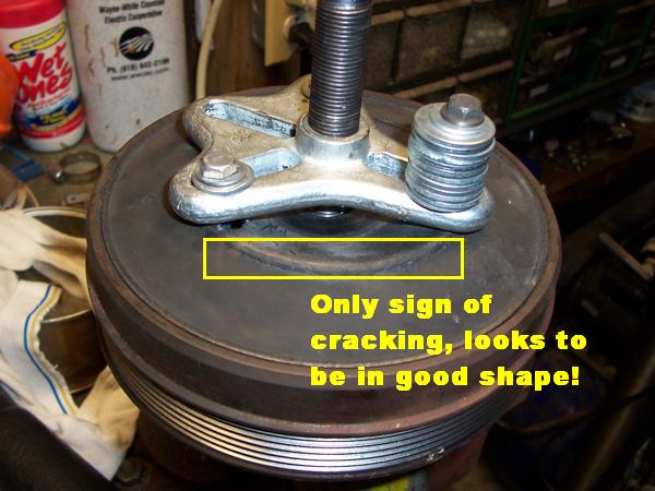

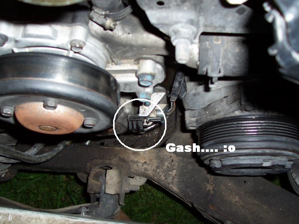

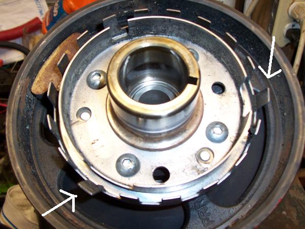

Oilpatch197 Posted June 19, 2011 Author Report Posted June 19, 2011 (edited) Well I shall let the pictures tell the story..... ...and the culprit is cord from the serpentine belt. My car eats serpentine belts(it's been 40k miles on this new belt and it's shredding and cracking.) so I got a bent pulley or something? (when I bought the car the alternator shaft was bent, I will double check but perhaps I got a bent pulley that is causing an alignment issue.) I would like to replace the harmonic balancer, I'm going to attempt a repair, as I need this car for work on Monday!!!! Any suggestions on how to carefully bend the teeth back? Also can I use the position of the old crankshaft sensor(by making a mark) to align the new sensor using the old bracket? Edited June 19, 2011 by Oilpatch197 Quote
BXX Posted June 20, 2011 Report Posted June 20, 2011 The balancer is like $100 new, I would throw a new one on. You could bend it back, but if its not pretty much dead on, you'll get a weak or erratic CPS signal or no signal. Quote
alec_b Posted June 20, 2011 Report Posted June 20, 2011 Right. Plus those "cracks", well that's where they fail. Just replace it you'll be glad you did Oh and replace the CKP sensor too, doesn't make sense not to. Quote
Oilpatch197 Posted June 20, 2011 Author Report Posted June 20, 2011 (edited) Well I fixed the Harmonic balancer with a hammer and EASY taps on the sides of the tangs to preserve the arc, and the middle ring had some warpage as well, very easy with the hammer and pin punch. I've done sheet metal body work and having so many machinist in my family.... I was familar with working with metal. I mic'ed it out, I got all the teeth within .010 of an inch run out. (the new sensor spec a .030" gap) and I used the old sensor on the bracket as a reference for the new sensor position on the new bracket, put everything back together and works great... Now after a CAREFULLY watching the pulleys it looks like I got a bent Water pump pulley and my Idler has a groove worn in it. $40 to replace both, and hopefully this will stop excessive belt wear. PET PEEVE RANT ON! What took the longest amount of time was finding ONE FRIGGING BOLT for my puller! The pulley I have uses a M7x 1mm pitch bolts, TRY FINDING ONE ON A SATURDAY AFTERNOON!!!! The puller kit I have has many different bolts, it only provided TWO of the bolts I needed... yeah they cheapened the kit, seriously! So I was pissed, the kit I had only had two of those bolts(what were they thinking!) so I was like "buy or rent a puller", RIGHT? WRONG, every place I went they had those pullers with the larger bolts, for like a Chevy 350 or similar. I_could_not_believe_it....... Sears, Rural King Hardware, O'Rielliy's(I always fock up that spelling), Autozone, nada, no SORRY! NAPA not open(weekend) So I Got pissed! Like DUDES how many 3800's are out there! OMG WTF!!! DUDES I'M SHUT DOWN BECAUSE OF THIS ONE STUPID BOLT. I got desperate and started the dig though my bolt collection and removed a bolt off the intake of another 3800, and it was about the right length, but the threads only went in about 3/16's of an inch then they got hard to turn, I was like FOCK IT, and got my harmonic balancer off. It's the bolt in the picture above with all the washers on it. That one bolt cost me many hours of my weekend!!! Edited June 20, 2011 by Oilpatch197 Quote
