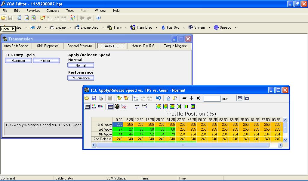

BXX Posted June 17, 2011 Report Posted June 17, 2011 98 Grand Prix GT, this should help ya:thumbsup: Of course it does kinda vary here and there, what vehicle did you get your PCM from? Quote

urbex Posted June 17, 2011 Report Posted June 17, 2011 Maybe I'm reading it wrong, but doesn't the chart Bob posted show it locks up at 30mph? Quote

redynscire Posted June 17, 2011 Author Report Posted June 17, 2011 Maybe I'm reading it wrong, but doesn't the chart Bob posted show it locks up at 30mph? i looked at that and was thinking the same thing....lockup at around 1/8 pedal, 30mph Quote
