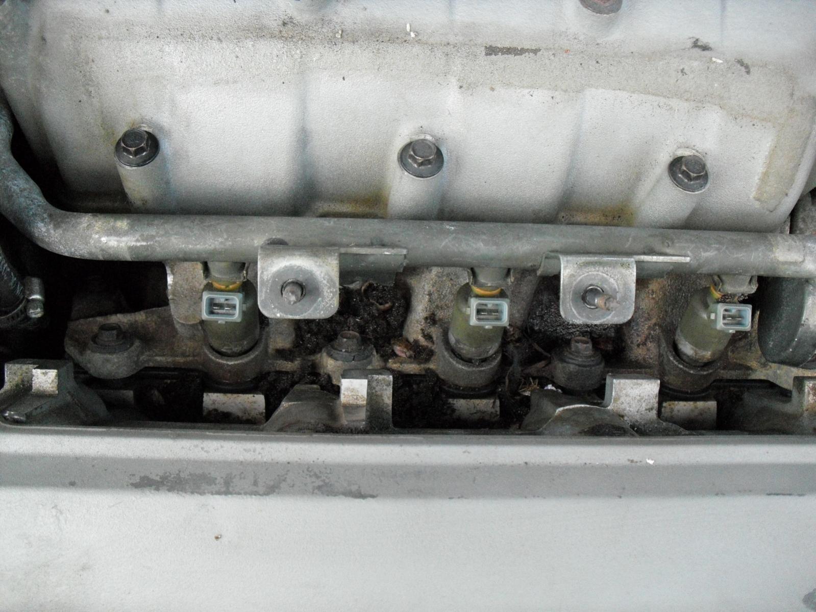

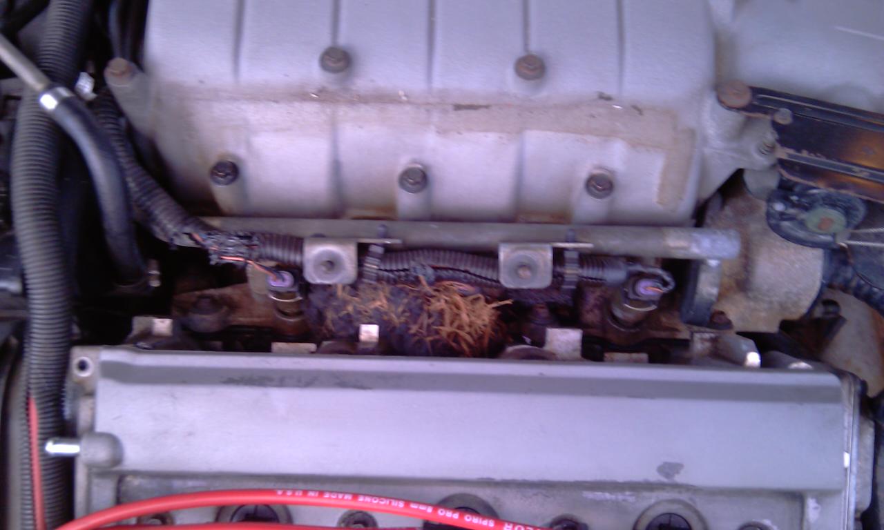

I just bought this car (93 Z34) a few weeks ago and I decided to go through some things on it and clean it up a bit and I found this.

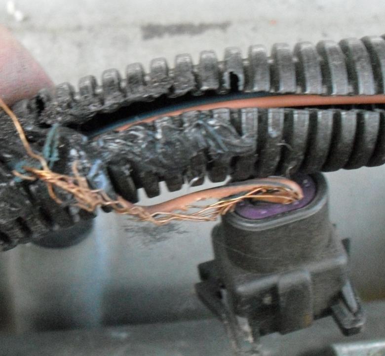

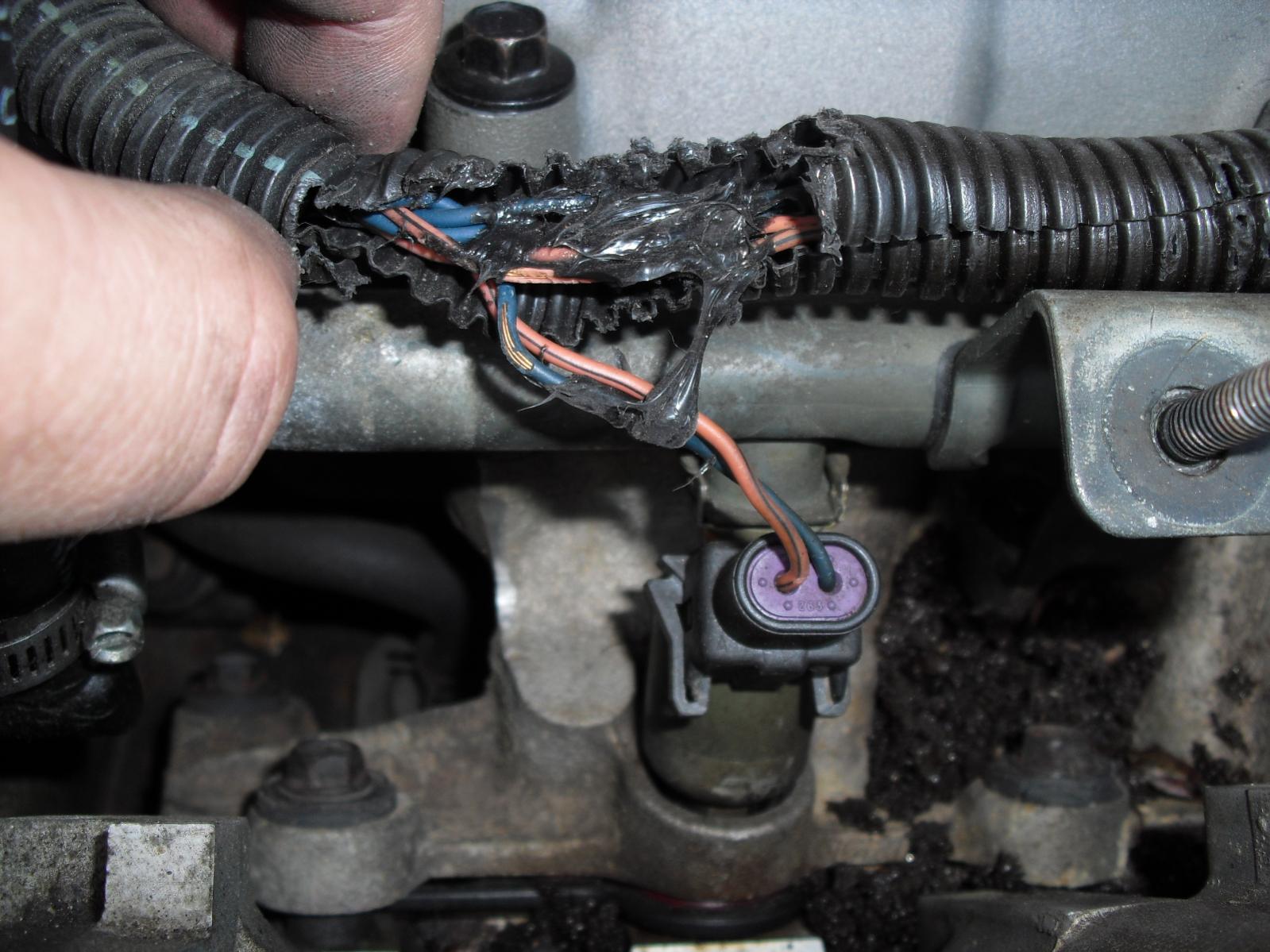

Its some kinda nest in there. Also after taking the nest out and looking closer I found two Injector Pig Tail wires were burnt.
The nest thing isn't that big of a deal to me but whats confusing me is, what would cause the wires to melt? I am going to get new ones soon but I just want to be sure that I don't end up installing them and burning them too.
I also want to add that the car ran fine the last time I started it.
Nesting animal chewed wires making them short together.

Just thought I would add a few pictures to show how bad it really was
