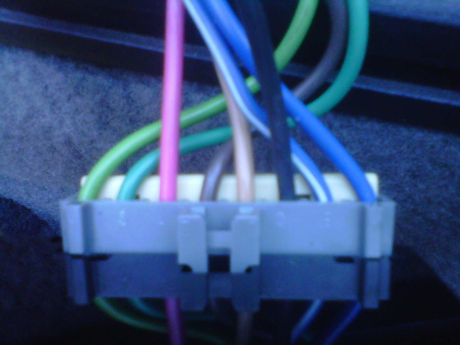

CSI_MuNkY Posted June 6, 2011 Report Posted June 6, 2011 Getting AC fixed is quickly moving up my to do list... But in the meantime, preferably before I drive 6-7 hours to Dayton this weekend, it would be real nice to get my drivers side front window to go down I am hoping it is just the switch... Can anyone tell me what wire to jump to test and see if the motor is working? FWIW, the window is stuck in the up position... The reason I think it is just a switch is because all the other switches on the panel are finicky, sometimes the windows will freeze where they are but if I open and close my door once or twice, I have control back. The locks do the same thing. Thanks Quote
RobertISaar Posted June 6, 2011 Report Posted June 6, 2011 (edited) pin A(dark blue) and E(brown) are for the driver's front window motor. it looks like powering the A wire causes to motor to push the glass upwards, so i would THINK giving the E pin about 12 volts or so would force the window down.... i'd wait for someone else to chime in though. EDIT: +12V to E and ground A to make the window go down, reverse to make go back up. the motor is grounded through the switch panel and reversing polarity should reverse direction. so you'll either need to have the connector plugged in and just apply the +12V where necessary or you'll need 2 jumpers. Edited June 6, 2011 by RobertISaar Quote
CSI_MuNkY Posted June 7, 2011 Author Report Posted June 7, 2011 (edited) Great! Sounds easy enough... Now where can I take power from to do this? I just jumped the wired on my power antenna to discover the relay was the problem back there, hopefully I can be that luck here too! *edit* got the 12v source figured out... All it did was make sparks, no window movement Edited June 7, 2011 by CSI_MuNkY Quote

CSI_MuNkY Posted June 7, 2011 Author Report Posted June 7, 2011 I used my booster pack... All I got was sparks, no window movement Quote
RobertISaar Posted June 7, 2011 Report Posted June 7, 2011 I used my booster pack... All I got was sparks, no window movement sounds like a shorted motor. Quote
CSI_MuNkY Posted June 7, 2011 Author Report Posted June 7, 2011 Well damn.... Thanks guys! Gonna have to price that out I guess Quote
