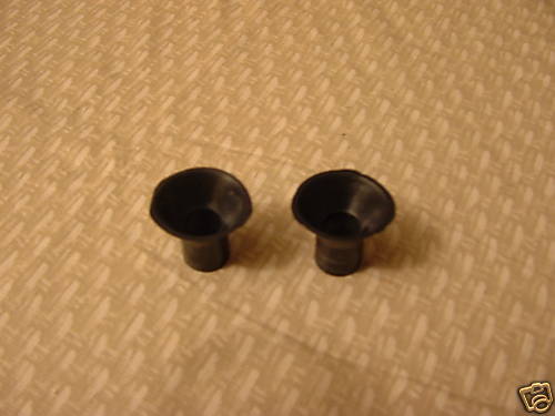

johnnyride Posted May 12, 2011 Report Posted May 12, 2011 Hey all, I was wondering, has anyone tried Fox Mustang pin guides for our cars? I know Foxes and Cutlasses were converted by Cars and Concepts, so perhaps they are the same. I just bought a set cheap on eBay to find out. I don't need them, but I like to experiment. Perhaps it will help everyone with these cars. Those guides are up on eBay all of the time. john Quote

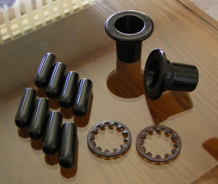

94 olds vert Posted May 12, 2011 Report Posted May 12, 2011 (edited) I haven't thought about using those. They look like the rim may sit up too high. If it was to be trimmed it might work really well. The cutlass pin cups are more flat on the surface, but if those could be cut to match they would probably work. Edited May 12, 2011 by 94 olds vert Quote
johnnyride Posted May 12, 2011 Author Report Posted May 12, 2011 They look more rubbery, so they may flex a bit. And break less. I'll report back when they arrive. And great picture! Quote
94 olds vert Posted May 12, 2011 Report Posted May 12, 2011 Yeah that is a good picture. Dhs1223 made a run 2 or 3 years ago of aluminum pin cups. That were powder coated black. I have a set of raw aluminum ones that I polished up. They looks great. Let us know how the fox body mustang ones work. I'm sure a lot of people could use that instead of trying to find original ones that are in good shape. Quote

johnnyride Posted May 27, 2011 Author Report Posted May 27, 2011 I have them. They look like they would work if they were shortened a bit. I need to experiment more. Quote
