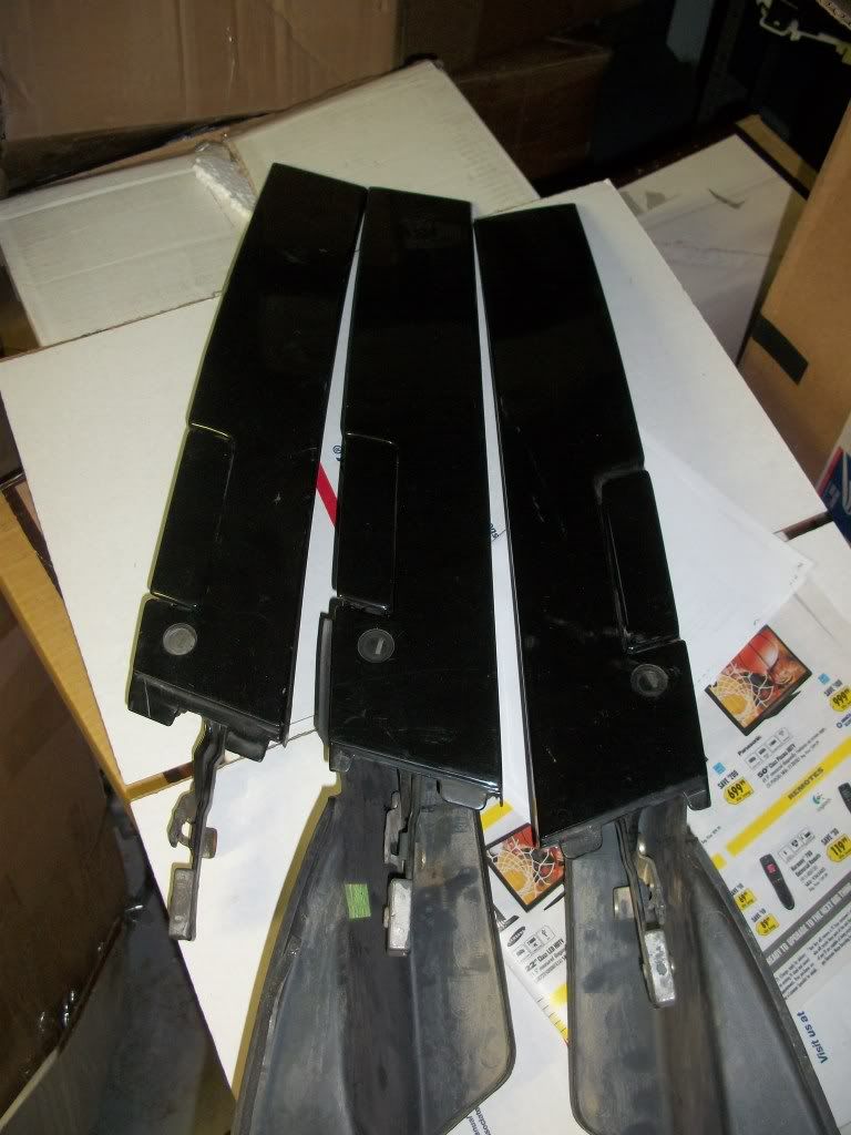

jimmyfloyd Posted May 3, 2011 Report Posted May 3, 2011 (edited) Are the doors open now and can you get the handles off? Are the GP handles different from the Lumina ones? The reason I ask is I was just getting ready to put these up. 2 lumina and a gp one I believe. You can have first crack at them if they will work. Edited May 3, 2011 by jimmyfloyd Quote
