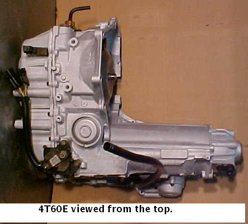

dodgethis Posted May 1, 2011 Author Report Posted May 1, 2011 Damn me....are you serious? So the Neutral switch is what allows you to put the car in park or neutral in order to start it? Wow, and the damn thing is on top of the tranny? Found this from the good 'ol search function: http://www.w-body.com/showthread.php/37834-Neutral-Safety-Switch?highlight=park+neutral+switch Quote

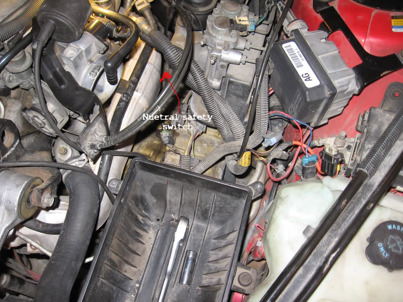

dodgethis Posted May 1, 2011 Author Report Posted May 1, 2011 (edited) Found where it is, if anyone has a similar issue. Thanks for the awesome pic pontiacmaniac94 found from http://www.w-body.com/showthread.php/34283-Neutral-safety-switch/page2?highlight=Neutral+Safety+Switch Edited May 1, 2011 by dodgethis Quote
