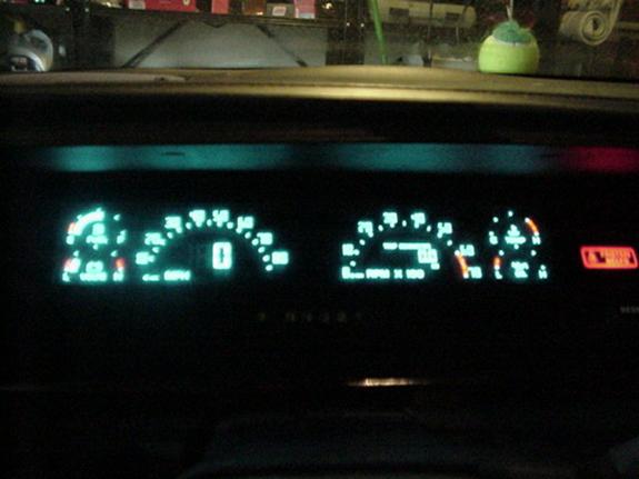

ABORT! ABORT! ABORT!
You have asked the wrong question. Proper question is: HOW DO I CONVERT TO A UB3 DIGITAL CLUSTER???
The Ub3 digital cluster is the full gauge (tach, oil, volt, temp) cluster that your car could have come with, but bastard GM apparently failed to do...
If you decide to pursue this I have the wiring info for the UB3 conversion upon request.
