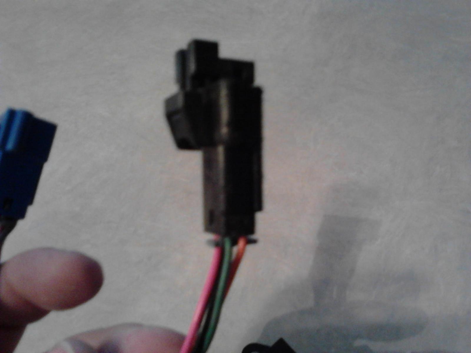

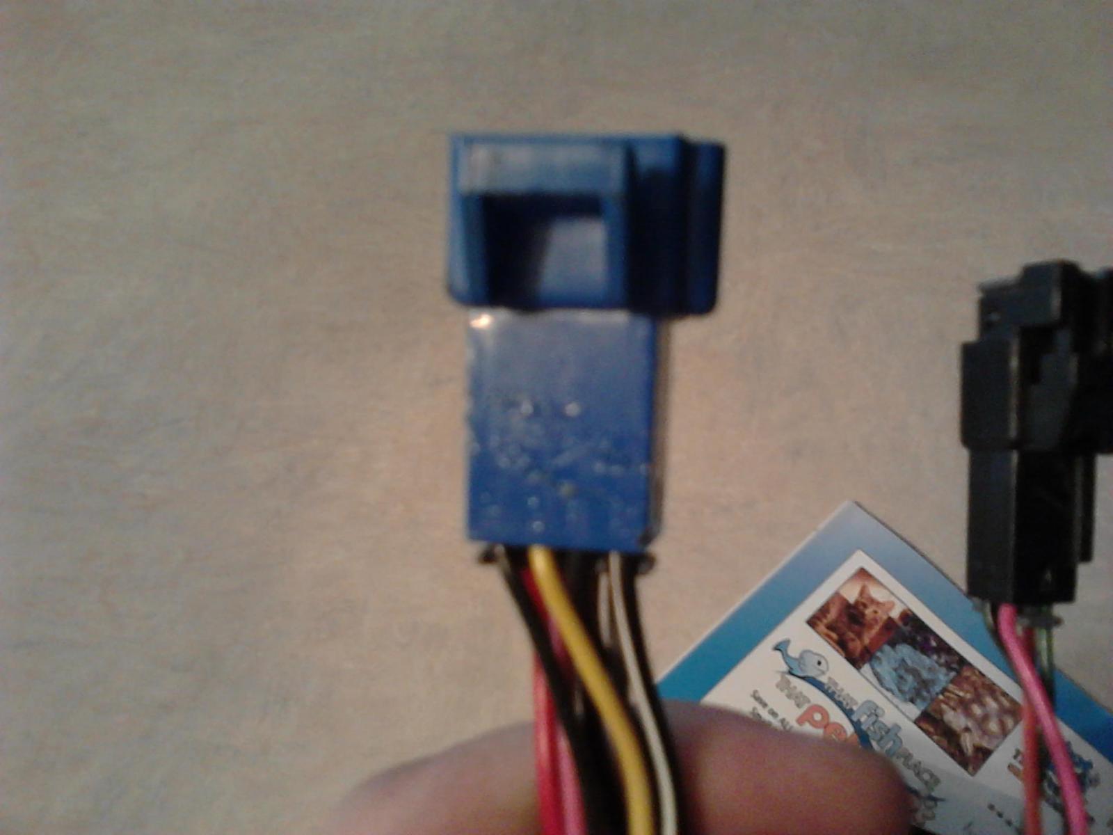

unclehotte Posted April 23, 2011 Author Report Posted April 23, 2011 Ok. Time to get serious. Got my DIS. Tomorrow i will (try) to install it. BEFORE I cut the connectors off I would like to know if anybody did it to a car like mine. Here is the Built date: 1992/03/02. (Since i got now several opinions in this thread from plug and play/wire it in/ to connectors are behind the ECC) The IDS is supposed to be from an Olds Regency 88-91. I Prefer plug and play if possible. Next 2 pics of the connectors since I dont know if they are all the same. Quote
94 olds vert Posted April 24, 2011 Report Posted April 24, 2011 Yeah I think you will end up connecting like 4 or 5 wires. A couple go to the cluster and one to the ALDL. It's pretty straight forward. The other wires are to the cig. lighter for power (orange) then to a black wire for a ground also can be used for the cig. lighter. I'm going to say your car is not pre-wired. But before you cut off the connectors I would check behind your ECC for two loose plugs. Never hurts to check. I have done this took me a good hour to an hour and a half. Definitely worth it. Quote
