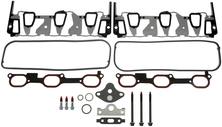

Stan9864 Posted April 8, 2011 Author Report Posted April 8, 2011 The gaskets in the Dorman kit are the Felpro premium permadry ones. Buying the Felpro kit would be dumb, costs more money for the exact same thing but without new bolts. Dorman's parts arent cheap crap, I love their parts:thumbsup: Dorman has responded to a request by advising that the LIM gaskets are "made of metal", and provided a picture (attached). Dorman has verified that the kit comes with 8 bolts, not the 6 shown. It looks similar to the higher cost FelPro and Victor gaskets. Additionally, an apparently knowledgeable reviewer on amazon gave it a good review. I ordered in this Dorman kit, and the $95 Victor Reinze master set. I'll eat the return costs just so I have whatever I need on hand. Quote

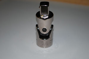

Stan9864 Posted May 5, 2011 Author Report Posted May 5, 2011 WHile taking off the LIM, I found that two of the diagonal bolts are under sort of an "overhang" on the LIM, and I could not easily apply a socket to them. If you know what I am talking about... how am I supposed to use a torque wrench on these? Thanks. Quote
Stan9864 Posted May 5, 2011 Author Report Posted May 5, 2011 Isn't that going to mess up the torque readings a bit? Quote
