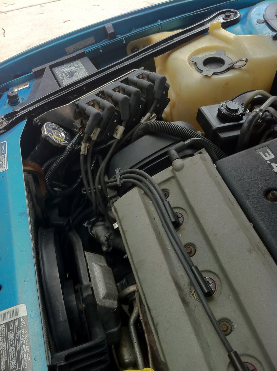

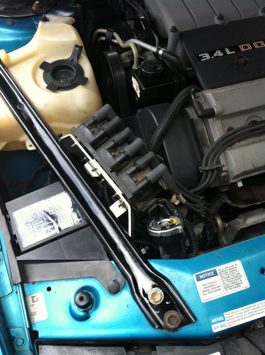

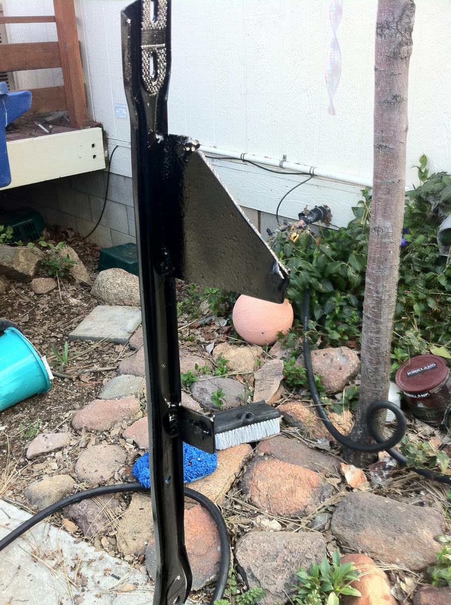

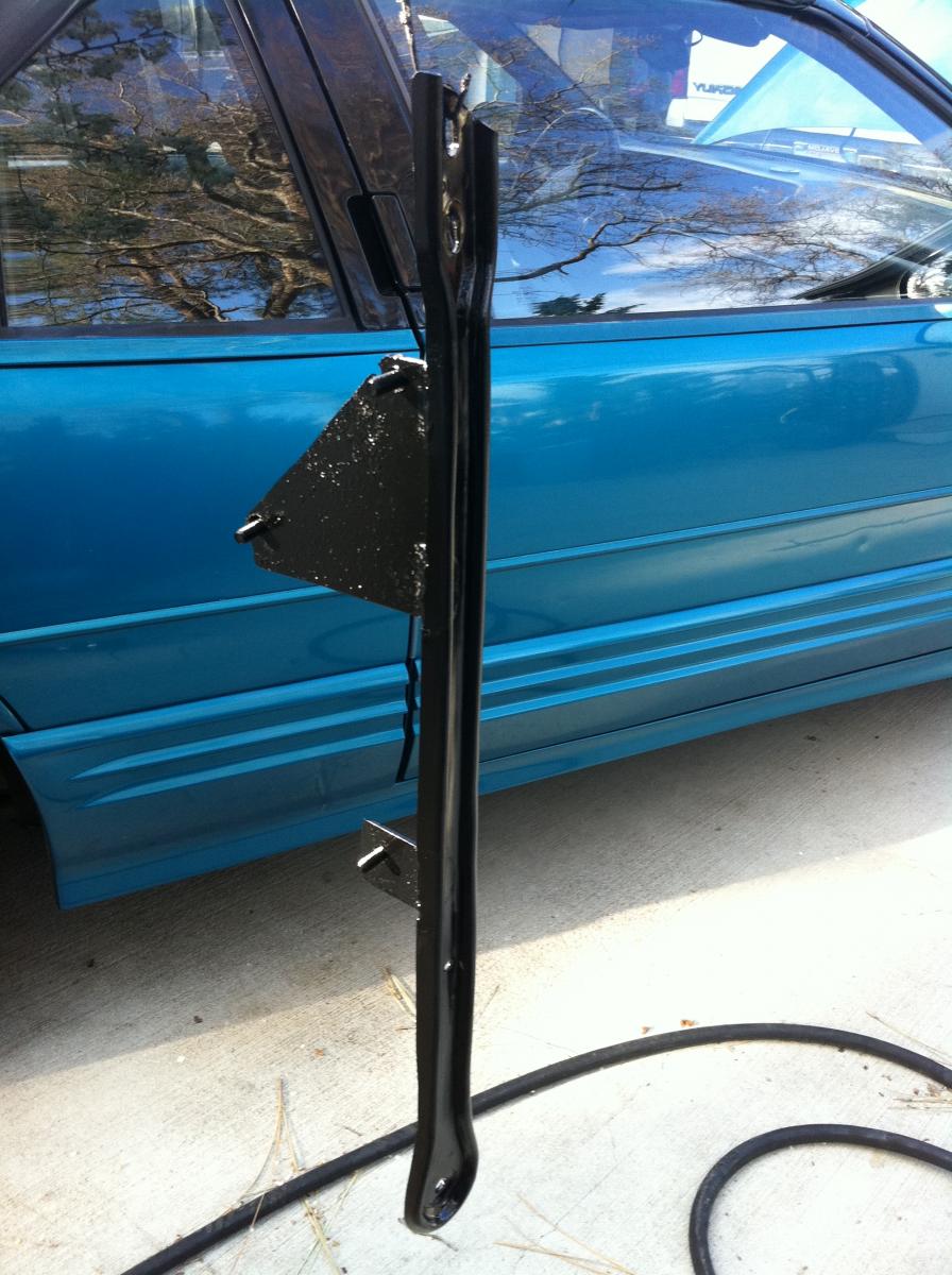

Well hear is where I put it & it worked great. I welded up some mounting plates to the strut brace. Will be changing out spark plugs & wires next week.post-5632-143689063753_thumb.jpg
yeah, that's not too bad of a location...
all 91-95 LQ1s (and all LH0s) have them up under the exhaust... :confused:
96 and 97 had them mounted above the belt drive, similar to the 3800 setup. and of course, the 3x00s (early ones at least, now sure about later) had them behind the UIM.
I might make some sort of cover so you won't see the back side of the mounting plate.
I just know there was NO WAY that was going back to the original location!
From when I did mine. Took the bracket, flipped it upside down, put in a spacer, and called it good.
Looks good! I thought about that but didn't think there was enough room. All I know is that we don't have to go through that pain in the A.... Job again.
I like how good you detailed the motor compartment, did you customize the cables or buy them premade?
Cables were pre-made to fit in the stock location. Obviously after the relocate I needed shorter cables.
If I were to do it again, I would have had shorter cables made to the lengths I needed.
