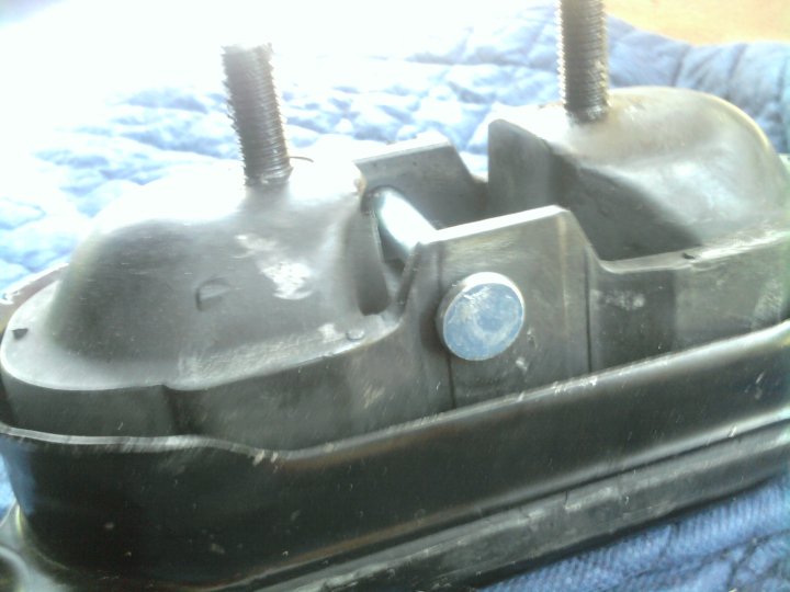

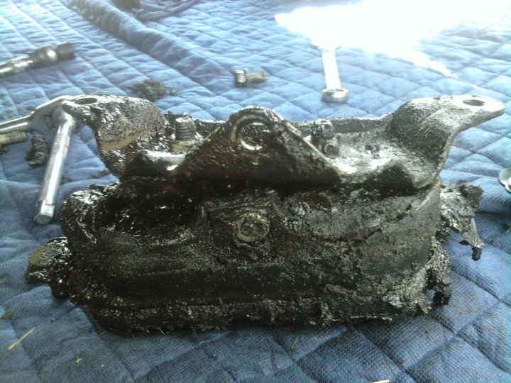

Thundernuts1979 Posted April 1, 2011 Report Posted April 1, 2011 I had the same issue in my 95 lumina..and I replaced the trans mount and lower motor mount with solid...(non fluid filled) ones...worked like a charm and I don't need to worry again about them leaking or clunking I included some pics of the lower motor mount and what it looked like before changing it...the bolt was the only thing holding it together... Quote
urbex Posted April 2, 2011 Author Report Posted April 2, 2011 Thanks so much for the pictures! Of course, Bdubs was more important than working on my car tonight. Hopefully tomorrow I can get some garage time, maybe I'll at least get down under the car and do a visual inspection of the lower mount. Thanks again!!! Quote

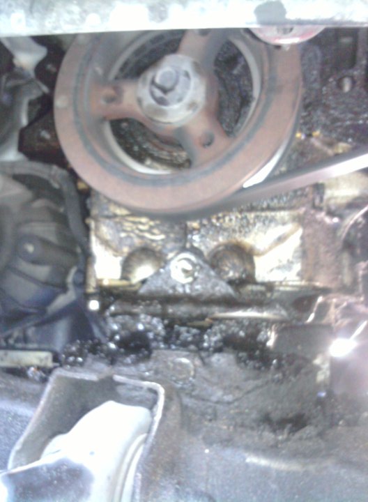

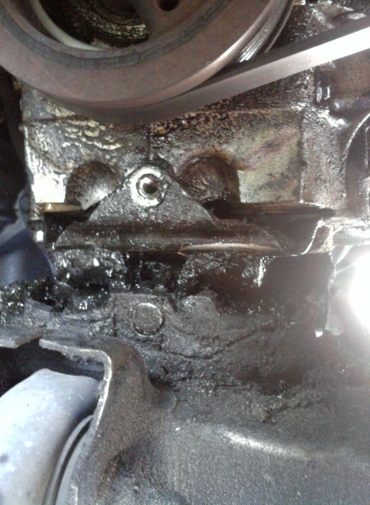

urbex Posted April 4, 2011 Author Report Posted April 4, 2011 Well, I did turn the other bushing, and it helped, but it's still there.... I decided to jack the car up and remove the wheel to get a look at the motor mount: I'm thinking that doesn't look very healthy....... Quote
urbex Posted April 4, 2011 Author Report Posted April 4, 2011 (edited) So here's my question. Is this is dire need of replacing? Then, what are some good brands? I know people have said to get solid ones, which makes sense... I've seen Anchor on Rock Auto, but it's fluid filled and I can get a solid slightly cheaper at Advance Auto. Auto Zone has Duralast but it's a little more...and honestly the part # is the same as the Anchor brand... Are they all made by the same company and just repackaged and repriced for different suppliers? I mean, why would I pay more for the one at Auto Zone if it's the same? I'm sure getting one directly from GM would be best, but I don't have that kind of money to spend... http://shop.advanceautoparts.com/webapp/wcs/stores/servlet/product_Mount-Engine-Transmission-Anchor_19300349-P_27_R|GRPENGPAMS_1465702203____ or http://www.autozone.com/autozone/parts/Duralast-Motor-Mount/1999-Chevrolet-Lumina/_/N-jd55bZ8ii2i?counter=1&filterByKeyWord=motor+mount&fromString=search&itemIdentifier=866223_195311_16129_ Other than brand, the one difference I see is it looks like AutoZone has a lifetime warranty...not sure if Advance does....so I don't know if that'd make the price worth it or not... Edited April 4, 2011 by urbex Quote
