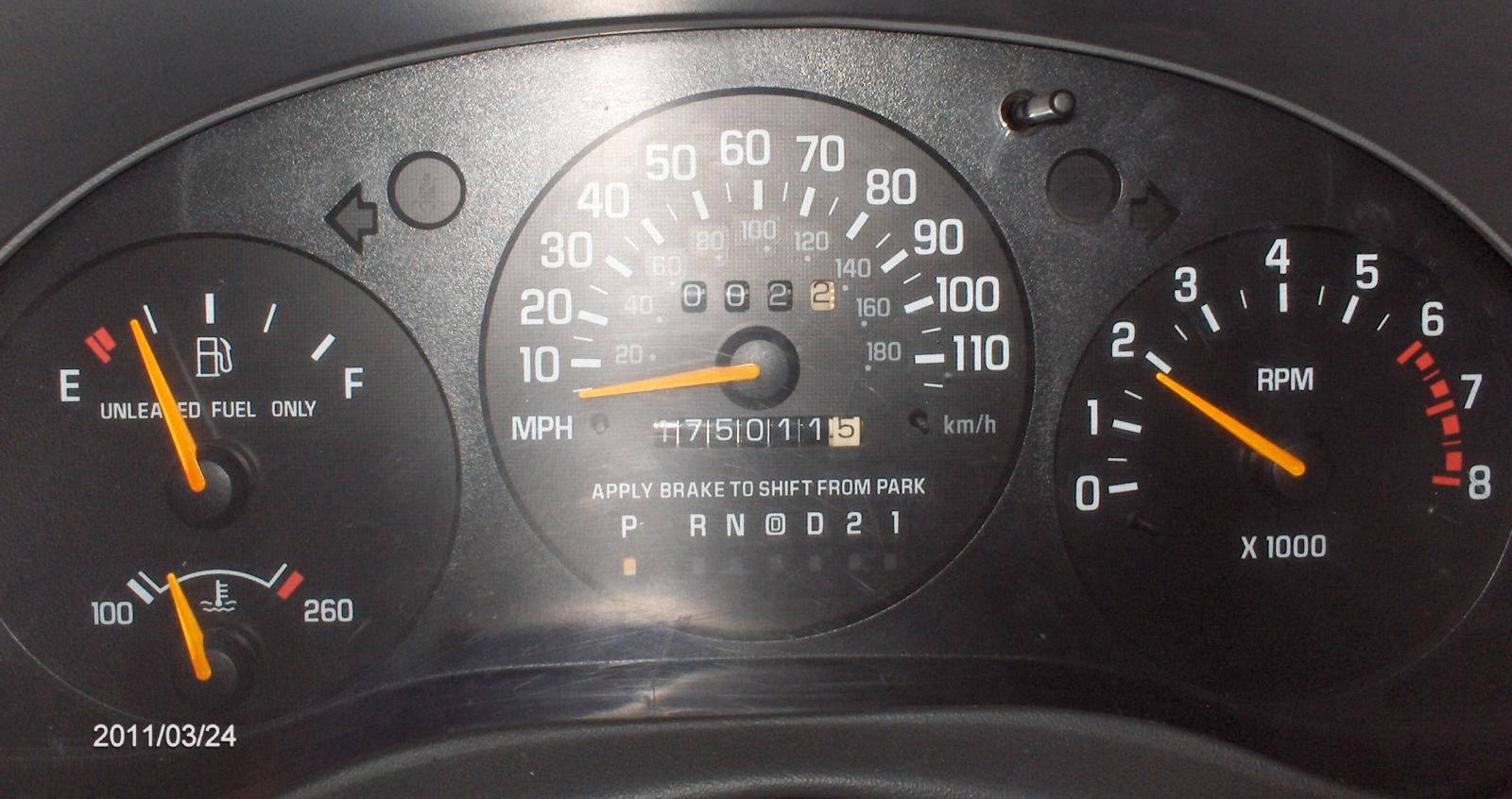

1979lee Posted March 23, 2011 Report Posted March 23, 2011 I'd like to swap my non tach cluster for a tach one, its an easy swap, my questions is What year lumina/mc can i get the cluster from 95-01 have the same looking cluster, but which year will work? about 3 years ago i came across a tach cluster for my lumina, i installed it , everything but the fuel gauge worked (the fuel gauge needle kept moving a bunch). i swapped over my spedo into it to keep the miles accurate. i think that other ckuster was from a 95 or 96 lumina. Thanks everyone, yall rock. Quote
9lumina6 Posted March 23, 2011 Report Posted March 23, 2011 I did this on my old 96 Base model Lumina.....and IIRC I had to use one out of either a 95 or 96. I think I put one out of a 97 on it originally and just the fuel gauge didn't work. The 2nd one I used was out of a 95 I think and everything worked flawlessly...completely plug and play. Yours being a 98...you SHOULD be able to use anything 97+. I did the exact same thing by swapping the odometer/speedo over to the new one. Pretty easy task. Quote
1979lee Posted March 23, 2011 Author Report Posted March 23, 2011 (edited) I did this on my old 96 Base model Lumina.....and IIRC I had to use one out of either a 95 or 96. I think I put one out of a 97 on it originally and just the fuel gauge didn't work. The 2nd one I used was out of a 95 I think and everything worked flawlessly...completely plug and play. Yours being a 98...you SHOULD be able to use anything 97+. I did the exact same thing by swapping the odometer/speedo over to the new one. Pretty easy task. Yeah its going to be nice having a tach! Thanks for the info, the time b4 the tach worked perfect. if it dosent work this itme around im gonna put my current fuel gauge in the new cluster. ive tried to add a few options to this base lumina, i put in a delco factory theftlock cd stereo, and illuminated passenger vannity mirror. Anyone know how to add factory cruise control??? HAHA she's a good car, now i just need to hit the yards and fine me a cluster. thanks Edited March 23, 2011 by 1979lee Quote

3pt1lumina Posted March 25, 2011 Report Posted March 25, 2011 Been there, done this on my 2 base Luminas. 95-96 are those years only, and 97+ works fine. Just be sure you are paying attention to the gear selectors on whether or not it's a floor shift or column shift, as that is the only other difference. The pins on a 95-96 for the fuel gauge are 3 pin, and the 97+ is 4 pin, this is why they do not work. Quote
1979lee Posted March 25, 2011 Author Report Posted March 25, 2011 Been there, done this on my 2 base Luminas. 95-96 are those years only, and 97+ works fine. Just be sure you are paying attention to the gear selectors on whether or not it's a floor shift or column shift, as that is the only other difference. The pins on a 95-96 for the fuel gauge are 3 pin, and the 97+ is 4 pin, this is why they do not work. I went to the yard yesterday, pickedup and installed the cluster, IT works great, i swapped my spedo over, and all the bulbs, mine were newer and cleaner. i got it out of a 97 m/c the mc had 182k on it black interior, car was fully loaded., somebody cooked the engine in it , the temp was maxxed out on the cluster and the trunk was full of antifreese juggs, not dexcool. here is a pic of the installed cluster. thanks to all for your help. Quote
