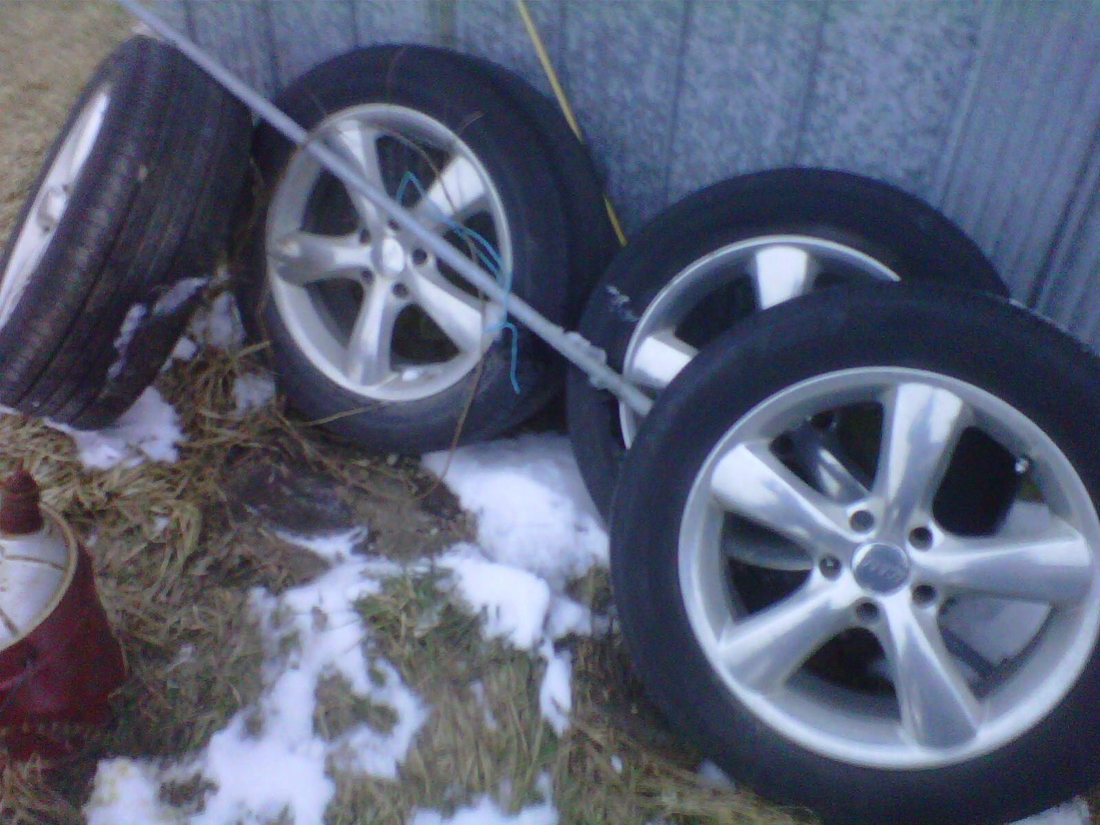

Breakdown Posted March 14, 2011 Report Posted March 14, 2011 i figure if I can get them for 150 or less, I'll go for it, why not? The why not is that you can pay the pipper now or pay him later. If you buy these, you'll spend piles of time and money on spacers. You will probably need a bolt-on spacer, not just the plates. And by the time you do all of that you could have just paid the extra $$'s for rims that actually fit. BTW - I checked with a tire shop, most would sell you rims that won't fit for your car unknowingly. Offset is the amount of millimeters off center of the rim that the tire bolts on to. It does NOT describe the amount of backspacing on the rear of the rims to avoid contact with the calipers, etc. These should fit your car, someone around here is asking $150 for them, rubber is no good. No shortcuts with the rims on these cars. If you're lucky, you may be able to find a set of good used G35 rims out there that are cheap. They are compatible. Quote
