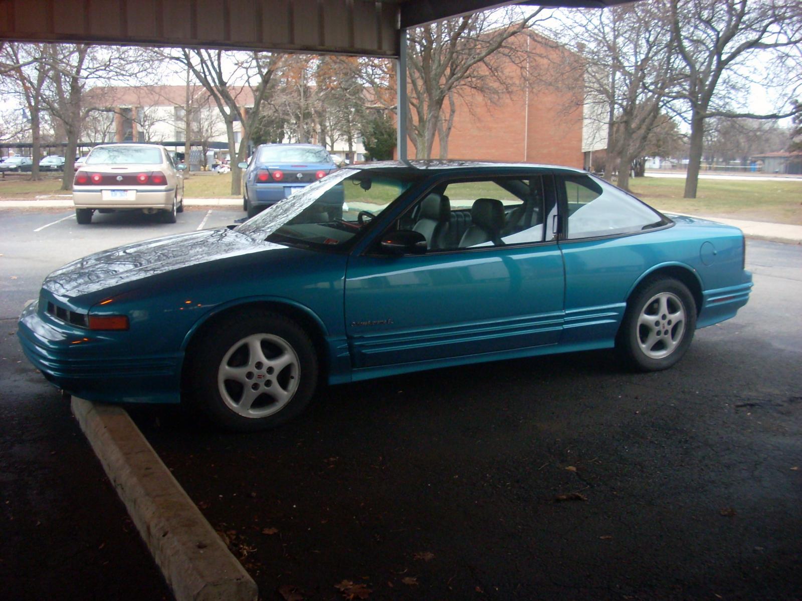

94 olds vert Posted February 17, 2011 Report Posted February 17, 2011 Nice cutlass! Gotta love that color. Quote
