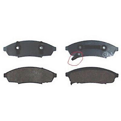

threepointone Posted January 31, 2011 Report Posted January 31, 2011 92 lumina on the brake pad facing the tire theres a little clip its doesnt touch anything im just wondering why is it there Quote
BXX Posted January 31, 2011 Report Posted January 31, 2011 Its the wear indiciator. When the pad gets low, it will rub on the rotor making noise and telling you to install new brakes:thumbsup: Quote
MemphisMan Posted January 31, 2011 Report Posted January 31, 2011 I had a friend who just wouldn't listen to me when I told him the squeal was his brake wear indicators and that he needed to change his pads. He thought his brakes just needed some WD-40...WTF lol. Yes, he didn't listen and ended up having to replace his rotors. Quote
threepointone Posted February 1, 2011 Author Report Posted February 1, 2011 thats what i figured but wasnt positive im using pfc carbon metallic pads. ok so it dont matter how the outer pad is installed with the wear sensor up or down? Quote
pwmin Posted February 3, 2011 Report Posted February 3, 2011 thats what i figured but wasnt positive im using pfc carbon metallic pads. ok so it dont matter how the outer pad is installed with the wear sensor up or down? doesn't really matter...i usually install them down Quote
GnatGoSplat Posted February 4, 2011 Report Posted February 4, 2011 GM thinks it's important that they be installed up! From the service manual: Important The wear sensor is on the outside pad. The sensor is positioned at the leading edge (upward) of the pad during forward wheel rotation. I don't know why it's so important, but it's actually under the heading "Important"! Can't really see why it matters myself. Quote
virtuetovice Posted February 4, 2011 Report Posted February 4, 2011 Probably because there are idiots out there that will won't know to change the pads until "why the fuck aren't my brakes working?? OH SH----" Quote
BXX Posted February 4, 2011 Report Posted February 4, 2011 the squealer actually makes more noise in the upward position:thumbsup: Quote
