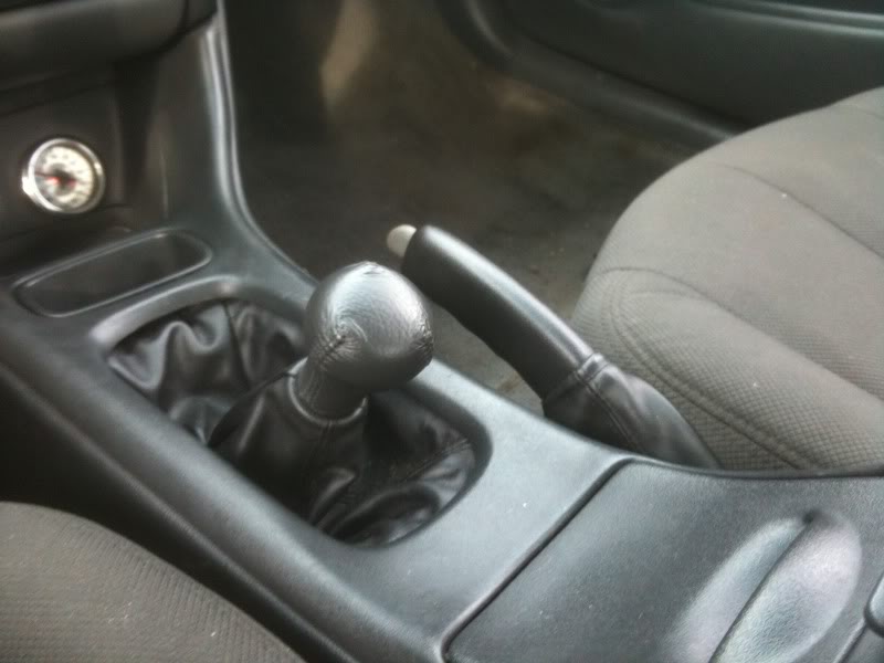

White93z34 Posted February 1, 2011 Report Posted February 1, 2011 I went as far to get a 94+ push to set lever and cable, in the end I didn't like how poor it would have fit... nothing wanted to line up for me. I ended up keeping the pump to set lever. Quote
kuntzie Posted February 3, 2011 Report Posted February 3, 2011 you can do it, its in my 89 right now aswell i used 2g rear cables, 2g knuckles and brakes, and the front cable and ebrake from a grand am gt (99+ w/- disc brakes) on a 2 g you just add the handbrake and still use the grand am cable, its plently long enough with little effort it can be installed looking oem, also a grand am console does NOT fit at all, nor could i find and console ith a handbrake that did. Quote
intern8tion9l Posted February 3, 2011 Report Posted February 3, 2011 wait...you did that on the 89 as well? Quote
kuntzie Posted February 5, 2011 Report Posted February 5, 2011 ya i have it in both, the 89 is a bitch, im debating on selling it but continusly doing work to it but alas, still engineless at this time Quote
intern8tion9l Posted February 5, 2011 Report Posted February 5, 2011 you have pics of the install in the 89? Quote
wickedbuick Posted February 19, 2011 Report Posted February 19, 2011 I swapped the push to set pedal about 5-6yrs ago and it was cake. Modified the bracket angle a little and used some washers to space it and it works great. still used the stock 91 cable and calipers too. It took less than an hour to get the old out and the new in Quote
white4d96 Posted February 19, 2011 Author Report Posted February 19, 2011 [ATTACH=CONFIG]3286[/ATTACH] WANT! :drool: Quote
stockgp Posted February 20, 2011 Report Posted February 20, 2011 [ATTACH=CONFIG]3286[/ATTACH] i wonder if something like a jaguar xj6 brake handle would be a good alternative. they are made to go right next to the console Quote
Mach 5 Posted February 27, 2011 Report Posted February 27, 2011 I like that ebrake handle setup. but I guess you would have to swap rear brakes then Quote
Psych0matt Posted February 27, 2011 Report Posted February 27, 2011 Hmmm, I might think about doing that on the GTP this summer... I don't suppose you did a writeup? Quote
