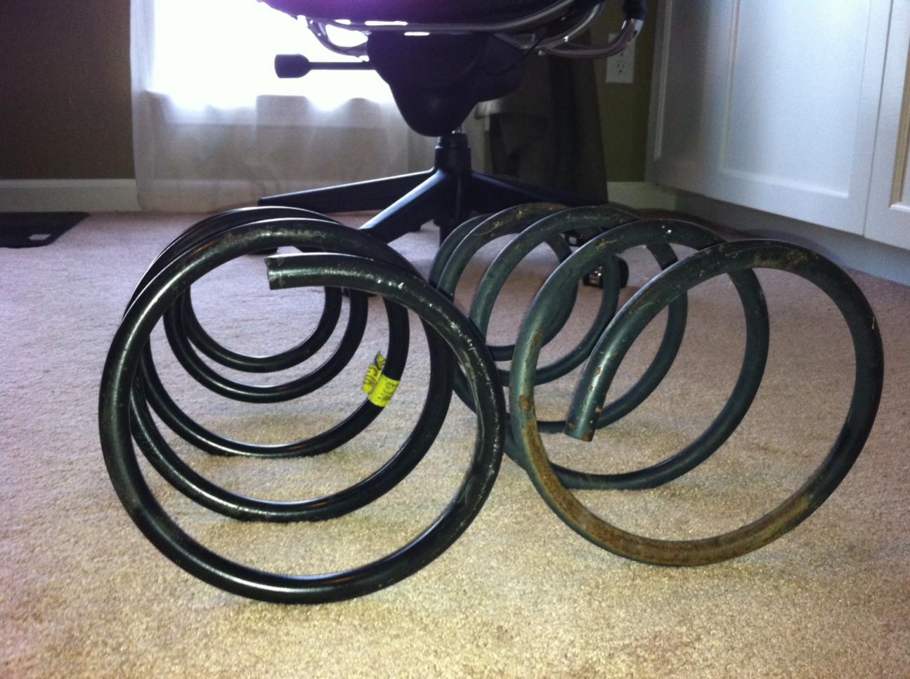

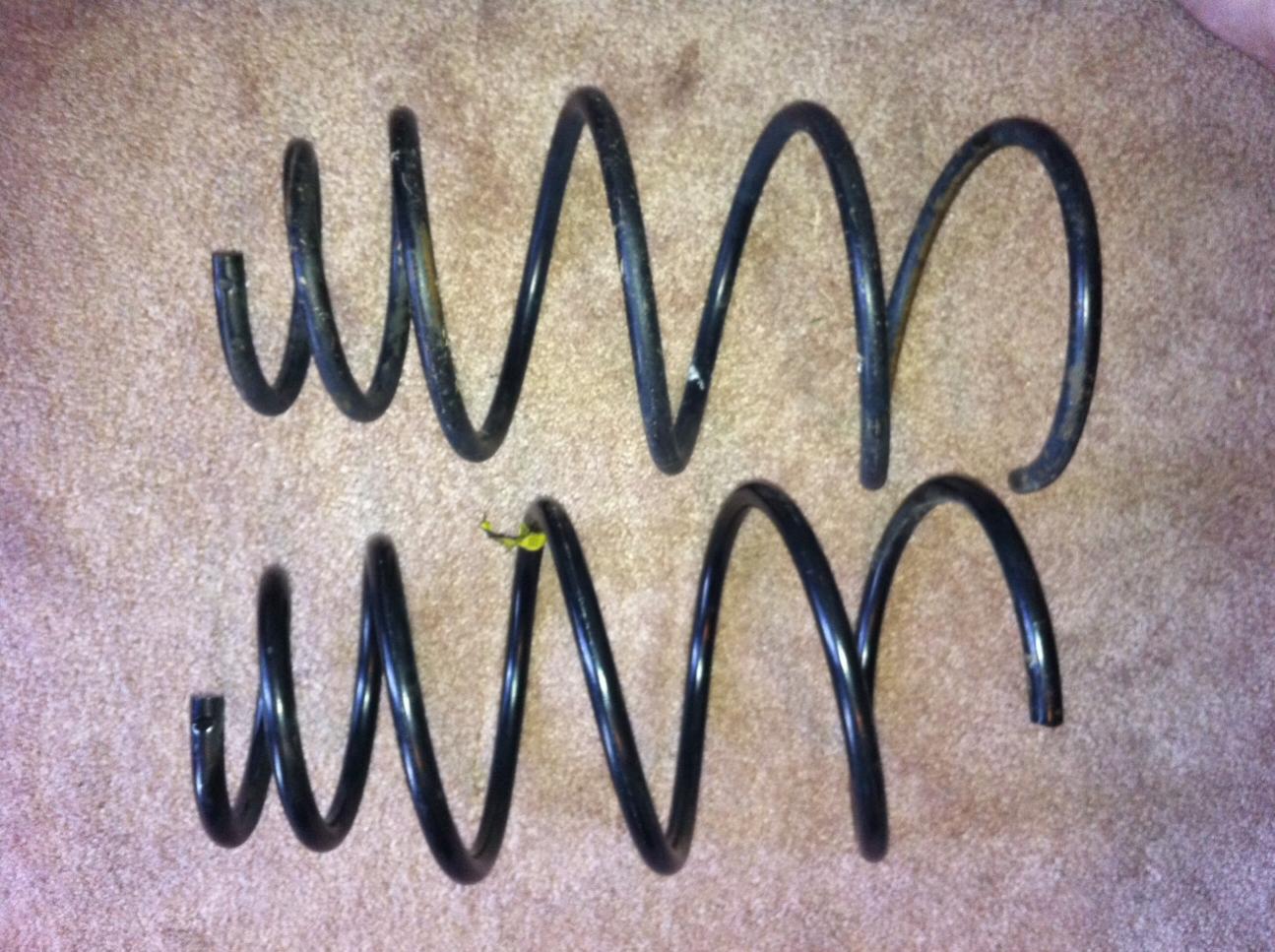

MemphisMan Posted June 6, 2011 Report Posted June 6, 2011 Thanks Crazy K. My stock springs still have the coding tag on them. The code is CJK. Don't know what the donor spring code is. The 3 things that affect spring rate that I know of are: -Diameter of the wire -Diameter of the spring -Number of coils (as the number of coils decrease, the spring rate increases.) The only difference between the springs that I can tell are the number of coils (about 1/4 longer on the donor). Based on this it seems the spring rate would increase as the spring became shorter...like from me cutting it , so I just don't get why the donor spring would be softer if it happened to be the same length as my CJKs. Here are some pics of the two springs. The one on the left is my stock CJKs, the one on the right is from the donor. You can see they look the same except for the donor one is about a 1/4 coil longer. Quote
