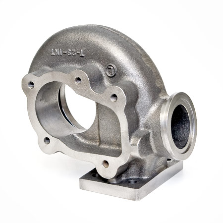

Turbo v-sick Posted January 16, 2011 Report Posted January 16, 2011 Garrett has an optional housing for the t25 frame. With some modifications it should work with our platform. Quote
Mach 5 Posted January 16, 2011 Author Report Posted January 16, 2011 Adam I liked that housing but I think that without a different downpipe and crossover this would be too close to the coolant line and the intake system.. At that point I would just switch to v band. update- I found that my crossover had cracked underneath the header wrap and its leaking at both tapered ends. yay!! -Jarek Quote
