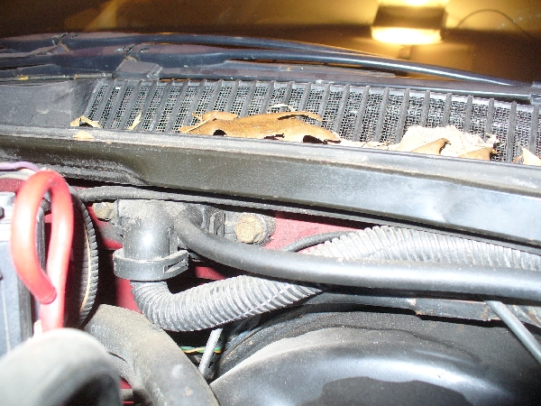

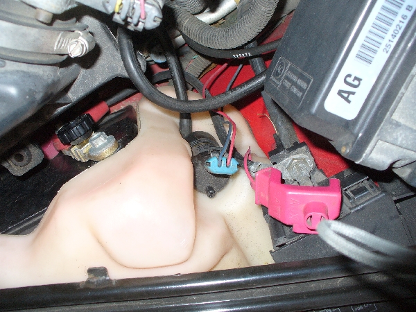

Here's a couple of pics of my 94 vert. One end goes by the battery, the other into the firewall behind the dipstick. If it's not shooting washer fluid out from somewhere it might be a fuse (under glovebox?)?
Thanks! It was disconnected leaking fluid out under the car after I filled up the container. This is helpful!:thumbsup:
