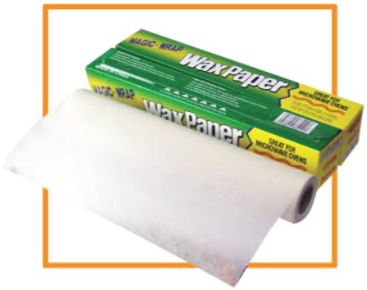

mediabandit Posted December 31, 2010 Report Posted December 31, 2010 Take a piece of wax paper, any kind you pick up in the grocery store for $1.89 or so. Wrap the filler neck with it, then wrap your duct tape around the wax paper, you will have no issues with the gas eating the duct tape for about a month, so it will give you lots of time to fill it up and replace the filler neck when you get time. Quote
AL Posted December 31, 2010 Report Posted December 31, 2010 X2 on the wax paper... I also thought about suggesting wrapping a garbage bag around the fuller neck and taping that up Quote
mediabandit Posted December 31, 2010 Report Posted December 31, 2010 X2 on the wax paper... I also thought about suggesting wrapping a garbage bag around the fuller neck and taping that up Garbage bag won't work for any period of time, gas will eat right through it. Quote
Penglii Posted December 31, 2010 Author Report Posted December 31, 2010 I like the wax paper idea, that's just simple enough to be brilliant! I will be giving that a try, it could also improve the adhesion of the duct tape as opposed to being right on the near-freezing cold metal... Should I remove the filler neck from the car for the patch-up job? Or is it "easy" enough to finagle some tape around the pipe while it is still on the car? I'm sure I'll see for myself which way will be easier as soon as I get up in there... Quote
