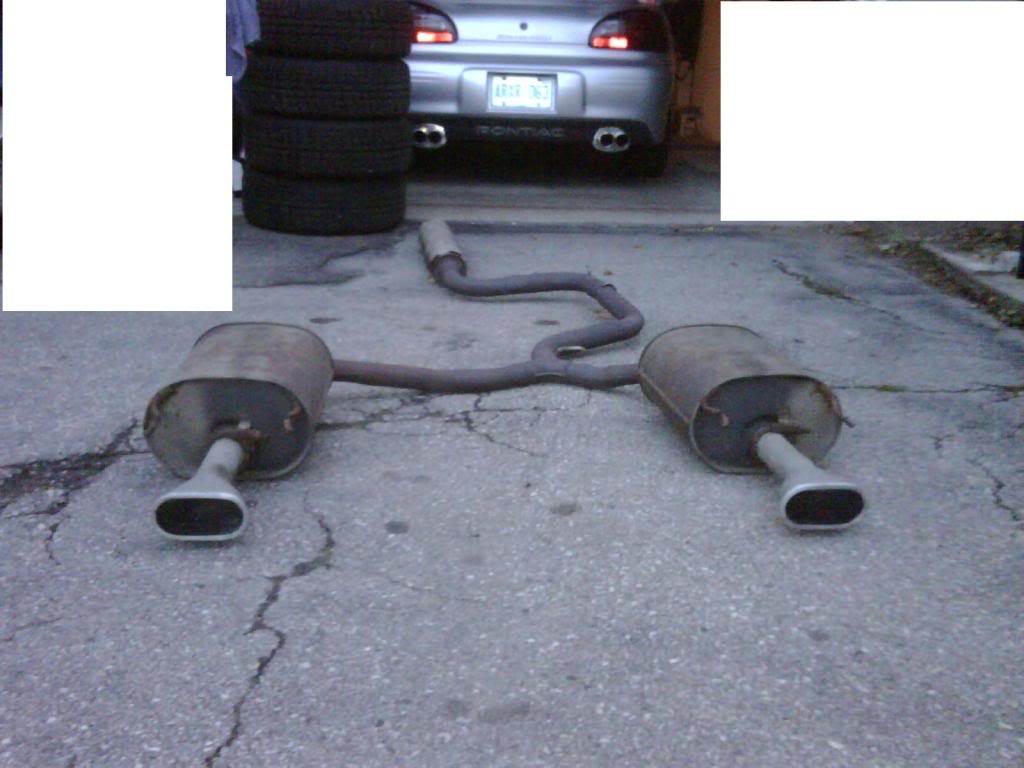

AL Posted December 28, 2010 Report Posted December 28, 2010 Look for my thread in members rides about fixing my clogged cat problem and check out the routing of the exhaust Quote
pwmin Posted December 28, 2010 Author Report Posted December 28, 2010 Look for my thread in members rides about fixing my clogged cat problem and check out the routing of the exhaustcool, thanks. Will do after work when I can view the pictures...stupid work filter Quote
pwmin Posted December 28, 2010 Author Report Posted December 28, 2010 so, after the resonator, it goes to a 90, then straight for a bit, and then bends in towards the middle and then bends back out...instead of the bends after the bend after the resonator, why can't it just go straight back? there seems to be plenty of clearance even when the suspension is at maximum travel Quote
