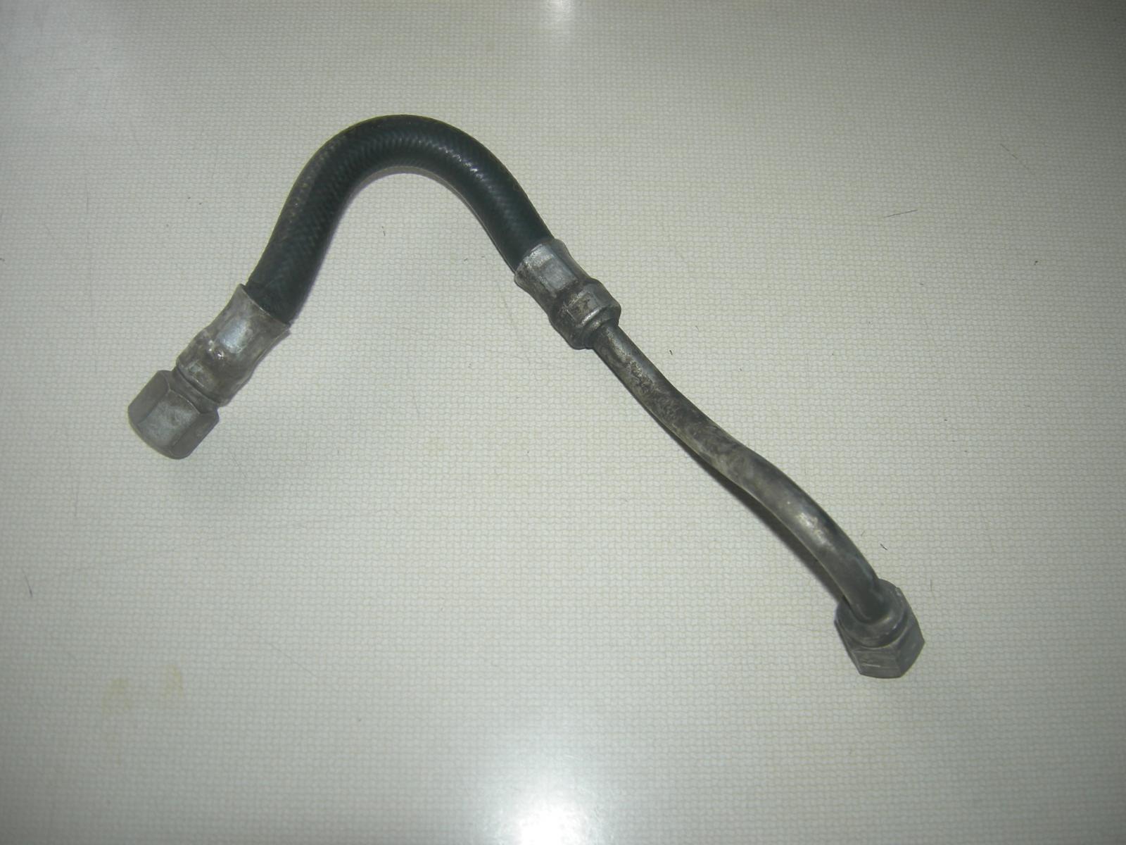

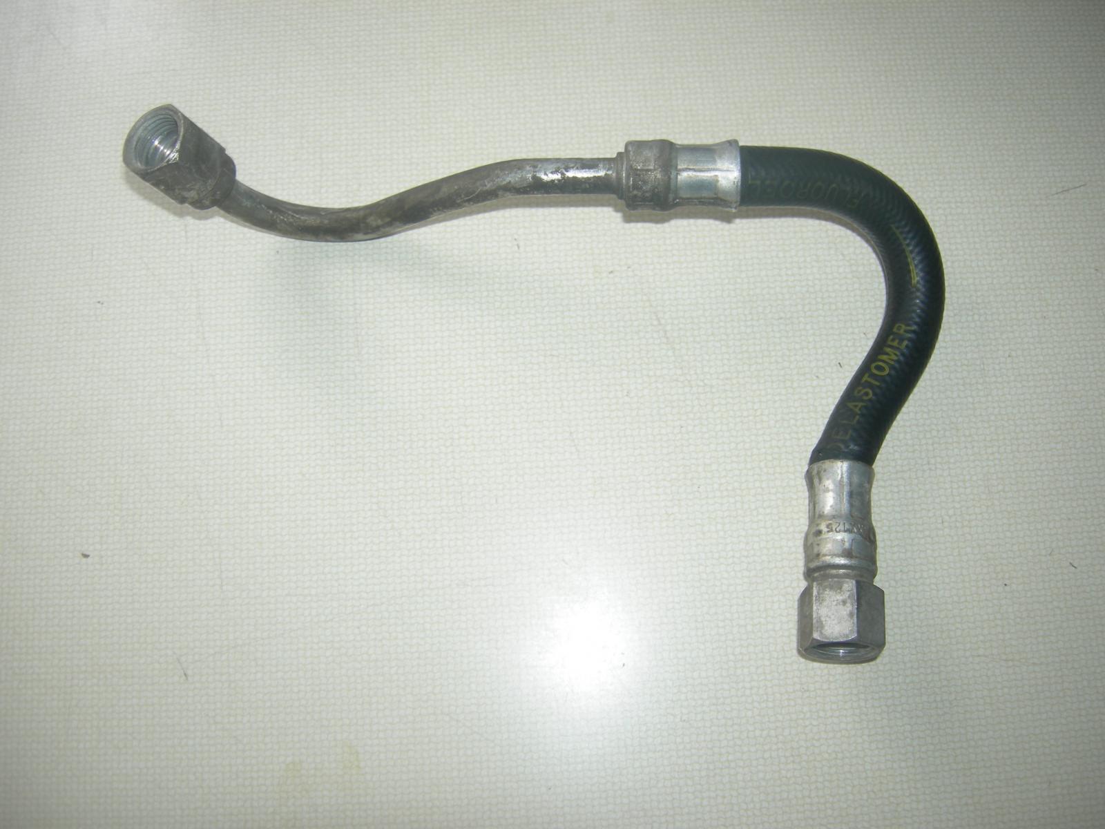

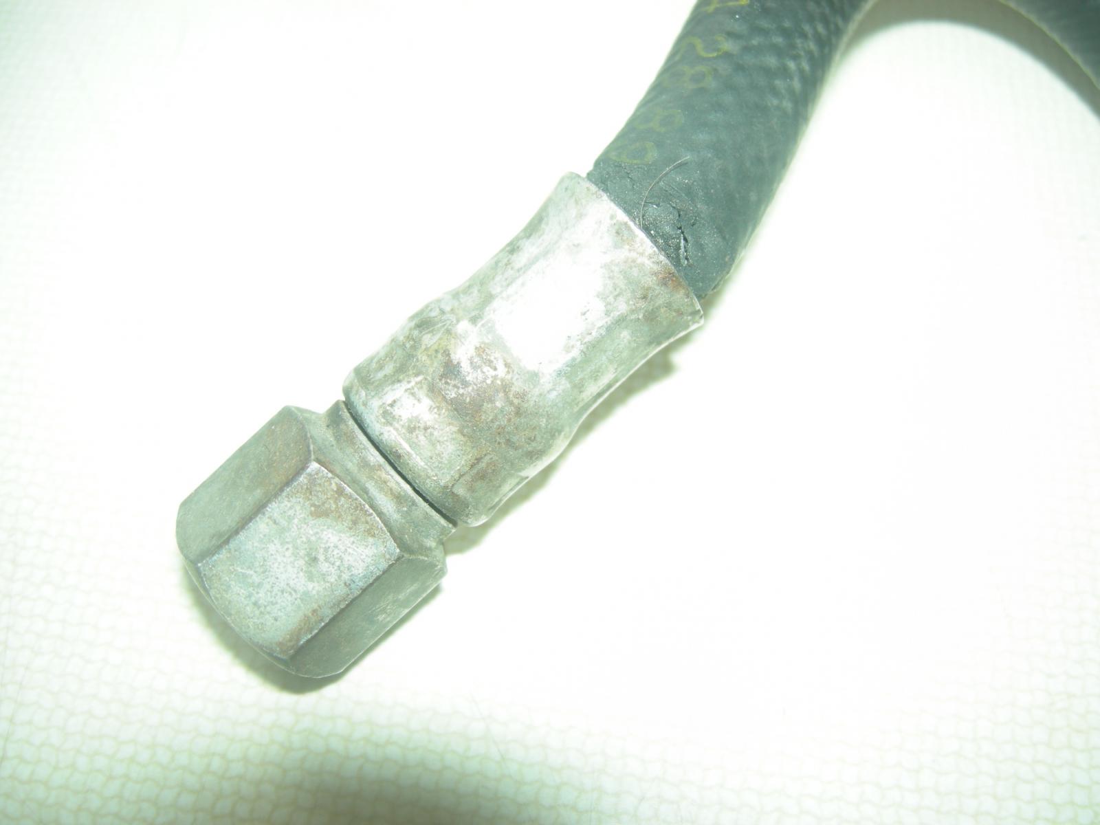

my fuel feed line just sprung a leak on my TGP. this is the section that connects to the fuel rail on one side and the other side connects to the fuel line going to the tank. both sides are threaded.
I "think" this is the feed line. its one of the two going into the fuel rail, this is the one towards the front side of the car
Pretty much any 88-91 2.8 or 3.1 line will work just fine.
Thanks, I will get one from the local pull and spray.
I had mine done at Moreland hose for about $50 for both feed and return. They cut and braze new crimps and hose on
Im sure any place that makes hoses can do this. I had mine switched to barb ends when I redid everything so I could use push-loc hose
