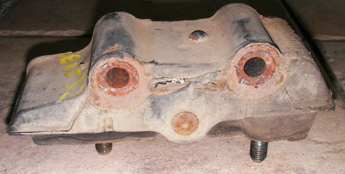

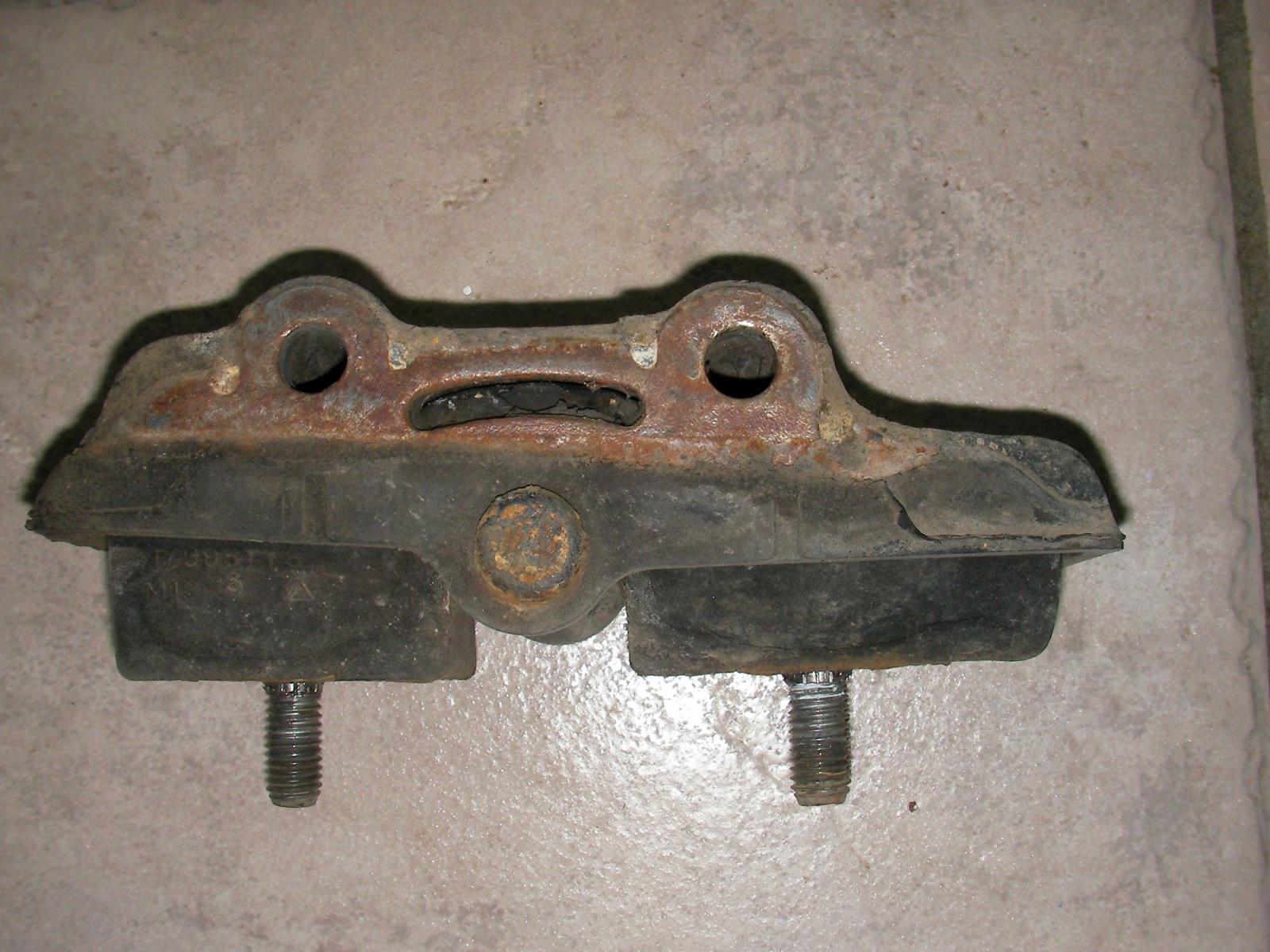

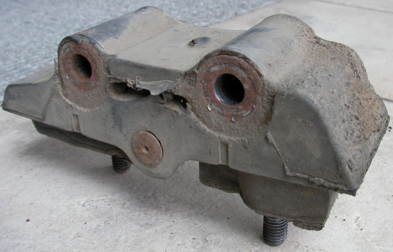

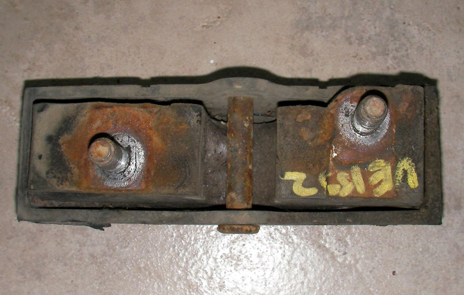

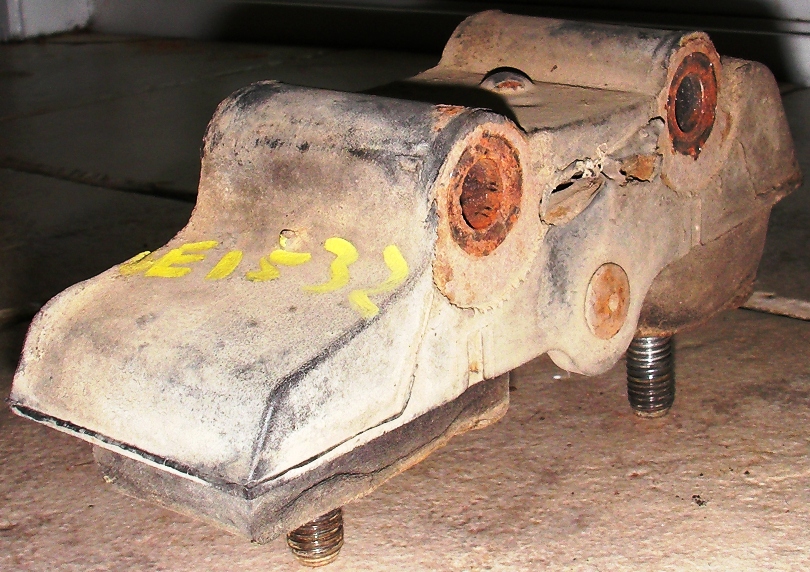

crazyd Posted November 20, 2010 Author Report Posted November 20, 2010 (edited) My thinking is is that there is one already in production that is close enough that we can use it... The Getrag is a German design correct? It wouldnt surprise me if a German car was using a similar mount Nope, this one we can be proud of - engineered at Getrag Gears of North America in Newton, NC. It's really not like most other mounts, if it's like any at all. I can't find a picture of it, but normally, you have a pair of studs protruding out the top and/or bottom of backing plates glued to a big hunk of rubber, like this: Instead, the 284 mount has studs on the bottom where it attaches to the frame, but on top are two sleeves through which bolts attach it at a 90 degree angle - directly to the side of the 284. The only thing I've found that's sorta close is this, from a Porsche 944: What fails is the rubber splitting down the middle, usually from some other mount failing - which is what happened in my case, the rear engine mount went, and took this one with it. It isn't exposed to oil so usually the rubber doesn't deteriorate. If there were a way to bond the two broken rubber halves back together, that should take care of it for most of the ones that break. I just haven't found an adhesive that's up to the task yet. Window Weld is often used for repairing or strengthening mounts, but I've tried it and it isn't strong enough to stand up to even a stock DOHC's torque. Edited November 21, 2010 by crazyd addin pics Quote
AL Posted November 21, 2010 Report Posted November 21, 2010 Can someone post a pic of a 284 mount for me? Quote
crazyd Posted November 27, 2010 Author Report Posted November 27, 2010 Had to train it to stand up on its own for the photo shoot Quote
crazyd Posted December 2, 2010 Author Report Posted December 2, 2010 I've made some inquiries to places that rebuild extinct mounts, but they say these are "too new" - Lynn Steele Rubber and Damper Doctor. Apparently they only work with stuff from the pre-disco era. Also called Anchor and asked them about repairing, they say only virgin rubber can be properly bonded to anything including itself - once used it doesn't stick properly anymore, so repairing is out. Quote
