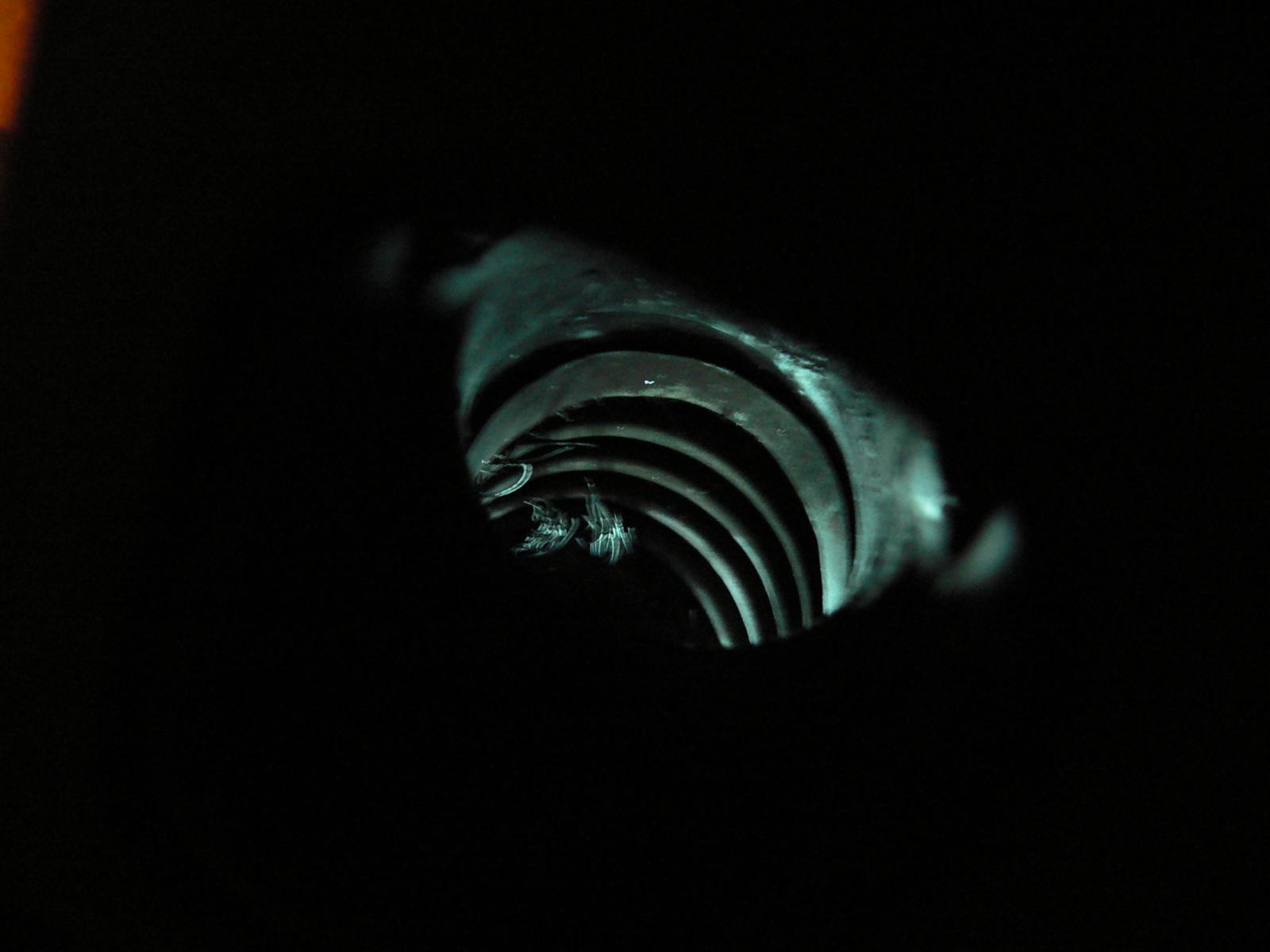

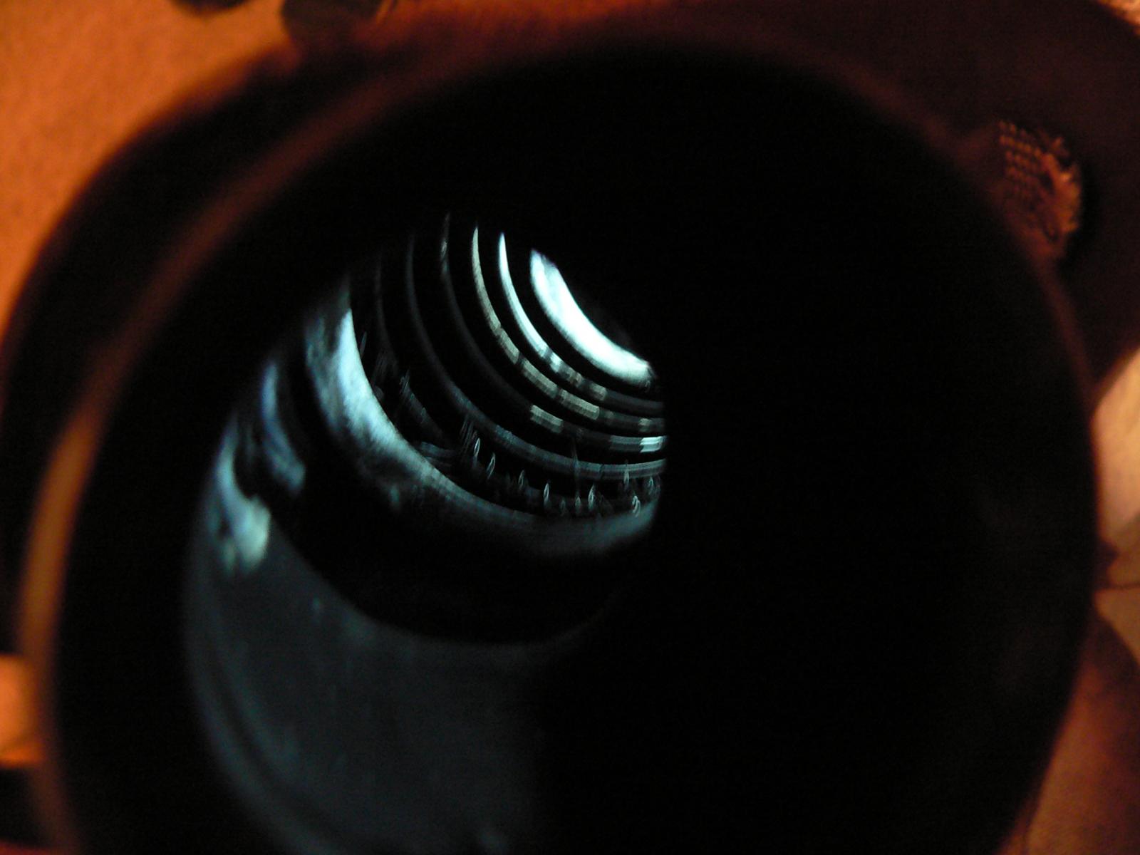

Mach 5 Posted November 18, 2010 Report Posted November 18, 2010 I seriously dont remember all I can tell you is that the inside of the flex is missing I will put up a pic Quote
mfewtrail Posted November 19, 2010 Report Posted November 19, 2010 FWIW, Jeff M. used to use flexes on his x-overs that had an inner locking style liner inside instead of the braided style. You can see some pictures of the inner locking liner type here: http://www.verociousmotorsports.com/Shop-by-Category/Flex-Couplings/Vibrant-Performance-Stainless-Steel-Flexible-Coupling ^I have no clue about the quality of those flexes, I just came across the pictures showing the different style liners. Quote
