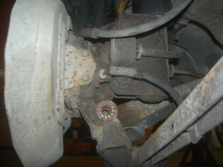

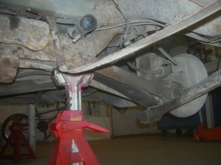

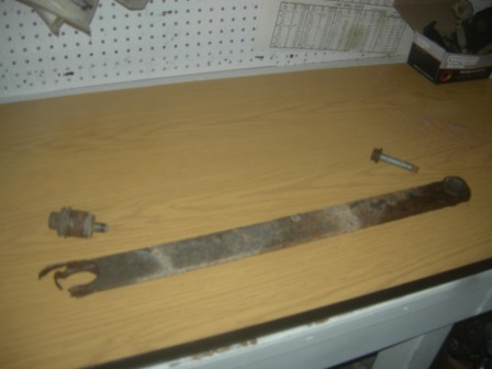

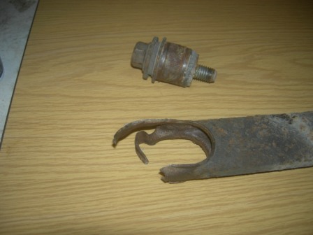

jongrappin Posted November 9, 2010 Report Posted November 9, 2010 I recently ran over a pile of huge rocks going over 60mph. the result of this is that the the rear suspension on the passanger side I damaged the front arm. where the front arm connect the the knuckle the bar ripped.... So i need to replace the front arm. Questions? is this possible to replace without dropping the gas tank?? if so how? also anything i should know about this, i was gonna that this part off of a donor car (95 GP SE) would this work? also i was thinking how much of a pain that maybe. should i replace this part new? what else should be done in there. my big concerns are if the gas tank is actually in the way of removing the bolt. also is this under pressure? is there a need for special tools. I good with most things mechanical i just have replace one of these before.. and lol yes i can attached pictures tomorrow. Quote
CSI_MuNkY Posted November 9, 2010 Report Posted November 9, 2010 Lets see if I can get all your questions here, lol Yes you can do it without dropping the gas tank, but you have to drop the rear sub frame instead. How much gas is in the tank? I have done this both ways, dropping the tank is easier. How broken is broken? if its snapped in half, chances are you don't have to worry about any tension being left in it. Unless you are going to buy an aftermarket piece you will be hard pressed to find these new. You didn't say what your car is, but odds are any lateral link (that's what it is called) off a 1st gen w-body will work. If you want to go aftermarket, visit the How to Lower a W-body thread and there should be a link to west shore fabricators (held motor sports) and BMR, both companies make lateral links for our cars. Can you post any pics of the broken parts? Quote

jongrappin Posted November 10, 2010 Author Report Posted November 10, 2010 X2 X3. I decided to go the route of dropping the gas tank and replacing just the lateral bar, most likely from the junk yard, i will get this tomorrow. I still have this second TGP to fix, i am dropping that off at the frame shop tomorrow to get an estimate. either i will fix that one, or pull the engine and drop it in a donor car, or possible part out or sell as a whole. (run-on-sentence noticed) I will post some pictures within the next few hours Quote

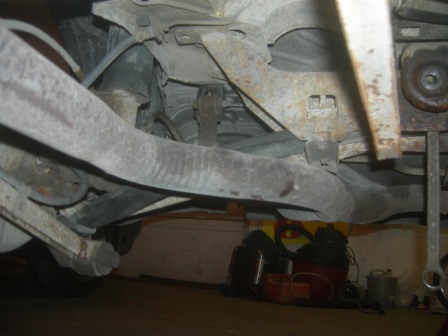

jongrappin Posted November 15, 2010 Author Report Posted November 15, 2010 Dropped the gas tank and replaced the lateral link bar, that took only 3 hours surprisingly. today was fun, I decided to drop the front sub frame, suspension, engine and transmission, with success, everything is now out of the car. i will now replace the oil pan,some gaskets and most likely the whole subframe and suspension components. I am in need of 1 3/4 x 3 inch flex section for the crossover repair. can anyone help me with this? pictures are after I fixed the rear suspension. i will and some pictures of the other work soon. Quote
