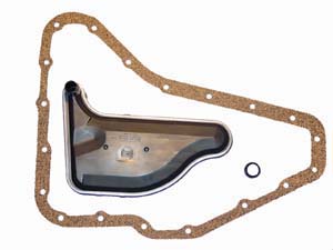

virtuetovice Posted November 5, 2010 Author Report Posted November 5, 2010 The fluid level is perfect. This is the filter that was in it: http://compare.ebay.com/like/110383177226?ltyp=AllFixedPriceItemTypes&var=sbar&rvr_id=163299888043&crlp=1_263602_304662&UA=WXF%3F&GUID=542ca56912b0a0b452726942ffef5e6d&itemid=110383177226&ff4=263602_304662 This is the filter that the zone for auto parts sold me: That round hump on the bottom was in the way of the trans pan...could not put it in. Quote
Dark Ride Posted November 5, 2010 Report Posted November 5, 2010 The only filter I've ever seen is the one that autozone sold you. Have you checked fluid since you filled it after dropping the pan? Shifting through all gears before checking it? Quote
Crazy K Posted November 5, 2010 Report Posted November 5, 2010 GET FILTER FROM SOMEPLACE ELSE. and repeat the transmission service. Quote
mfewtrail Posted November 5, 2010 Report Posted November 5, 2010 The picture of the filter you posted looks like a typical aftermarket 4T60-E filter. The older 4T60's should have a slightly different shaped aftermarket filter IIRC. Make sure to look at the computer the next time you're at the parts store and confirm that they enter the correct year. Quote

virtuetovice Posted November 6, 2010 Author Report Posted November 6, 2010 Well I kinda figured they sold me the wrong trans filter, I just didn't know if the symptoms could be a sign of tranny death. Maybe I'll try finding a proper trans filter and go ahead and try that before I put my HUD in. I've read bits and pieces about running Seafoam TransTune through the transmission for about 100 or so miles and then doing the filter/fluid change. Any thoughts on that? I just don't wanna do something and fuck it up. Quote

virtuetovice Posted November 6, 2010 Author Report Posted November 6, 2010 Well, after stopping at 3 different auto parts stores, a Napa about 15 miles away had the right one. I'm gonna skip the Trans Tune and just change the fluid/filter again after I'm done messing with the HUD. That'll give it plenty of time to cool off and what not. Quote
