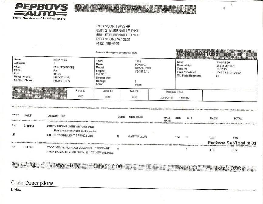

WhatTheFehl Posted November 2, 2010 Report Posted November 2, 2010 Pepboys read my codes for free. They bitched about it because it was a '95, but they were still able to do it. Quote

WhatTheFehl Posted November 3, 2010 Report Posted November 3, 2010 I checked every auto place around me and they all told me that since its a 94 the scan tool they have won't work so o was wondering of I could do it myself using a jumper wire...I have done it on a 91 Honda before but don't know if the cutty was the same way...I have a feeling its the Egr valve because I'm getting horrible gas mileage and my idol is a lil low...but I wanna make sure before I dish out 200 for a new one...OS there a way to test the Egr while in the car? Ahem... see previous statement about when the light comes on. If it is coming on for the EGR, it will come on usually at 45 MPH or more, around when the car is in overdrive. Your car doesn't have OBD1 like your Honda did, therefore the paperclip trick will not work. Your car also does not have OBD2 like 96 or newer cars did. In 1994 and 1995, GM created a mutated step child called OBD1.5. OBD1.5 has a similar computer setup, and the same trouble codes as OBD1, but a connector more like an OBD2 connector. Thus, you and I have a predicament. Both of our cars have the fucktarded OBD1.5. My solution was taking it to PepBoys, where they scanned it for free. Your only other solution would be to buy your own scanner or ALDL cable. http://www.w-body.com/showthread.php/47108-Check-Engine-Light-Trouble-Code-for-EGR-Help-inside! Source: EGR is my arch nemesis. Quote

Bostons94Vert Posted November 3, 2010 Author Report Posted November 3, 2010 That is exactly when the light comes on so it would definitely be the Egr? And there isn't a pep boys close but ill definitely find one just to make sure...I appreciate the insight on the proamblem...ill post when I find out for sure Quote
WhatTheFehl Posted November 3, 2010 Report Posted November 3, 2010 Yep, and just so you know, your EGR most likely hasn't failed. Follow the link I gave you to fix the actual problem. Quote
