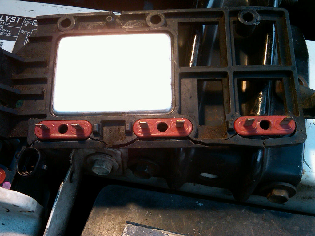

94vertluvr Posted November 3, 2010 Author Report Posted November 3, 2010 Thanks and thanks to Al...I will be visiting my local 'treasure yard' today in search of a replacement ICM. I feel like this is probably the problem the more I think about it...there are times like this morning that it acts like it is not getting spark and I've replaced all the other spark related things so process of elimination I guess...but you can bet all those parts I took off that didn't fix it will go right back on my garage shelf for future use!!! Will report when I get it installed. Quote
Brian P Posted November 3, 2010 Report Posted November 3, 2010 Good luck, keep us posted. Â When ICM's fail, they create many different kinds of symptoms. Go grab one from a 3100/3400 from the mid '90s- mid '00's as already mentioned. Quote
94vertluvr Posted November 3, 2010 Author Report Posted November 3, 2010 Well...I changed out the ICM today; I have to say it is improved as far as response goes BUT it is still hesitating and backfiring...popping noises coming out from under the hood sounds like from the drivers side. From 2k - 3k rpms and mainly from 2nd to 3rd gear as you are accelerating it has what feels like a lull in power and if you continue trying to push it for more you will hear the pop corn sounds which is I'm guessing the backfiring. Â As you can see from the pic of the old ICM it needed replaced...found a nice one at a junkyard what looked like from a 3400 or something because it was clean and the bolts had no corrosion on them at all. Since I've replace all the electrical/spark related items I'm moving on to fuel system. I borrowed from a friend a fuel pump pressure tester. What is the chance that these symptoms could be related to poor valve timing? Does anyone thing these symptoms sound like that in a 3.4 DOHC? Quote
