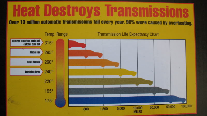

Dark Ride Posted October 31, 2010 Author Report Posted October 31, 2010 Well, the cooler was free to me. I'm thinking now of maybe mounting it behind the radiator, maybe modifying the fan mounts a little, that way if the fans kick on they will cool the tranny cooler as well. What is the ideal temperature for a transmission? Quote
Night Fury Posted November 1, 2010 Report Posted November 1, 2010 I was in the 260 range in my 2005 GP GTP last summer going to California.... No good. Quote
Dark Ride Posted November 1, 2010 Author Report Posted November 1, 2010 what are the consequences of it running cooler than that, I'm slightly concerned that the cooler I have may be a little too big and if I run it solo without the radiator cooler that it might get too cool. I only plan on running this car during the summer. Is this a valid concern, or does the 4T65-e produce enough heat that overcooling wouldn't be a problem? I'm thinking that if I can figure out a way to mount it behind the radiator, right behind the fans that it would be optimum. Quote
Night Fury Posted November 1, 2010 Report Posted November 1, 2010 They are as hot as menopausal witches. Only downsides to running too cool is seals and shit might loose some flexibility, and the TCC not locking up. Not sure what the threshold is for the TCC though Quote
