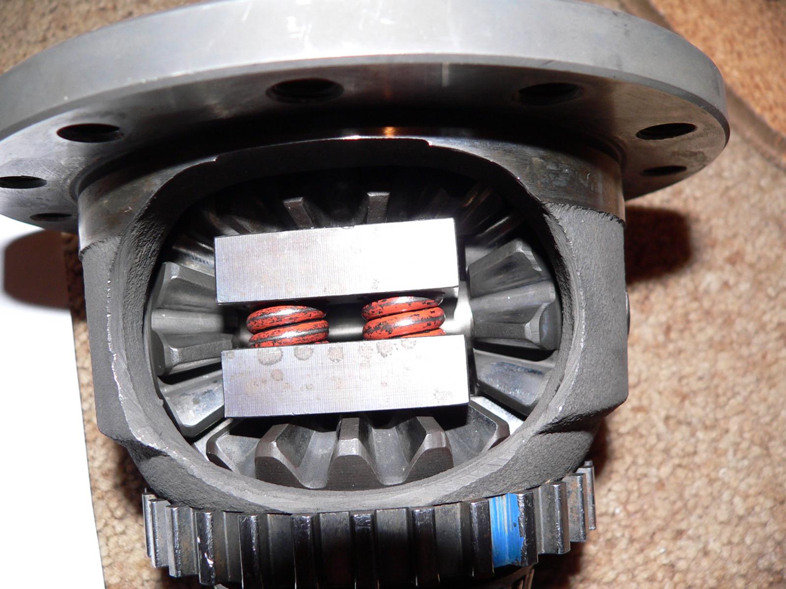

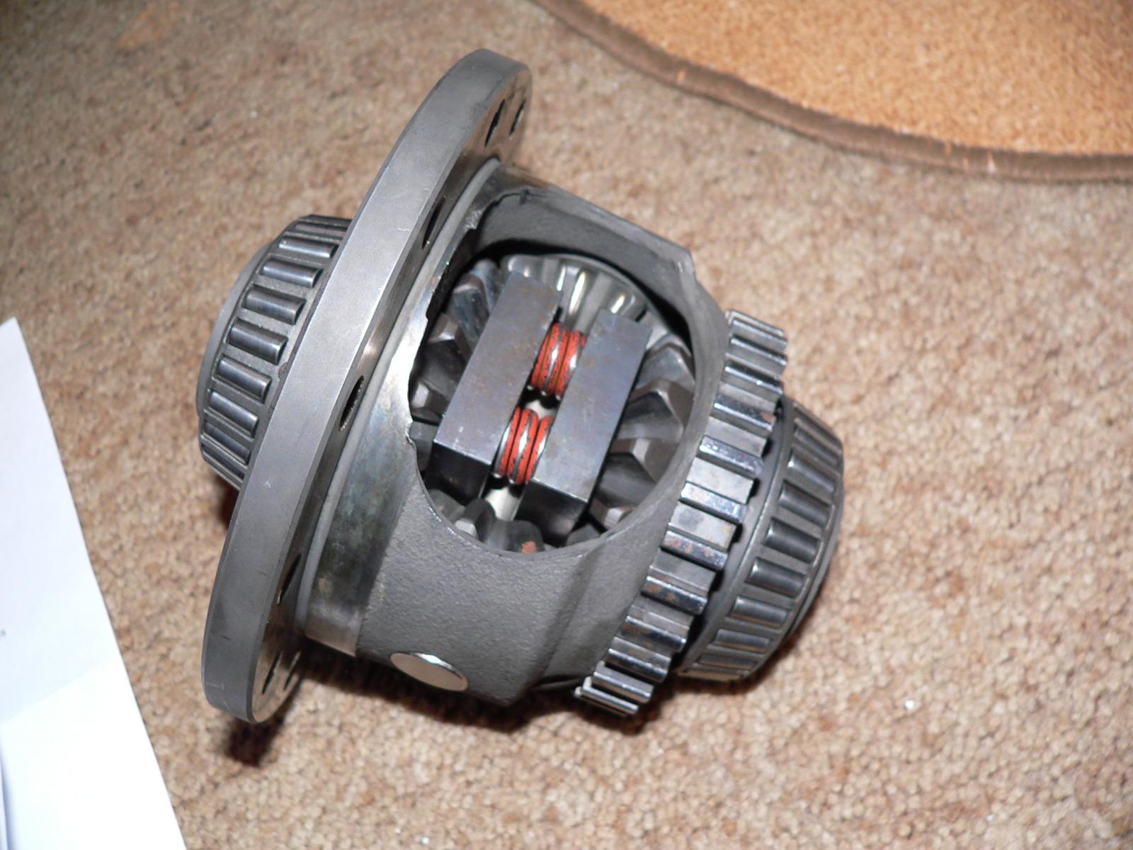

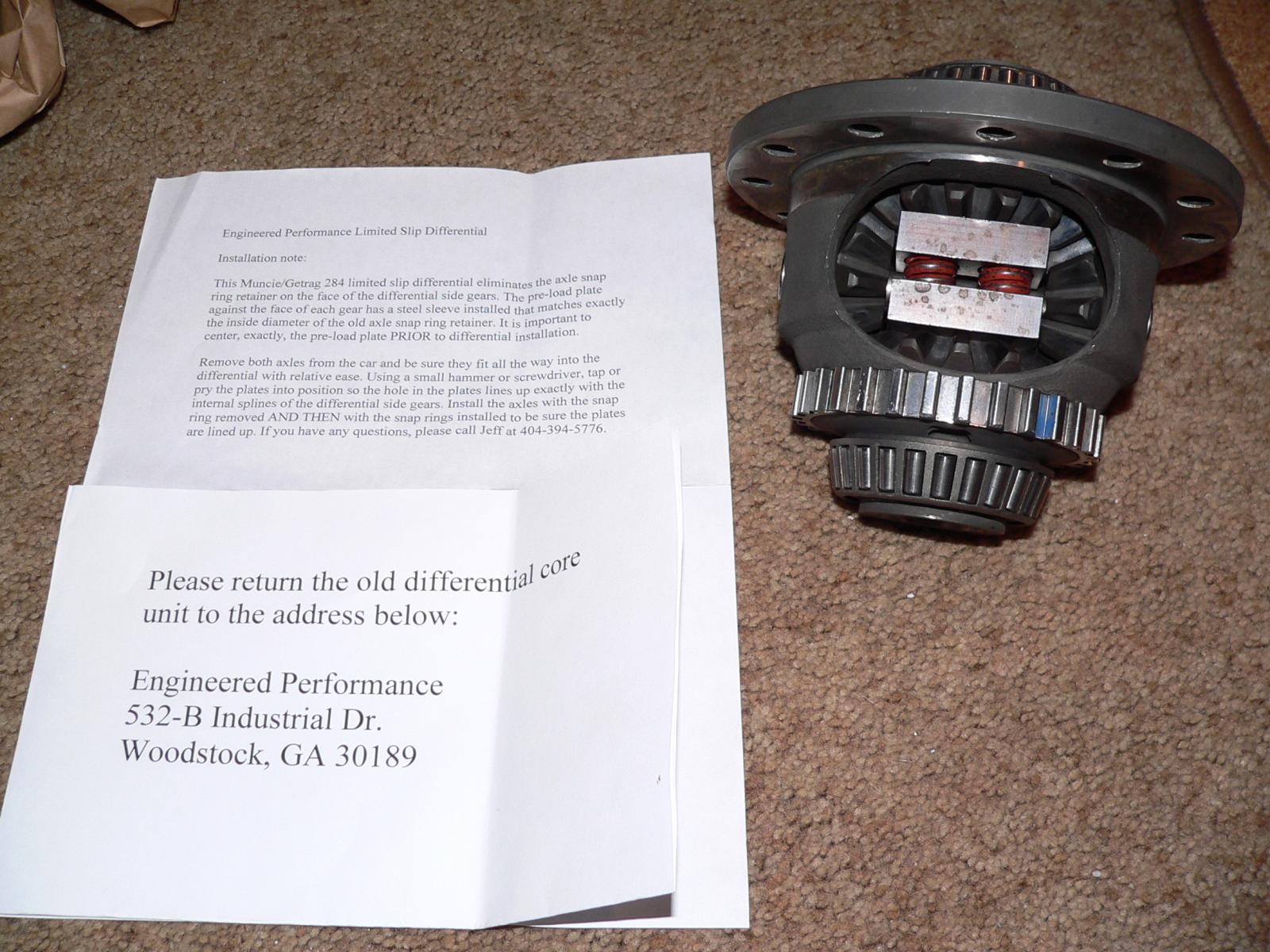

Mach 5 Posted November 27, 2010 Author Report Posted November 27, 2010 LSD CAME TODAY!!! I will more pics of the install later Quote
Garrett Powered Posted November 27, 2010 Report Posted November 27, 2010 those springs look like they couldn't get much stouter. Quote
