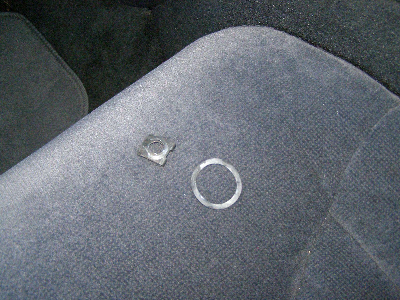

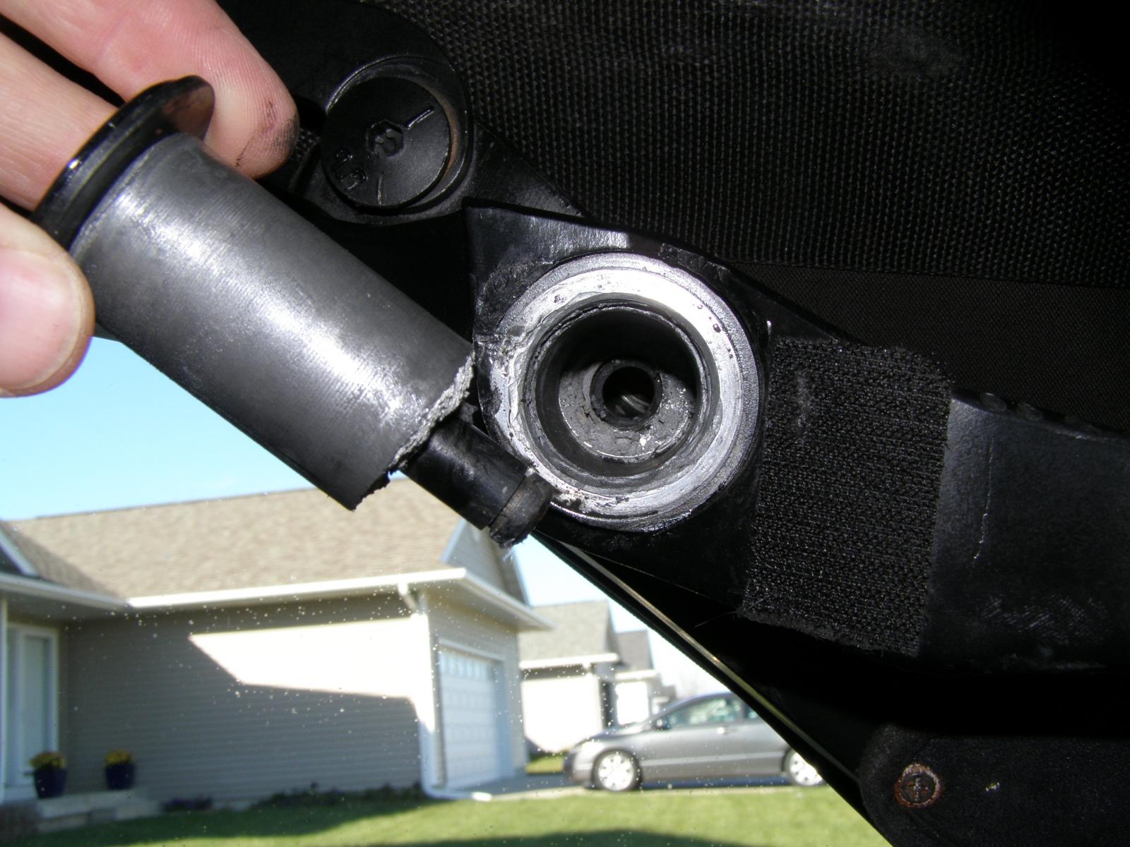

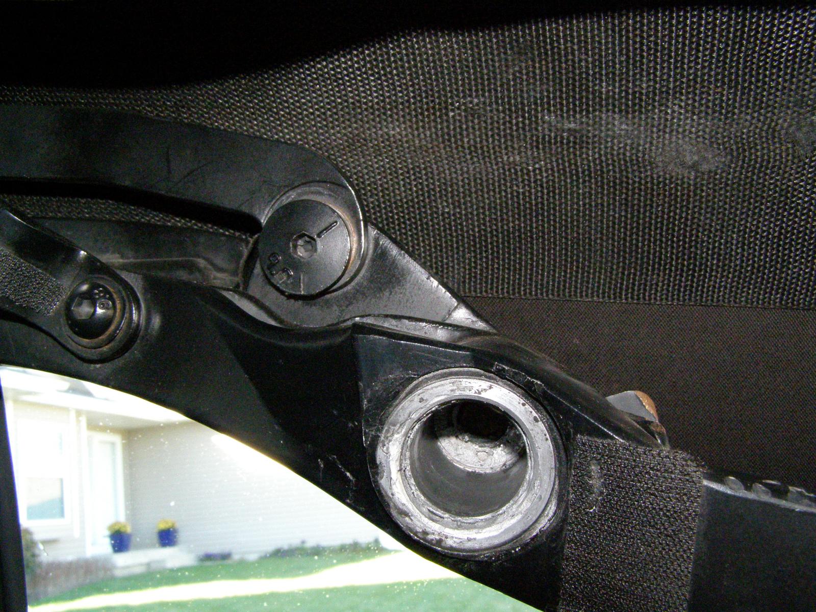

Uh, oh. drove the car around a little bit today for the last time this year. Went to put the top up... and heard a "pop" from the passenger side of the top. Guess I have something to fix over the winter.
Looks like a 1 1.4" diameter (guesstimate) aluminum cast or pot-metal bushing of some sort. Appears to be one of the largest connecting pieces - snapped off. Pictures show what I'm talking about (assuming I attached them correctly.
So... I suspect I'm not the only one with this problem. What parts do I need? Are they available new, or do I need to beg people to get them out of junkyards for me? Can I do the work myself, or is this a nightmare to repair?

Wow that sure doesn't look very friendly! I doubt you'd be able to come across the piece new (most vert. specific parts aren't available from the dealership), unless you have one custom made. Where are you located? There's a vert in a junk yard in Flint MI, should have the piece you need! If the weather was a bit nicer I'd go take a look at it, but it looks to be freezing for the rest of the year... :-(
Good luck with it though! At least it's put away for the winter and you don't have to worry about it being an urgent problem!
