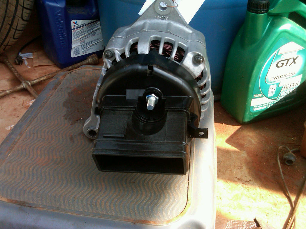

94vertluvr Posted October 13, 2010 Author Report Posted October 13, 2010 Thanks Ken, How could I have grounded this out? By the way i connected it to the nut with part of the copper touching the alternator? I just looked at a pic I took of the back of it before I installed it and it looks like to me it has a plastic housing around that nut that is part of the alternator cooling; could it touching that plastic housing ground it? Quote

Crazy K Posted October 13, 2010 Report Posted October 13, 2010 Thanks Ken, How could I have grounded this out? By the way i connected it to the nut with part of the copper touching the alternator? I just looked at a pic I took of the back of it before I installed it and it looks like to me it has a plastic housing around that nut that is part of the alternator cooling; could it touching that plastic housing ground it?[ATTACH=CONFIG]2275[/ATTACH] Â No, I'm thinking the wire got pinched or pierced between the alternator and a bracket or something... the same trick it easy to do on a 3.1mpfi if you have the wire at a wrong angle, the wire would touch and get intruded to become grounded to a square corner on the lower intake..... God knows I've done that 2 or 3 times... Quote
