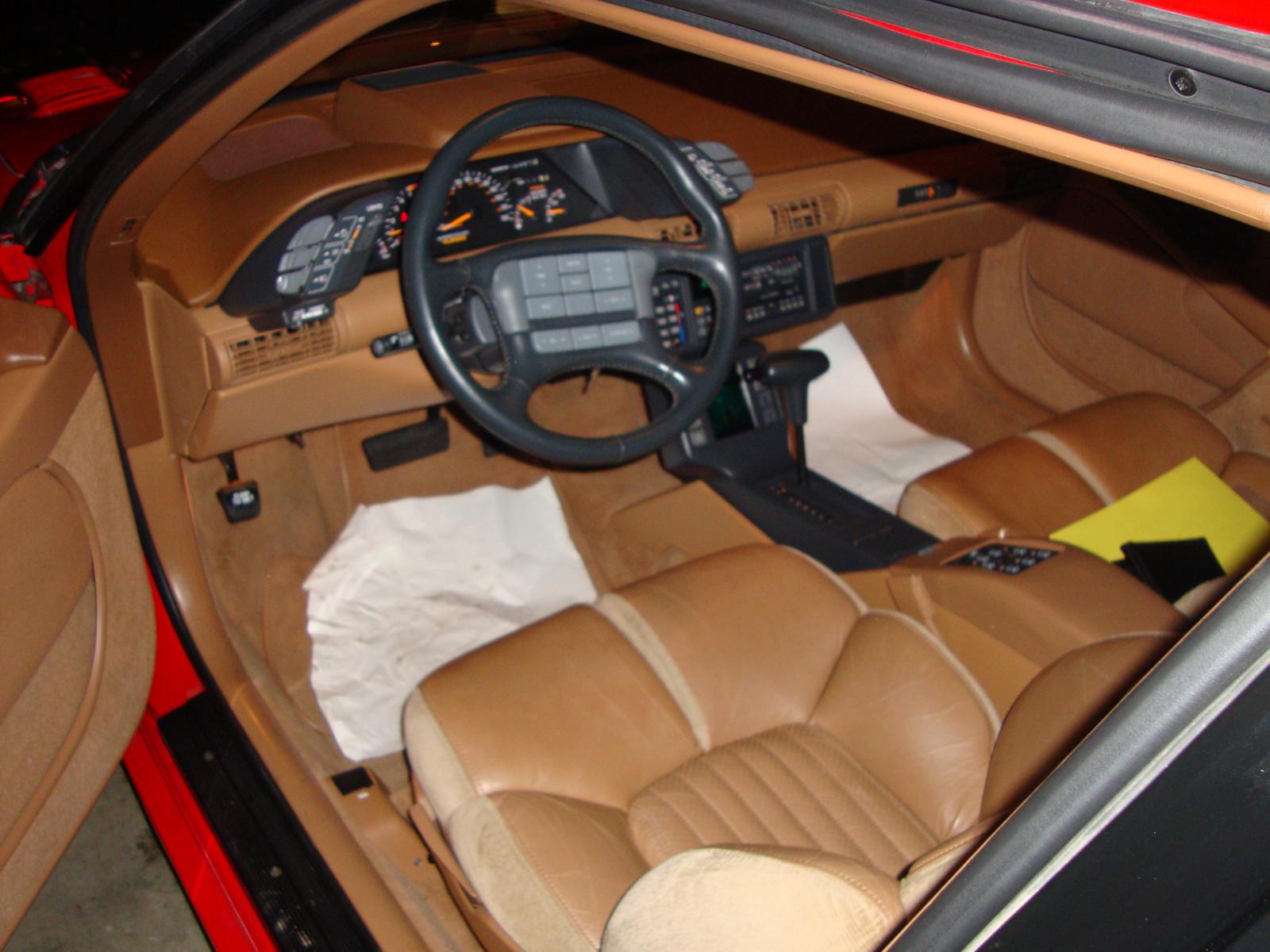

Johnnystats Posted October 6, 2010 Author Report Posted October 6, 2010 OK, I started her up in the garage - pressed the brake pedal 3x - ABS motor/pump kicked on. Once it went off, I hit it 3x again, ABS motor kicked on. That ABS motor is loud when the windows are up/radio is off. Here is one pic I was able to take - more to follow soon Quote
