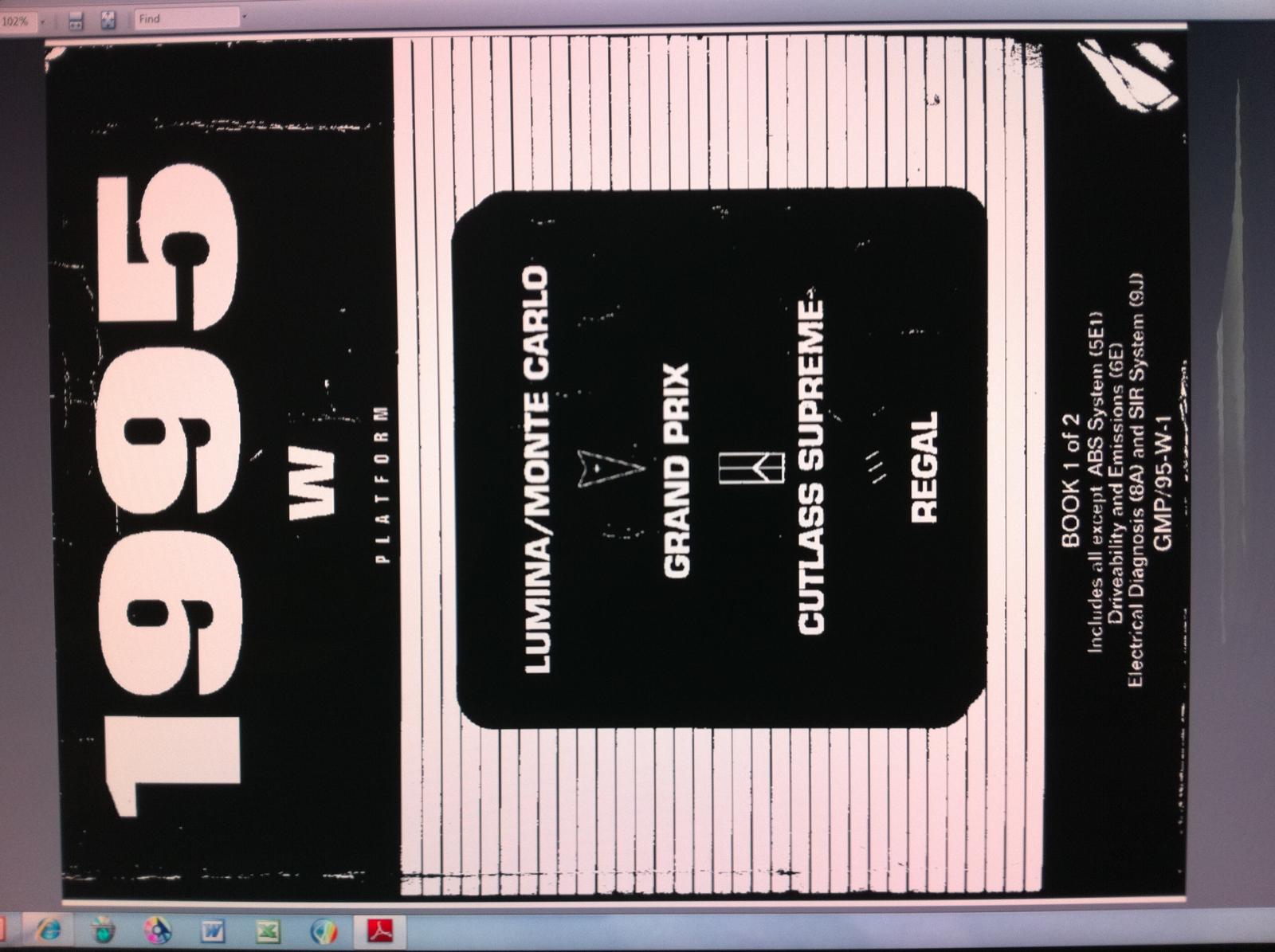

MemphisMan Posted September 24, 2010 Report Posted September 24, 2010 The one I have is 28 pages, but it could be pages from the one you've got. Here is a pic of the cover page taken with my iphone. Does this match the one you've got? Quote
Galaxie500XL Posted September 25, 2010 Author Report Posted September 25, 2010 Memphis Man; Yep, that's the one I found, too. Thanks! Quote
