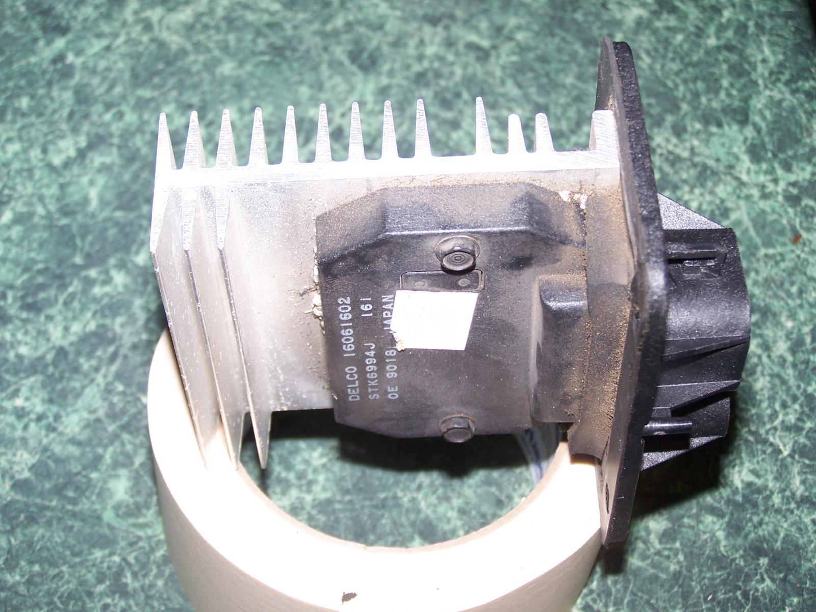

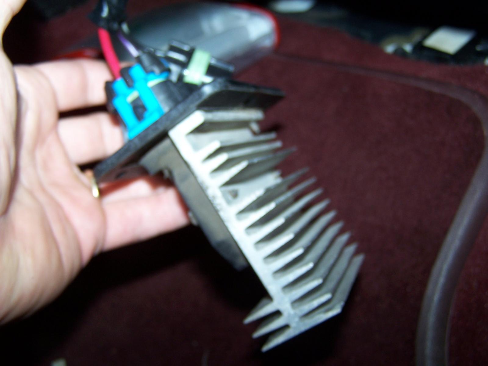

bender01 Posted September 19, 2010 Author Report Posted September 19, 2010 Is this what your talking about? Quote

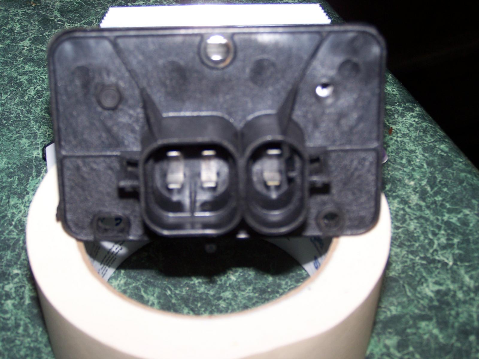

Crazy K Posted September 19, 2010 Report Posted September 19, 2010 YEAP!!!! IIRC there is more than one version... I need to have the part number from that one, as well as the exact configuration of the plugs.... sharper pics would help... Quote
bender01 Posted September 20, 2010 Author Report Posted September 20, 2010 Here you go. DELCO 16061602 stk6994j 161 OE 9018 JAPAN Thanks alot. For all your help. Ben Quote
bender01 Posted September 22, 2010 Author Report Posted September 22, 2010 (edited) Well GM will sell me one for $200. The auto recyclers are not helping either. A u pull salvage in Ga said the have a bunch of Luminas and firebirds and one 93 supreme that uses that same module.Does anyone recognize this part so I dont waste time pulling the wrong one. I found this but it has four pins, mine is six. http://www.google.com/products?q=GM+blower+motor+module+1991+oldsmobile&hl=en&aq=f Edited September 22, 2010 by bender01 Quote

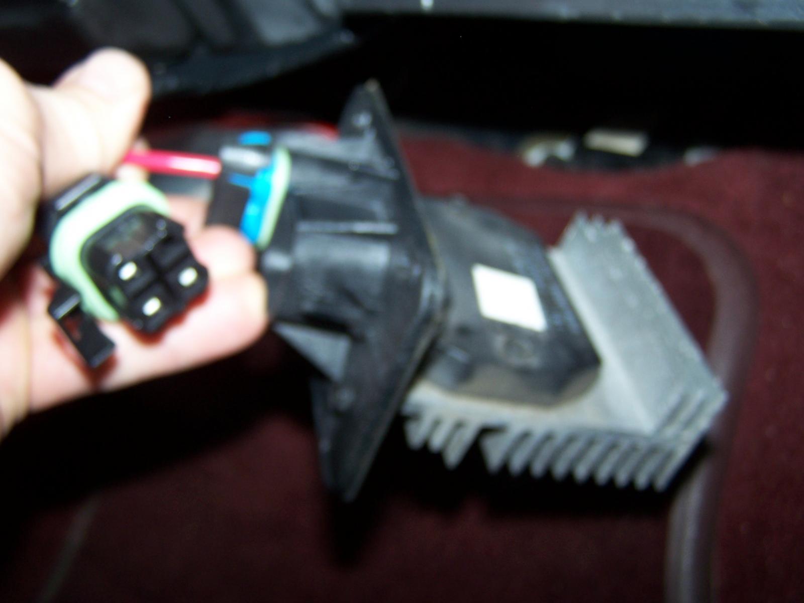

Crazy K Posted September 25, 2010 Report Posted September 25, 2010 i found two of them tonight... let me check against what you've posted tommorrow. Quote
bender01 Posted September 25, 2010 Author Report Posted September 25, 2010 Thanks all. I did find a comment from Amazon reviews about the 3 and 1 pin working in a 4 and 2 pin. Its in the reviews of this part im going to paste. Thanks for all your help. I do plan to go to this cash and carry site wed. to see a 93 supreme. I doubt its a vert and those nice parts would be long gone from the southern sun. A friend is looking for some Sentra parts too. Any odd ball southern specific items that are small ill check for you. Ill post theyre site as well! You could call them? http://www.amazon.com/ACDelco-15-71971-Blower-Control-Module/dp/B000C9DGZ0 http://www.iluvused.com/index.html Savannah GA is where Im headed. Crazy K. Id like to buy your part if you have it. I dont know what Ill find in GA. I might get 3 for 10$..?? If I do Ill test them and wait for the next guy like me here! Ben Quote
bender01 Posted September 29, 2010 Author Report Posted September 29, 2010 Got a 3 and 1 pin from a 94 Buick Riv. Everything is working fine! It had been replaced in the Buick as only one screw was holding it in. Quote
