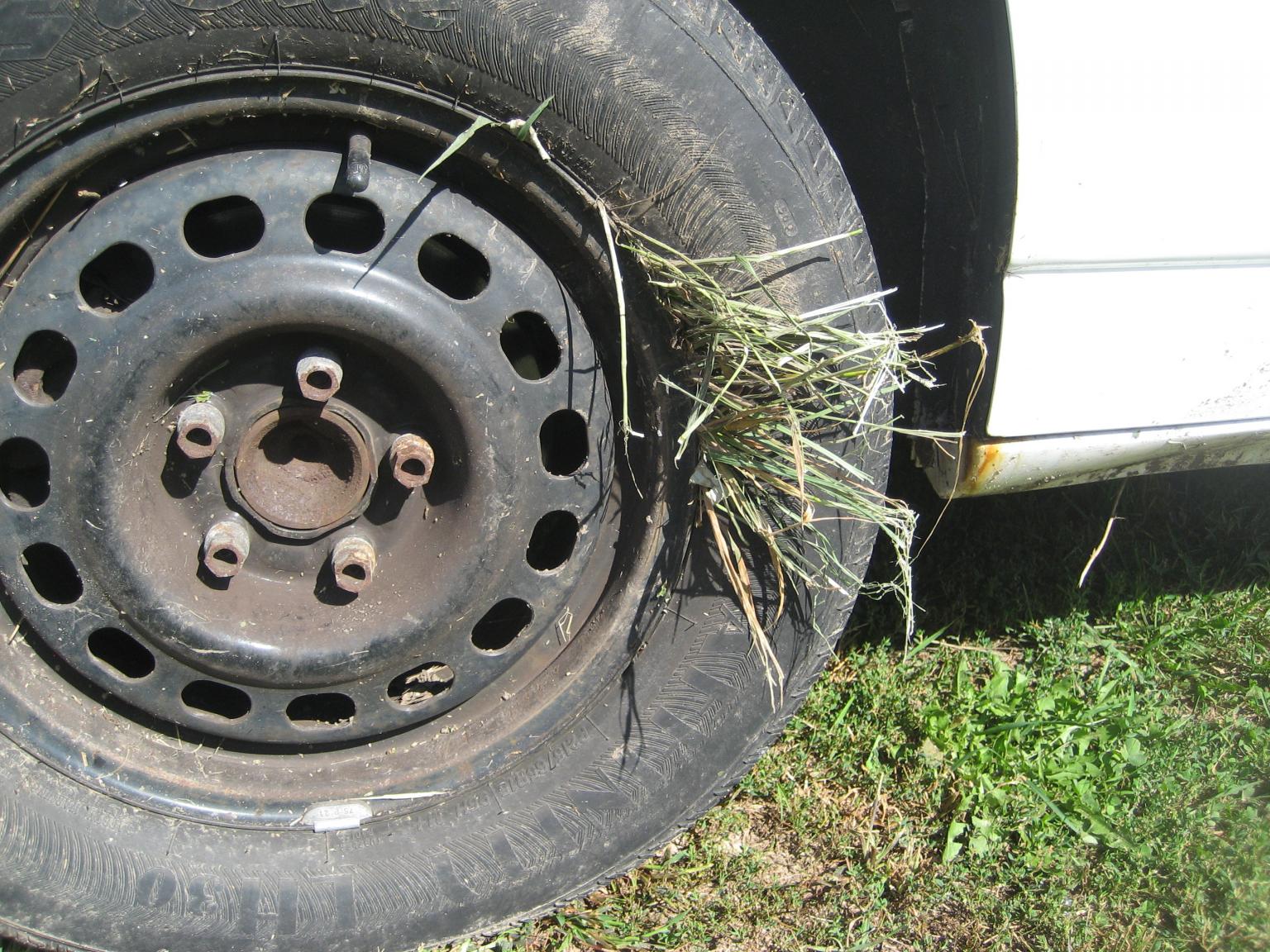

Luminator9c3 Posted September 15, 2010 Report Posted September 15, 2010 Yep, that's right. My first w-body was purchased in late July and this past friday night it ended up going into a ditch and hitting a tree. Guys, I've driven a lot of really fast cars before. This is the first car I've ever owned that wasn't RWD and V8, and this is the first car I've ever crashed. I guess I just can't handle the brute power of a stock L36. I was driving on a country road which was a detour, since my regular route was closed for construction. This was one of the problems, since I was not familiar with the road. The road went straight for miles with nothing but cornfields around. I was going between 75-80 mph on this road, which wouldn't seem extremely fast except it was raining. Suddenly, I just saw trees in front of me and I freaked out and hit the brakes, thinking the road was dead ending. Turns out, the road hooks to the left and drops down a fairly steep decline. It was a totally blind turn from the straightaway, though. Basically, I tried to take this extremely dangerous turn at 80mph. In the rain. I managed to drift down the entire incline fishtailing back and fourth until I eventually lost control, spun the car around, and went off the road. Since I managed to spin the car sideways, I hit the tree with the side of the car and not the front. It was also a tree that was already fallen over, so it wasn't as destructive as it could have been. Initially, I was extremely pissed off at myself for being so stupid and driving too fast in the rain. The car is low-mileage and the underside is SO CLEAN. However, all things considered, I guess I'm really lucky. I honestly thought I was going to die once I lost control. I was going so fast and all I saw around me was a telephone pole, a concrete slab, a giant cliff, and large trees. I drifted past the cliff and missed it by several feet. Seriously, there was only ONE non-lethal crash spot for like a mile stretch, and I managed to slide right into it perfectly, hitting the weakest tree in the entire forest. This incident has made be do a TON of thinking. It's made me realized how easy it really is to die in a car accident. The car still runs and drives 100% perfect and doesn't seem to have any damage to the frame or core support or anything (another thing to be thankful for). It still drives totally straight when I take my hands off the wheel. I did manage to damage almost every body panel, but it's all replaceable stuff. I need both fenders, both side mirrors, a hood, a bumper, 4 doors, a windshield, and a passenger side rear window. This may seem like a lot, but I think I can do it for free. I wanna buy a Lumina shell/roller type thing for cheap, swap all the body pieces over, and then part out what's left of the donor car to make (hopefully) my money back. As I said, I'm frustrated that my lack of judgement busted up such a nice car, but it could have been much worse, both for the car and myself. I was wearing my seatbelt and I was not injured. There is ONE troublesome issue that I'm dealing with after the accident, though. My brake lights are stuck on! I'm wondering if maybe a sensor is stuck since I obviously put some serious force into the brake pedal when this happened. I looked around the brake pedal briefly and didn't notice any sensor. Can someone lend me some advice here? Right now I have to pull the fuse when I park the car so it doesn't drain the battery. With all that said... now it's time to look forward to fixing the body, painting it, and top-swapping it Quote

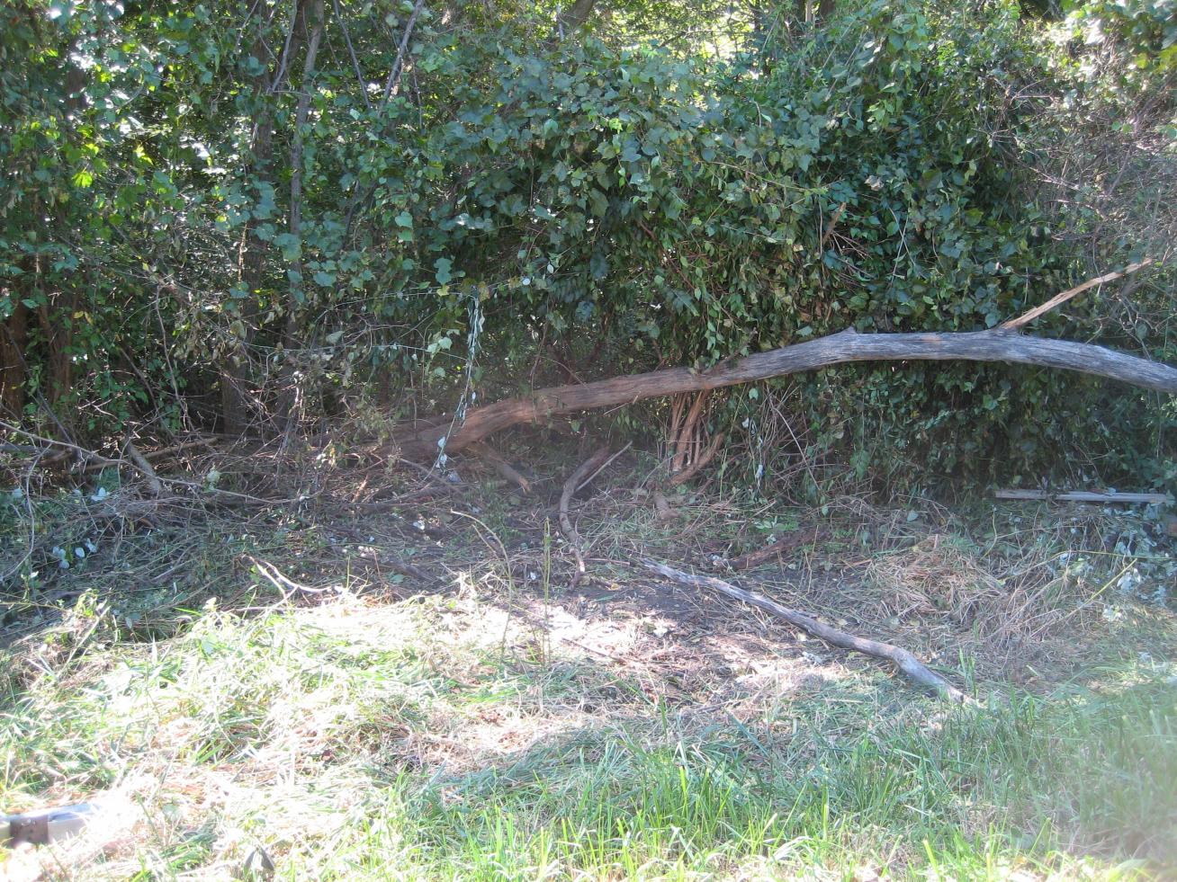

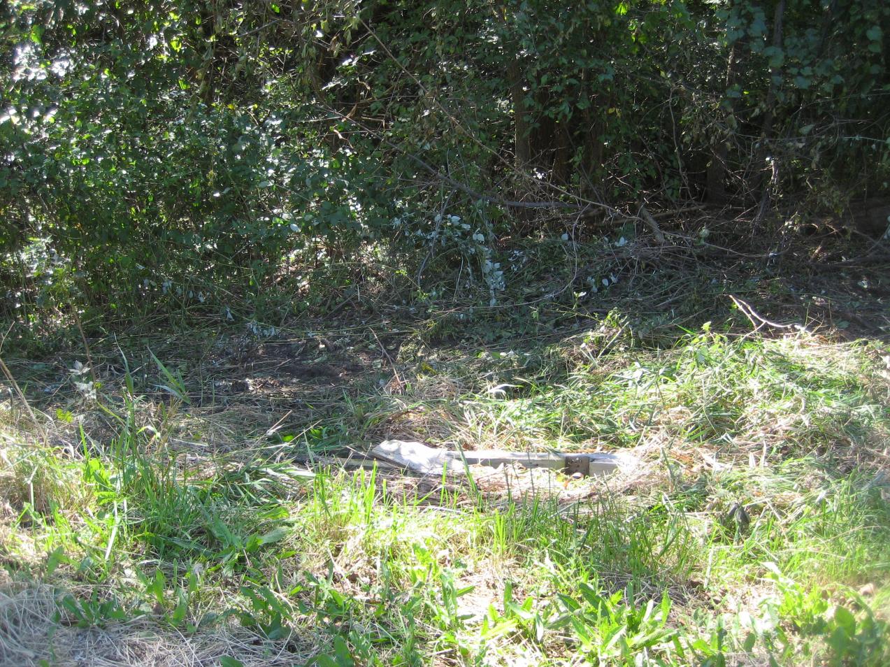

Luminator9c3 Posted September 15, 2010 Author Report Posted September 15, 2010 And here is a crappy pic of the concrete slab and deep ravine that I narrowly missed: Quote
